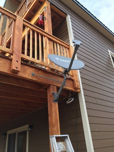

This is a photo of my installation. I still need to tidy up the cables.

You could do a bit better on 99 and 103 but the mid 80's are fine.
If an installer put this in, they should have had a Directv AIM meter.
If they didn't it's likely not aligned correctly.
