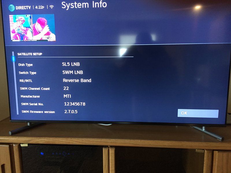

I just got home today. Here is the info page on the satellite setup. Does the reverse band make a difference?
Not right now it doesn't for the 4k, but it will later down the line.
