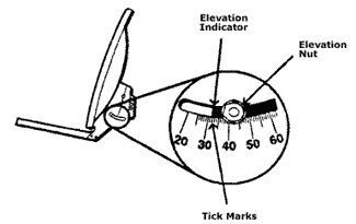

Also make sure your elevation setting is lined up on the actual "elevation indicator" as illustrated.
Not what you estimate is the geometric center of the elevation nut.
