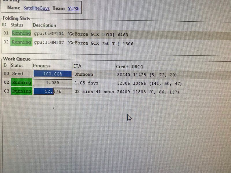

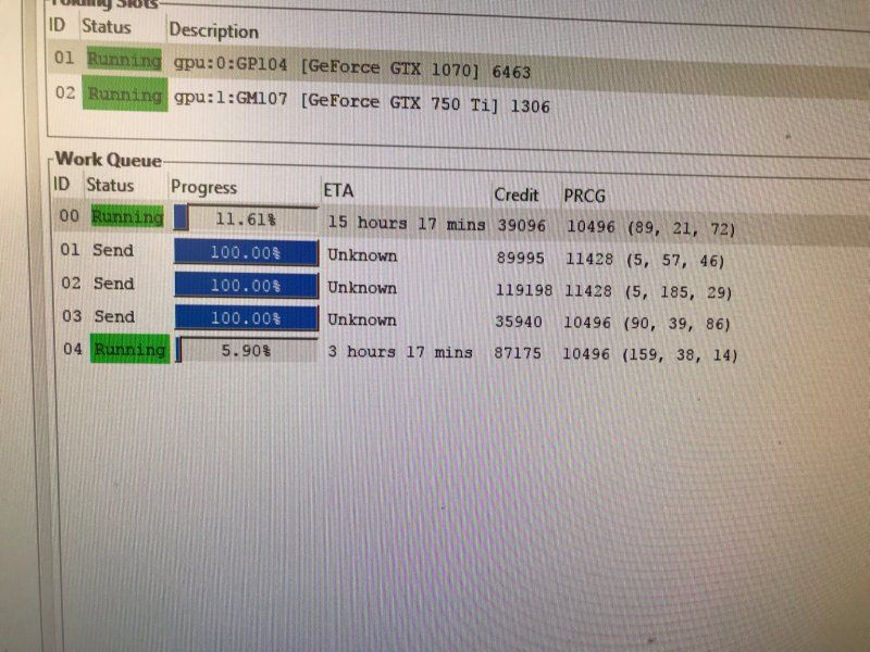

Ahh I think I know what the issue is, we put in a new firewall and it blocks everything going out... however since I am one of the admins I can open ports on it for my desktop.
Now I need to find what ports it needs opened.
All it should require is Ports 80 and 8080.

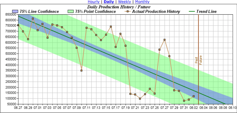

Scott, did your Folding rig crap out again?

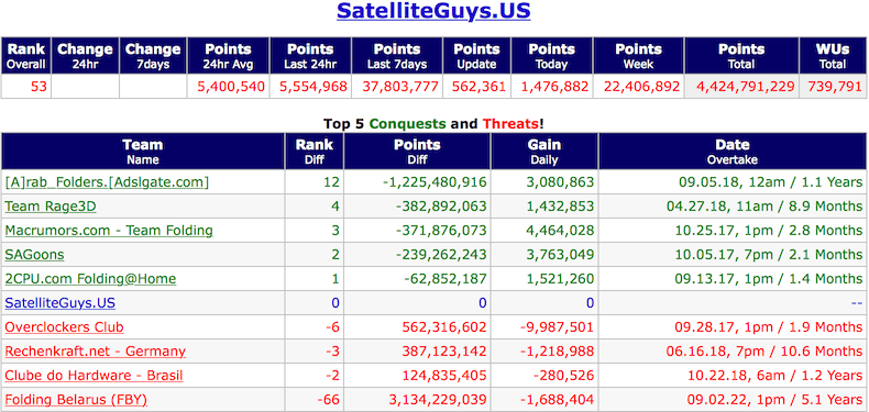

The whole Team seems to be in the Summer Doldrums. As a result, we've got some competition gaining on us:
Sure, 10 months is a long way off, and we should move into the Folding Top 50 before dropping out a month later unless we can get SatGuys Team Members Folding again. We're down to 15 active Folders (Scorpion.sting , harshness, Psikic, and Samy60 were last seen back in June). Is it high summer temperatures? Renewed interest in Bitcoin and other cryptocurrencies? Hopefully, we can get back to at least 20 Active Folders running on all cylinders!
Nope, my company put in a new firewall which uses "snort"
Snort is blocking outgoing packets and they are being blocked for "(http_inspect) BARE BYTE UNICODE ENCODING"
I have been working with the Bosses Son who put this new firewall in to unblock it and so far we have been unsuccessful and its pissing me off to no end.
Still working on it.

Regarding your work queue, it looks like some Work servers only respond to port 8080 which is still being blocked. I thought they would alternate between ports 80 and 8080. Obviously, port 80 is open or you'd have an office revolution on your hands.
