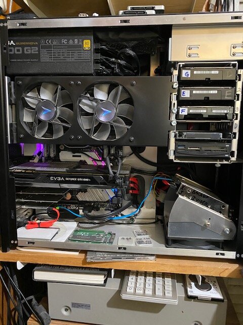

I got more bad news for win11.
Yesterday I updated my windows10 on the i9-7980 computer. I got the dreaded message that it too is not compatible with win11.
In digging through resources, I see you can get more explanation as to why this 2018 computer is unable to run windows 11.
There is an app called PC Health Check that will analyze the system hardware and let you know why it isn't able. I did this and it passes all requirements except says it is missing TPM 2.0. So I looked that up and it seems a computer must be post 2021 to have TPM 2.0 but it can be activated in certain other parts are available. Begin by turning on UEFI. I rebooted after setting this to on in the BIOS. Booted up normally but still says not compliant.
The next step scared me because I was afraid of screwing up the system. It wants me to go into Advanced settings and a menu pops up asking if I want to reset the computer to default or abort. Not really knowing what I am doing, I decided to just abort. Last thing I need is for this ridiculous process to FUBAR my expensive computer.
I am curious about this UEFI boot mode. Seems much slower than basic windows OS.
