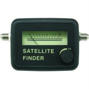

Hi guys I just moved places, I own my hopper and dish I'm trying to align my 1000.2 dish with a cheap $15 meter

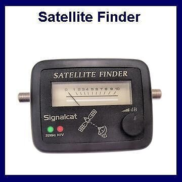

the problem I'm facing is when I connect the meter to the hopper the needle goes up and down by itself without moving the dish or meter knob, do I need a meter that has 22KHz?
I tried a new set of rg6 cables and also a buddy borrowed a another cheap meter, same thing happens once you connect the meter to the hopper (REC) the needle moves up and down by itself every 10 seconds without moving the dish.

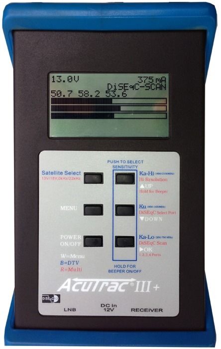

I have a Hopper in my RV and whenever I use my portable 1000.4 dish -- which is frequently -- I use an Acutrac III+ signal strength meter:
The meter costs over $200, but makes it a breeze to acquire sats because it shows the signal strength of 3 sats in real time.
