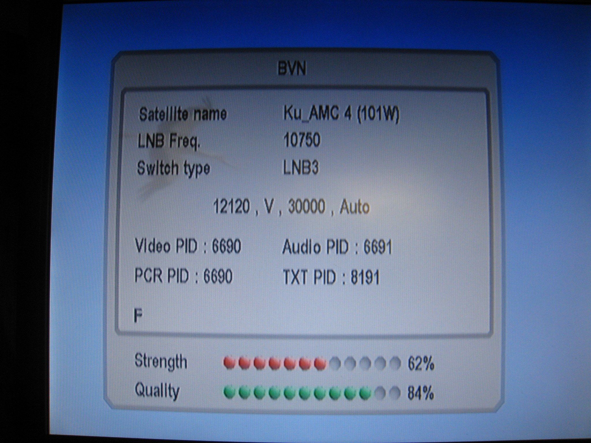

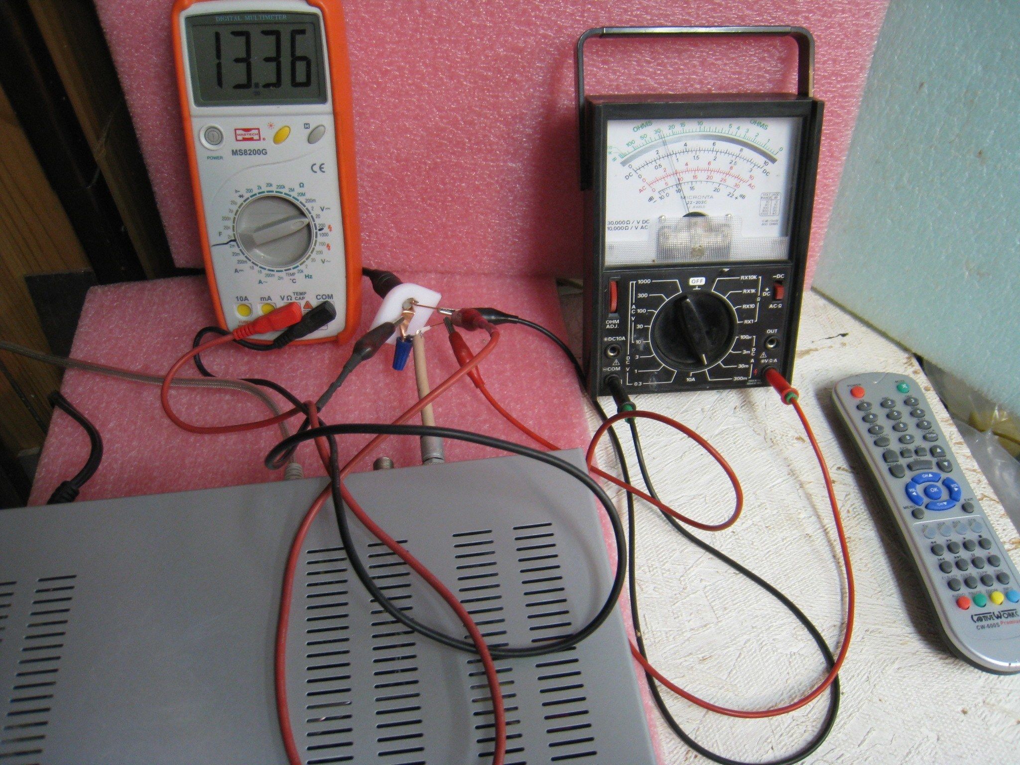

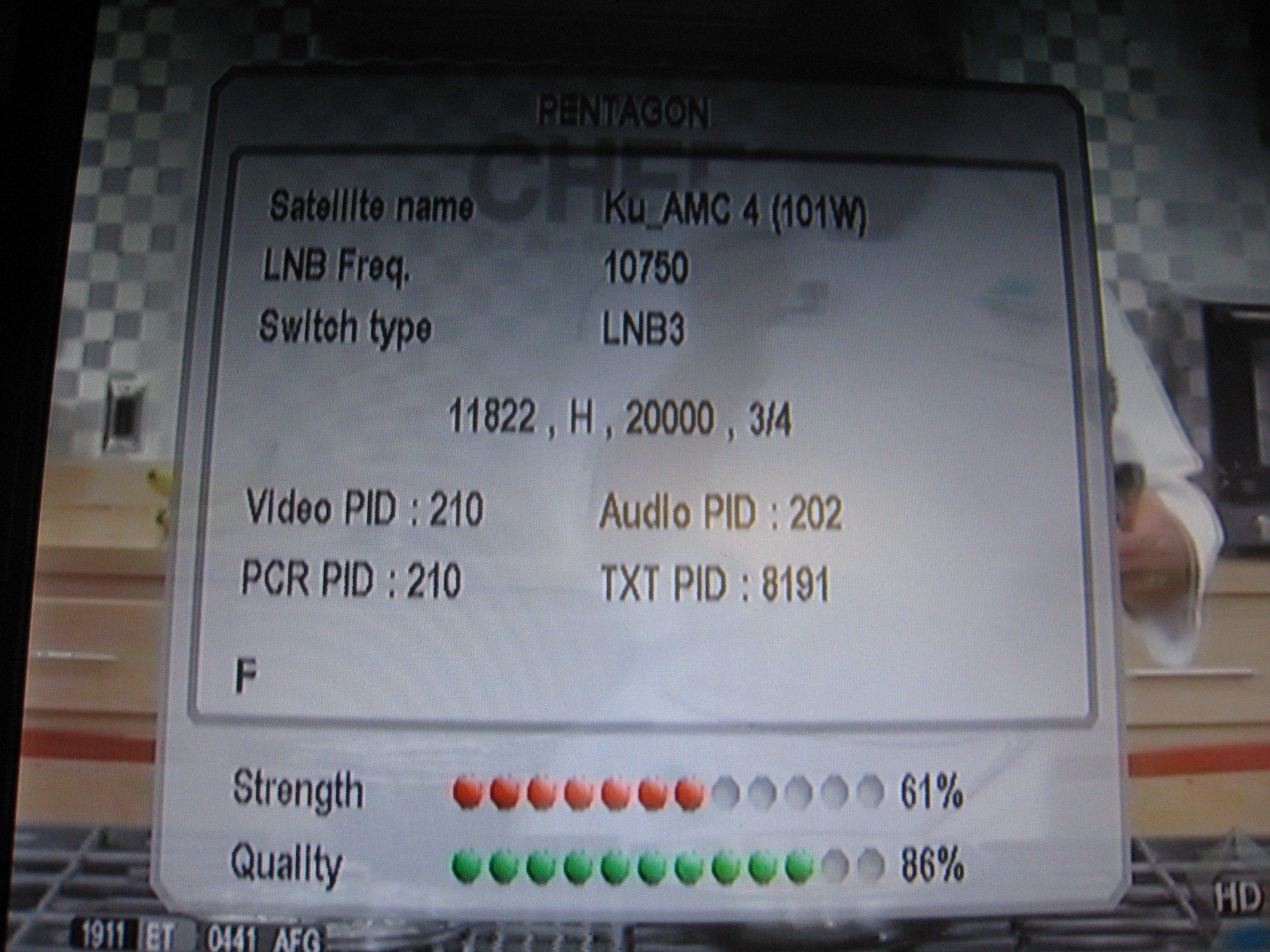

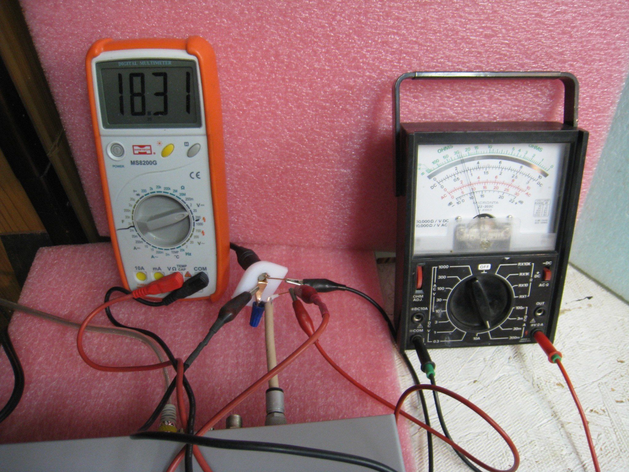

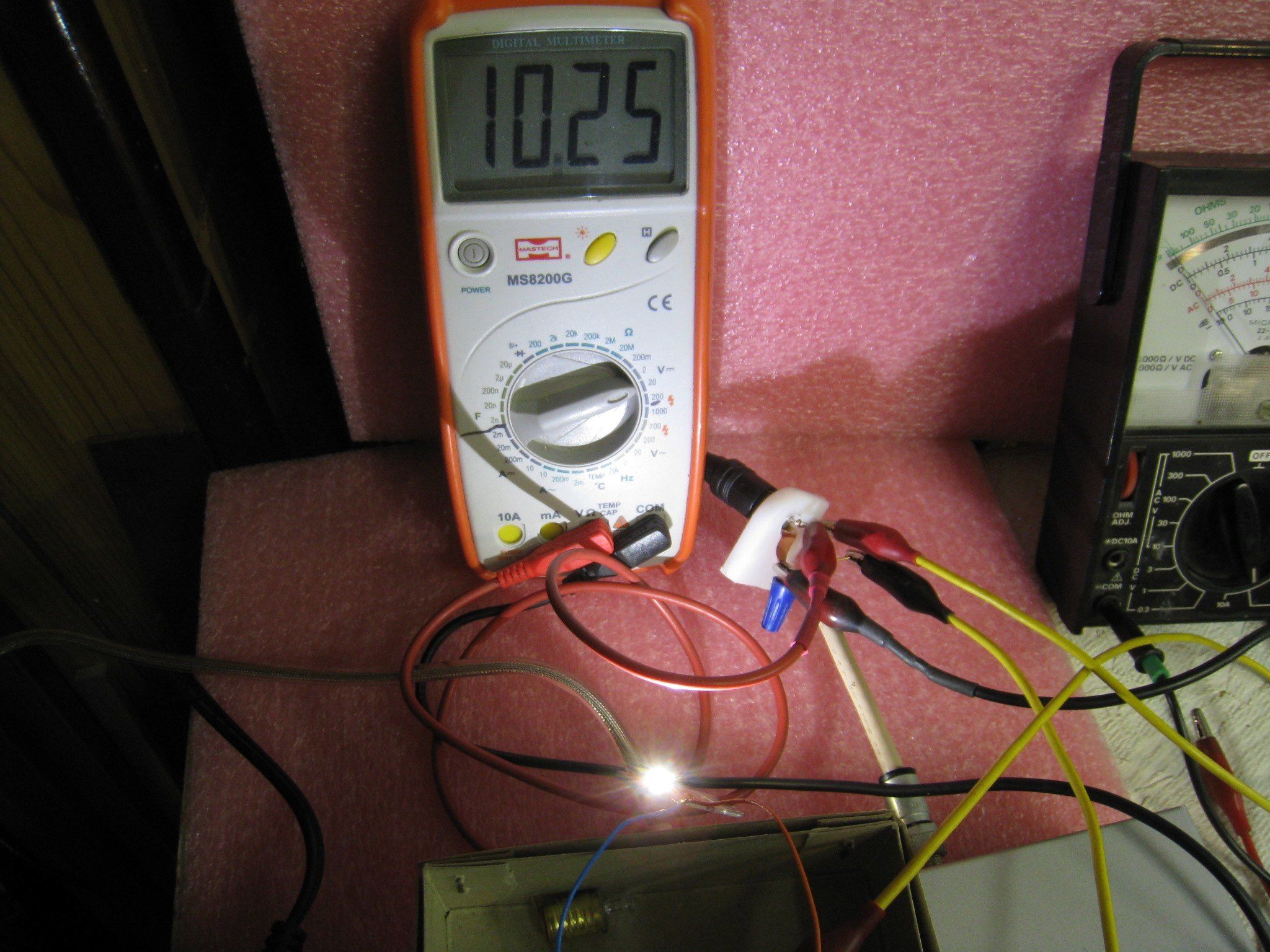

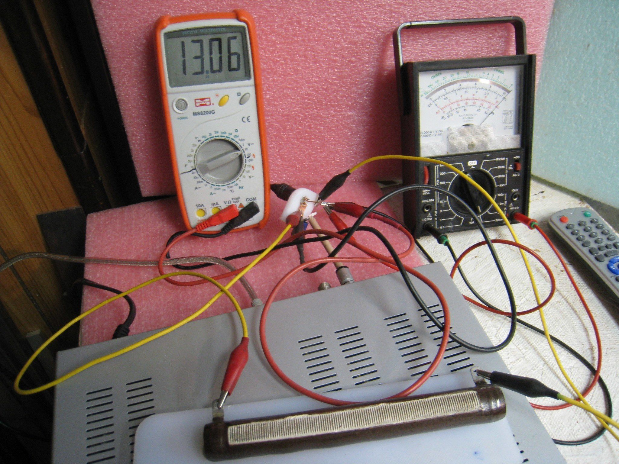

These cables from ampmeter and voltmeter did not influence the strength nor quality of reception. In this case, the LNB used only 85 mA. When I added a 50 Ohm resistor,( parallel to LNB) the voltage dropped slightly (as the current increased to 0.3 A). I tried to use small flashlight bulb in series, 2.2 V / 0.3 A, but it didn't even light... Then I tried an automotive LED diode (3 V, up to 0.1 A ) and the sat reception was still OK, despite voltage only above 10 V. Pictures follow
