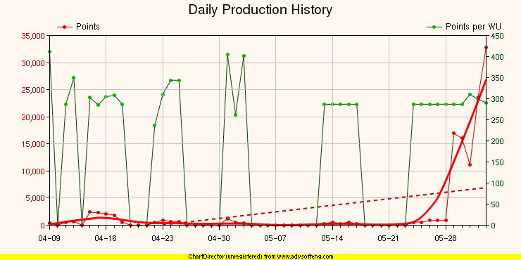

SatinKzo, the one team is part of Playstation's QA department ("where Quality is Assured...") and I bet that the units that they're putting through burn-in after repair are turned into Folding Zombies.;) The one guy in the team's #1 position has 45 or so CPUs to his name. Here's his Kakao Stats page: (http://kakaostats.com/up.php?u=920411) and I've included his point production from the last two months:
