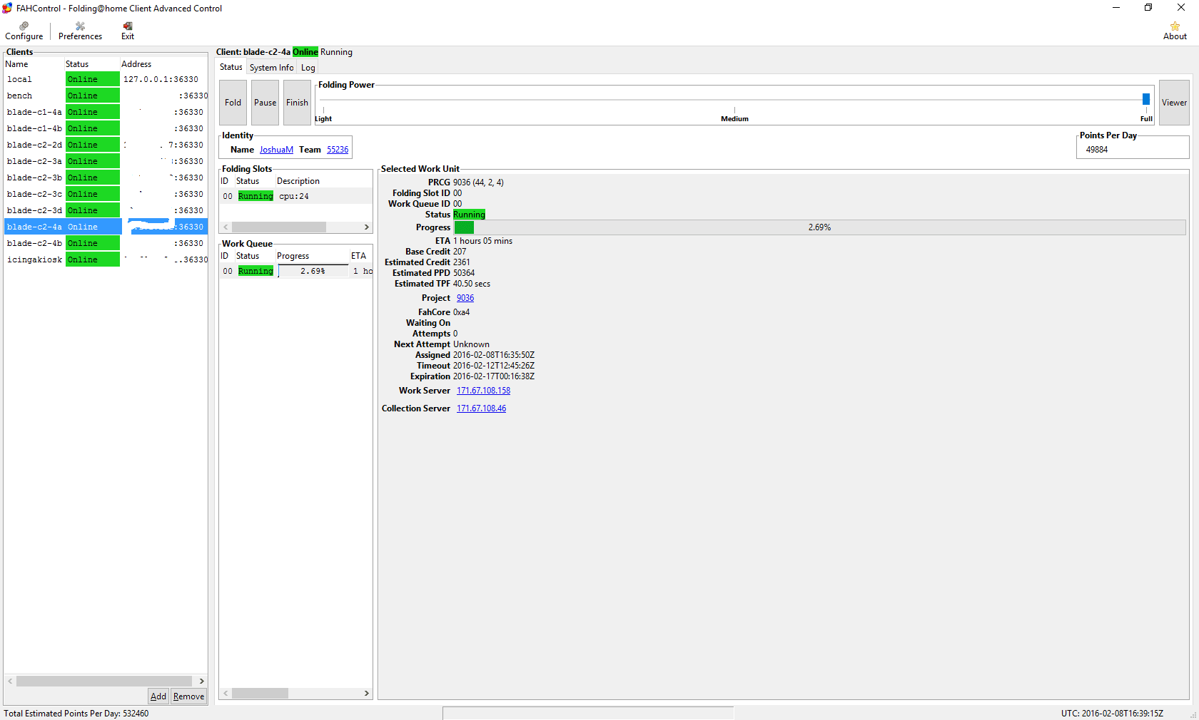

Got some more servers up, these are just my work machines and don't include my home machines.

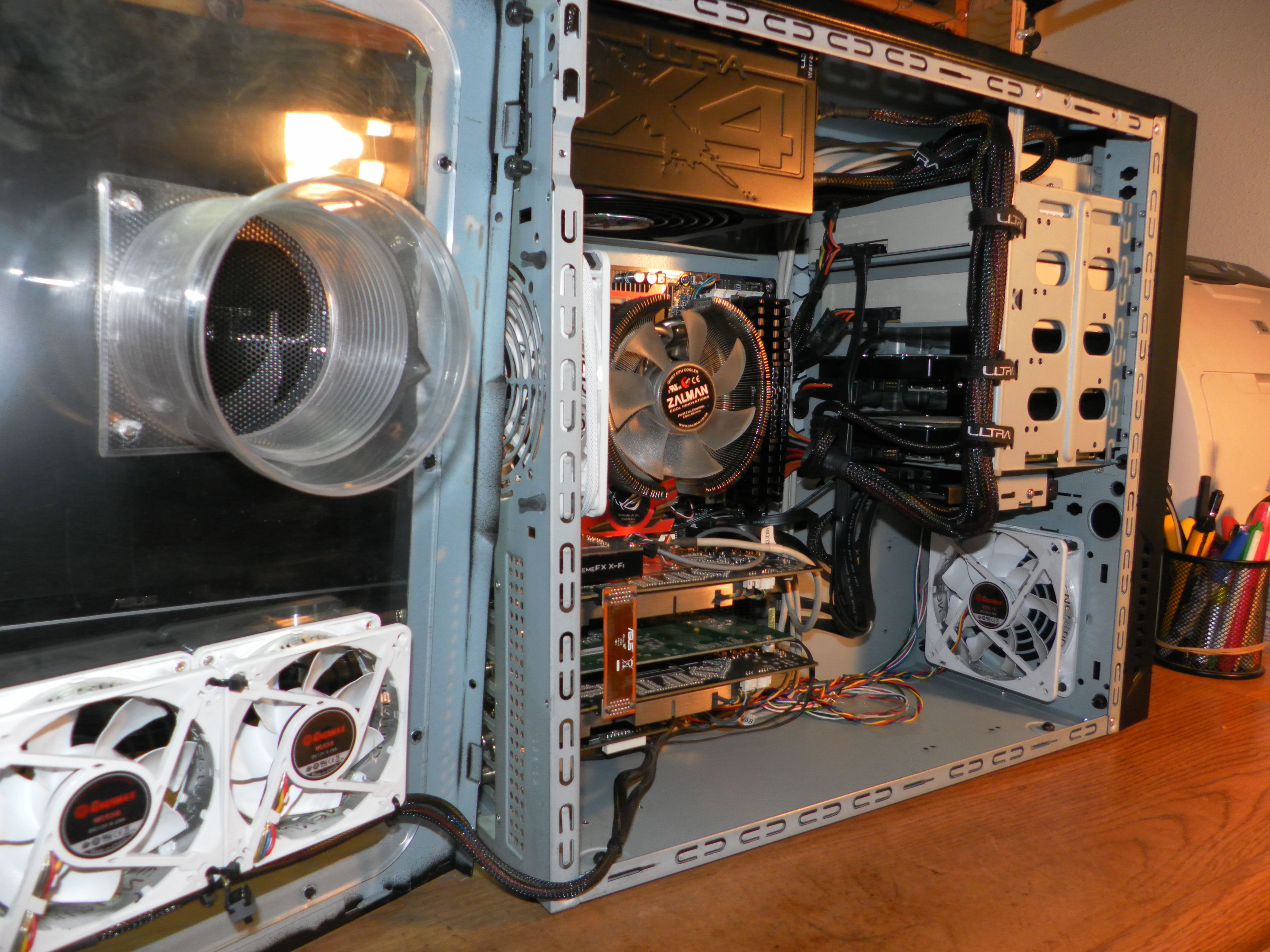

I did a quick inventory of the folding machine. It actually has plenty of room and lots of power supply (Corsair AX860) since I pulled the tuners out of it. I may have to look at the 900 series cards.
Looks like it's already running a SLI system. That power supply should easily be able to handle two 960s if you decide to really go crazy with the folding habit.
Edit: It looks like you have a very good cooling setup too.
