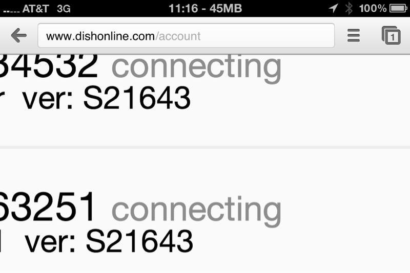

Looks like I got it on both from looking at my dish online, have to play with it tonight
Sent from my iPhone4 using SatelliteGuys
