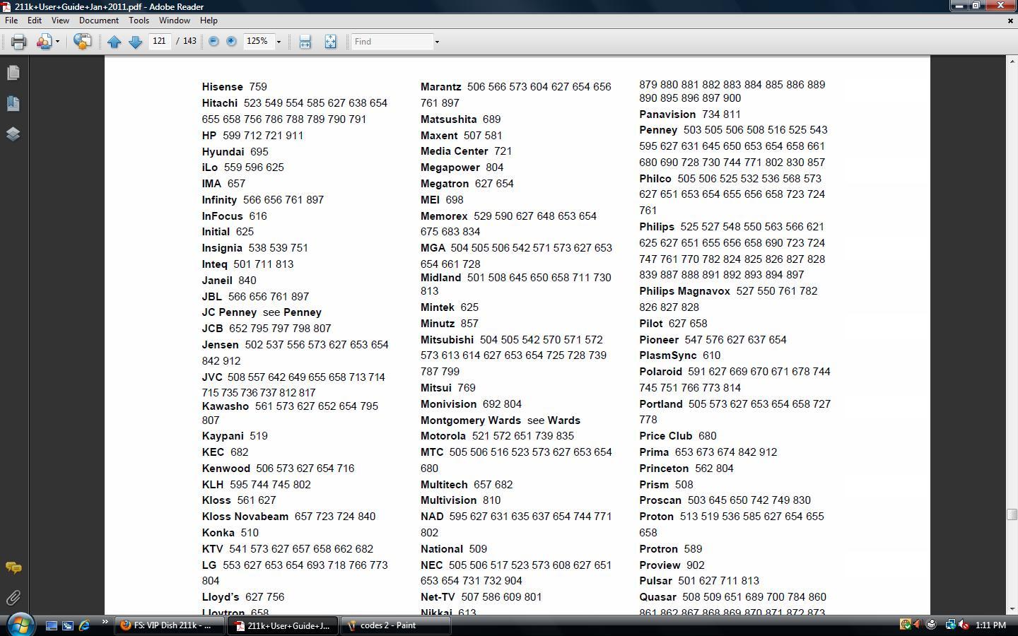

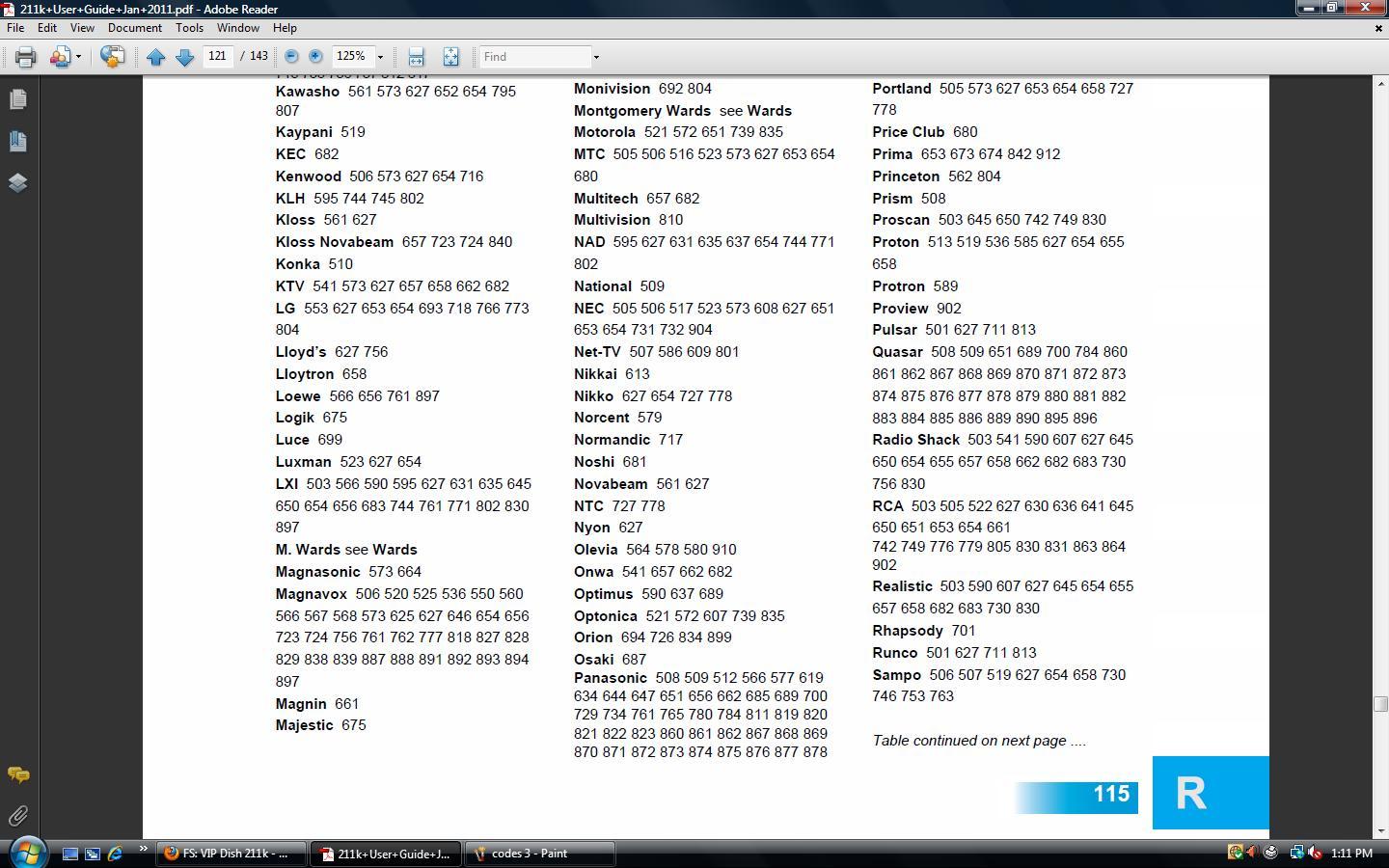

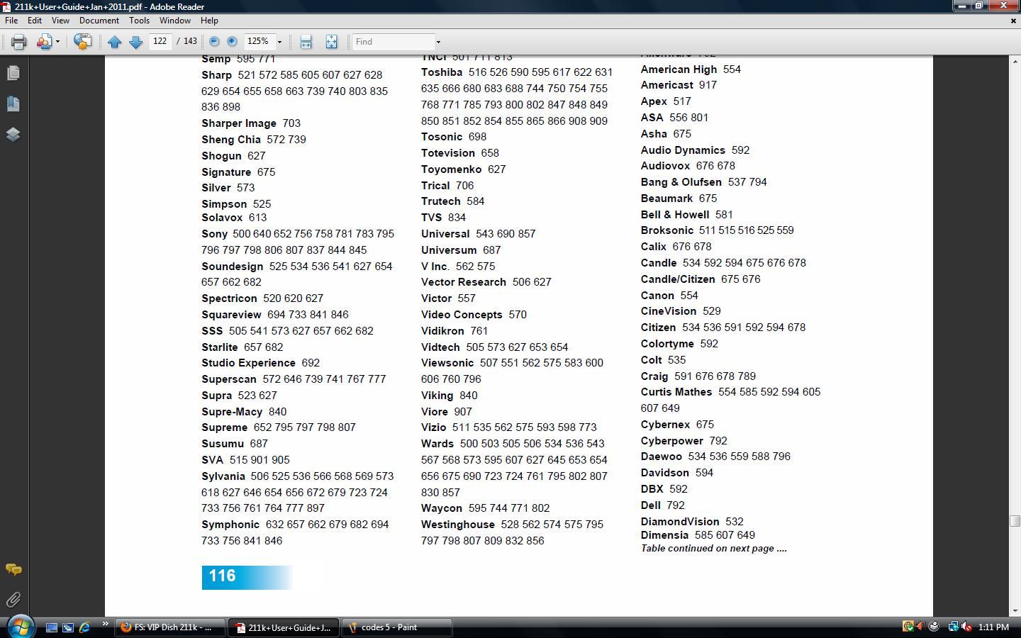

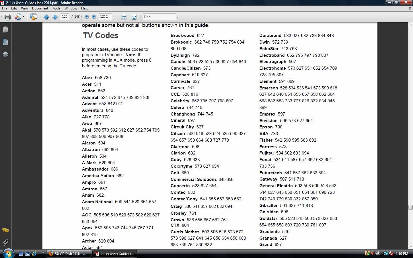

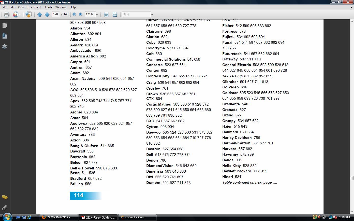

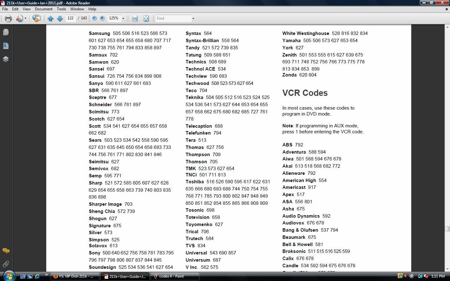

The other way is direct entry. See the screens below (taken from the dish manual which is like 60GB) ;)
Here is the link ot the pdf
http://www.mydish.com/support/filestream.ashx?ID=653
press and hold down the "TV" button (up on top next to SAT button) until all 4 lights blink
let go
type in the 3 digit code
press # (tv light blinks twice)
try remote. If doesnt work repeat above
