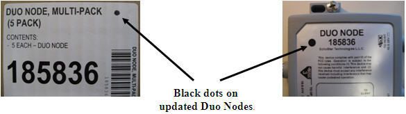

We are sorry about this issue and everyone experiencing problems related to cold weather and Duo Nodes. We have identified the problem and if you are one of the users who is still encountering these problems, please send us a PM with your first and last name, account number and 4 digit security code or last 4 digits of your SSN and we will assist in getting a technician sent out to resolve the problem.
This issue is occurring due to an problem with specific LNBs and the older model Duo Nodes that were distributed. The symptoms are listed below.
  • Signal acquisition onscreen message 015 or other signal loss related messages.
  • Failed check switch test, where the LNBF type cannot be identified and orbital locations are missing for each satellite input.
The issue may be occurring if someone has an older model node and is using one of the following LNBFs that have the following serial number prefix markings identified by the 1st 6 characters of the serial number. (see attachement)
D1000.4 WA Triple LNBF, A122A7
D1000.4 WA Triple LNBF, A72201
D1000.2 Triple LNBF, A11201,A11202,A11203
D1000.2 Triple LNBF, A71201,A71202,A71203
D1000.4 EA Triple LNBF, A71C01
If you have an older model Duo Node and are experiencing these issues, then the LNBF needs to be replaced. An updated Duo Node design is already in inventory to enable all LNBF versions to be used in cold weather conditions. Updated Duo Nodes may be identified by black dots on the carton and unit labels. (see attachment)
