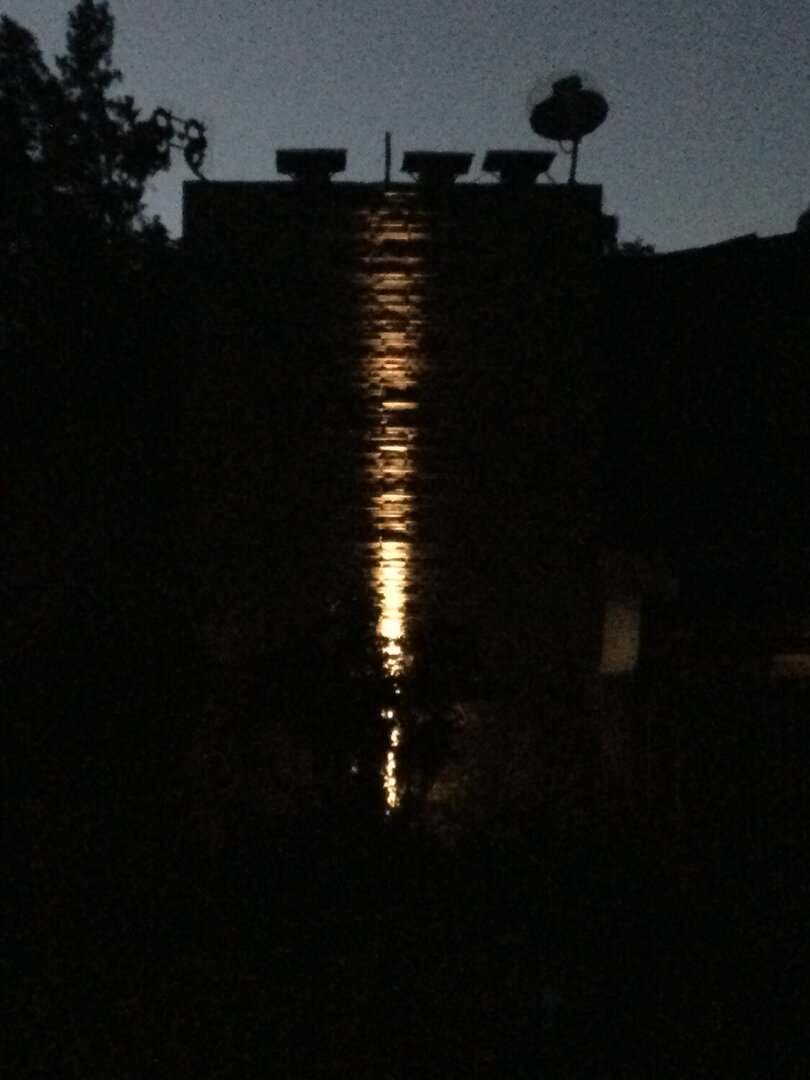

We're streaming most everything these days. I'm using the setup for multiple boxes to do HDMI and Ethernet (MoCA) over all cable that's been run over the years. It also carries the OtA. It's only a matter of time before I get rid of d¡sh.
I've set up a memorial on the dish farm.
