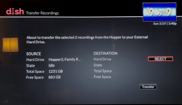

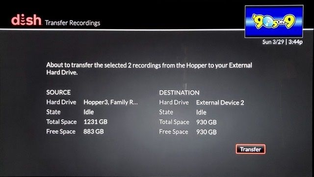

You're all lucky I can't throw anything away;) I found a 1TB Western Digital MyBook that I had hooked up to my ViP 211 before I got a 2TB EHD drive for it. Of course, it needed to be reformatted since the DVR format isn't compatible with the Archive EHD format.
Hmmm, no additional EHD, time to reboot.
Update: After the reboot, I have 3 Media choices, Hopper 3, External Hard Drive 1, and External Hard Drive 2. I'm going to transfer recordings to EHD #2.

I wonder if it's a case of the Absolute Total Amount of disk storage of 8,796,093,022,208 Bytes on this release of the Hopper FW? That works out to 8,192 GB which seems to fit with what I see looking at my 1TB EHD (930 GB formatted) and 6 TB (5,585 GB) added to the internal drive's 1,231 GB available. In my configuration that works out to a total of 7,746 GB.
If I had a 320 GB USB drive available I could see if that showed up since we'd still be under the 8,192 GB limit. If it's 8,000 GB then it wouldn't be seen. Hmmm…
