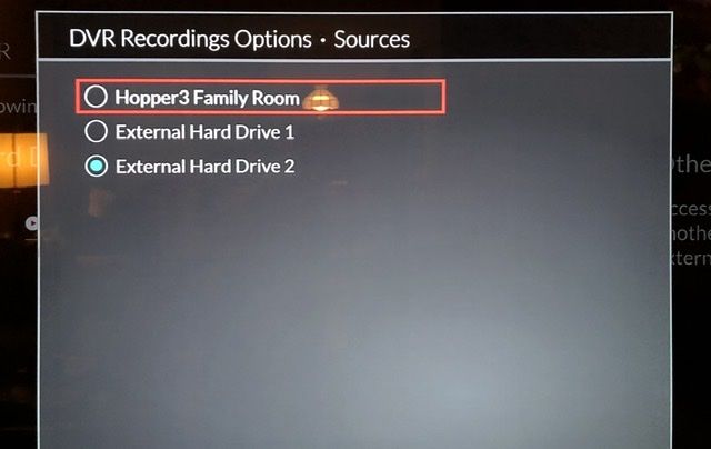

Okay, I had to swap drives around and format the 4 TB drive and the 2 TB before I tried them both together at the same time. I plugged in each one to the bottom USB 3 port, let the Hopper 3 format it, and after each drive had formatted, I transferred one recorded event to the new EHD.
Then, I tried connecting the 2 TB to the front USB port while the 4 TB drive was in the bottom rear USB port (my AirTV OTA tuner dongle was in the top rear USB port). This did not yield a working configuration, so I unplugged my OTA dongle and plugged the 2 TB EHD in its place. The yields the following hopeful screen:
However, all was not golden in paradise as I tried moving the recording I had made earlier back to my Hopper 3. That failed with an Error box that would not let me dismiss it. So, let's reboot.
After the reboot, the two External drives were still visible, but now my DVR screen did not show a "cursor" so there was no way to navigate the screen.
So, good news is the 2 TB and 4 TB are both able to be seen, but the functionality is not quite ready yet, at least using the rear USB ports. Unfortunately, I don't have a USB 3.0 hub which might make things work better, while allowing me to have the OTA tuner connected at the same time.

Okay, 2 EHDs on the Hopper 3 update: I got my Sabrent USB 3.0 hub with switchable USB ports (I can add/remove EHDs without needing to plug and unplug cables). So I removed my 6TB EHD and plugged in my 4.0TB EHD first so it was recognized by my Hopper 3 as External Drive 1. I then transferred an episode of "Jay Leno's Garage" to this EHD. It took about 2 minutes.
Next, I connected my 2TB EHD. The Hopper recognized it as External Drive 2, an improvement over the messages when I tried hooking it through other ports. Okay, it's empty, so I tried transferring another episode of Leno's Garage, and this time I'm prompted to select the External Drive, 1 or 2. I select 2 and the racing dots appear while the LED on the 2nd EHD blinks. After 15-20 seconds, it says there was an error with the transfer.
I think there may be an issue with the way the drive was formatted, and since there isn't anything saved to the EHD I put it on my Windows box and DiskPart Clean the drive. I put it back on the Hopper, it recognizes the non-Hopper EHD, and I format it while the other EHD is connected. After it finishes, I try the transfer again, and again it Fails with an Error.
Okay, time to try restarting the Hopper 3. Red Button restart, and the drives both blink during the process. After the Hopper comes back, I verify the EHDs are both visible, and in the same positions (4TB as #1, 2TB as #2). I transfer an episode of Leno's Garage to External Drive 2 and it's copying!
Okay, now I get cocky and try transferring another Leno episode to EHD #1 while the first transfer is still running. It lets me do it, and I now have two transfers running at the same time! Excellent!
After the transfers finish, I see the programs and try watching a few minutes. Success! Now, let's get greedy, and I set off transferring the three episodes back to the internal Hopper drive. It works as (now) expected, so all the programs are back on the Hopper and both EHDs are now empty.
About the only thing I could want now would be moving Events between EHDs, but this will do.
