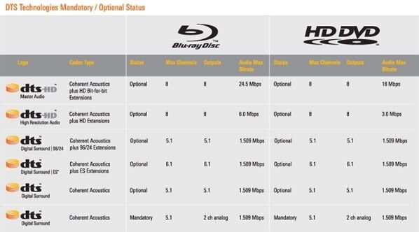

I'm not clear on this either: I know the PS3 cannot decode full DTS HD-MA, but I haven't seen it in black & white if it can decode DTS HD and/or send that to the receiver. I just got some Fox titles in and will play around with it this weekend.
I found this chart on DTS.com that gives a good description of the differences between DTS , DTS HD, and DTS HD-MA, and how they're implemented on HD DVD / Blu-ray:

The answer is no. The PS3 cannont decode any form of DTSHD whether it is the lossy format or the Lossless. It cannot send it to the receiver for decoding either. Paidgeek verified that over at AVS. Bitstream output is an optional component of HDMI 1.3 and was not adopted due to hardware limitations when the system was designed. People just put 1+1 together and came up with their own assumptions.
