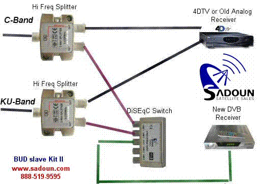

The attached file is how mine is set up. Tonight, with the 4DTV 922 on, I got a clean signal on the 99 but later, I could not get a signal on the 131, 133 or 135. The higher number sats are not working. Any suggestions.
Thanks
Bob

Dish alignment or a diseqc port interaction problem. Try using ports 1 and 4 instead of 1 & 2.

There is some loss through any device, diseqc, splitter, etc. This is normal. Also with inline devices and jumpers you change the SWR and have reflections which can cause the BER to increase.
I just thought I would mention that I have removed my slave kit. It was causing too much of a signal decrease. I don't mind having to switch the LNB cord from 1 receiver to another. Signal loss was causing break-ups with HBO (from the 133). Without the kit, my picture is perfect again. Also, some channels would no longer come in with my Viewsat. Signal is 20% stronger without the kit.
