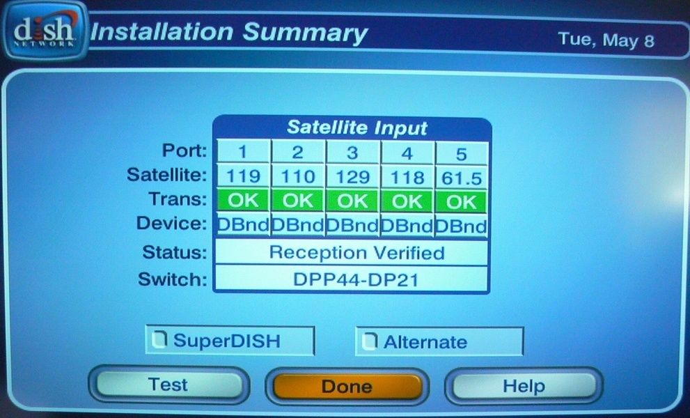

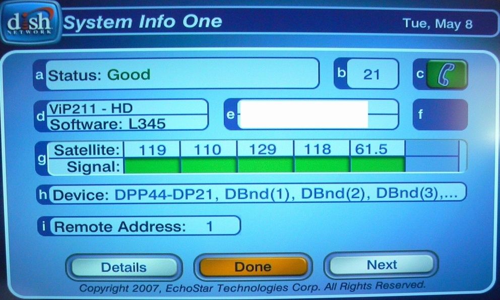

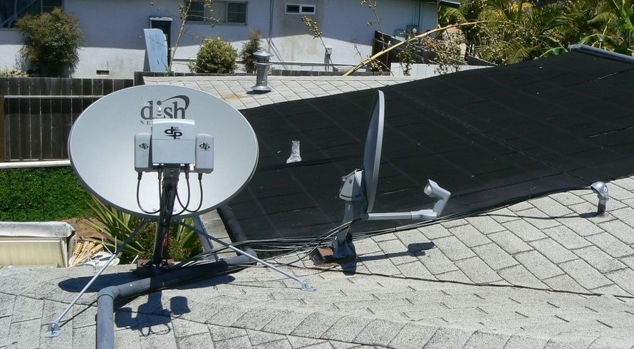

Success! 5 sats with Dish 1000+ & Dish 500!
Finally set this up last night:
-110, 118, 119, and 129 with the Dish 1000+, fed into the DPP44, and from there into one side of a DP21.
-61.5 with the Dish 500 and Dish Pro single LNB, fed into another side of a DP21.
(FWIW, I originally tried to use a Dish Pro Plus dual LNB, but I think the switch interfered with the DPP44, as it wouldn't see 61.5 with the DPP dual LNB.)
The Dish 1000 points almost due south, and the Dish 500 61.5 points almost due east. Almost looks like it is reflecting off the roof. :p
The fish channel (HD demo) and Pentagon channel on 61.5 are pretty nice. Anything else I should look for? Have the Top 100 and HD pack.
Thanks for your great advice!

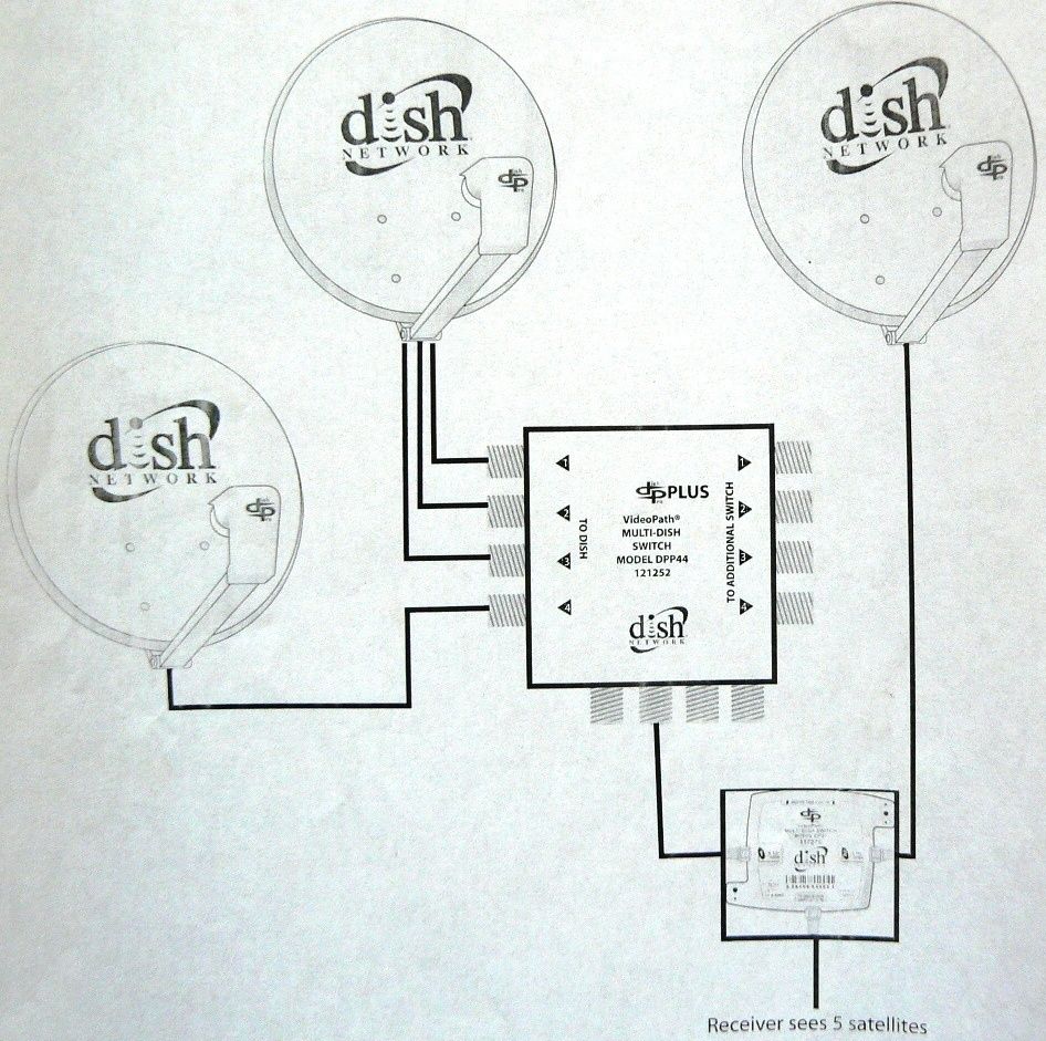

can you explain on how u setup 615 on SW21 again. or may be take pic or draw it out in paint.
Sure!
1. Connect one output from the DPP44 to the "1 to dish" input on the DP21.
2. Connect the 5th satellite location (61.5, 121, 148, etc) to the "2 to dish" input on the DP21
3. Connect the receiver to the "To receiver" output on the D21.
There is a pdf somewhere on here with a drawing of sort of the same idea, but of course I can't find it now. Here's a pic of the printout. Just change the two dishes on the left to the Dish 1000+, and the dish on the right to 61.5, or whatever 5th orbital you want.

ok so you can only do this to two single tuners( with two dp 21's/ two runs off the dp dual) to one single tuner receiver with one dp-21
Got it.
You in Northern CA or there abouts?
Got it.
No.
With 1 DP-21, you can run a single cable to 1 single tuner receiver.
With 2 DP-21's, you can run 2 cables, 1 each to two single tuner receivers; or
with 2 DP-21's, you can run 2 cables to 1 dual tuner receiver.
As stated, even though you have a DPP-44 which supports a single cable to a dual tuner receiver (using a DPP Separator), you lose the DishPro Plus functionality when feeding the DP-21 and only have DishPro functionality, and therefore will need two cables to a dual tuner receiver.
