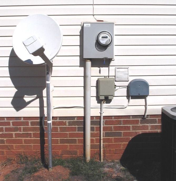

Here's my Dish500 and my OTA antenna.
The Dish500 has been painted with satin white Krylon "Fusion" paint.
I know that many of you will ask why I did not mount to the brick or the vinyl siding. The brick foundation mounting would have been too low, due to children paying in the back yard. The wall is full of water supply and drain pipes; some with horizontal runs trough the studs, making weak structual support areas. Also, the electrical panel and wires are in that area. Screws may have penetrated any of them.
Both the satellite pole and the antenna mast are schedule 40 aluminum pipe and will never rust.
All connections and grounding blocks are in Telecrafter Omni III weatherproof boxes.
Both the satellite pole and the antenna mast are scedule 40 aluminum pipe and will never rust.
You might want to check that coax going into the brick. No drip loop there.
None are needed. It is built into the entry point inside the wall. The entry point is sealed, but if it was open, it wouldn't matter anyway. The lowest point is outside And, there is internal trench with no wood contact on the inside wall of the crawl space. The cables travel upward inside. Any water draining into the brick would have no effect. Also, the entry point is the lowest point of the cables' travel. The slot into the mortar where the hole is drilled slopes downward to the outside.
I've been a Master Electrician for years. I repair and replace a lot of service panels on account of just exactly what you state, when the service entrance cable entres into a basement. Most electricians do not know how tp place an in wall drip loop and depend only on sealant. When I replace the panel or do new construction, I always build a drip loop into the cable inside the wall.

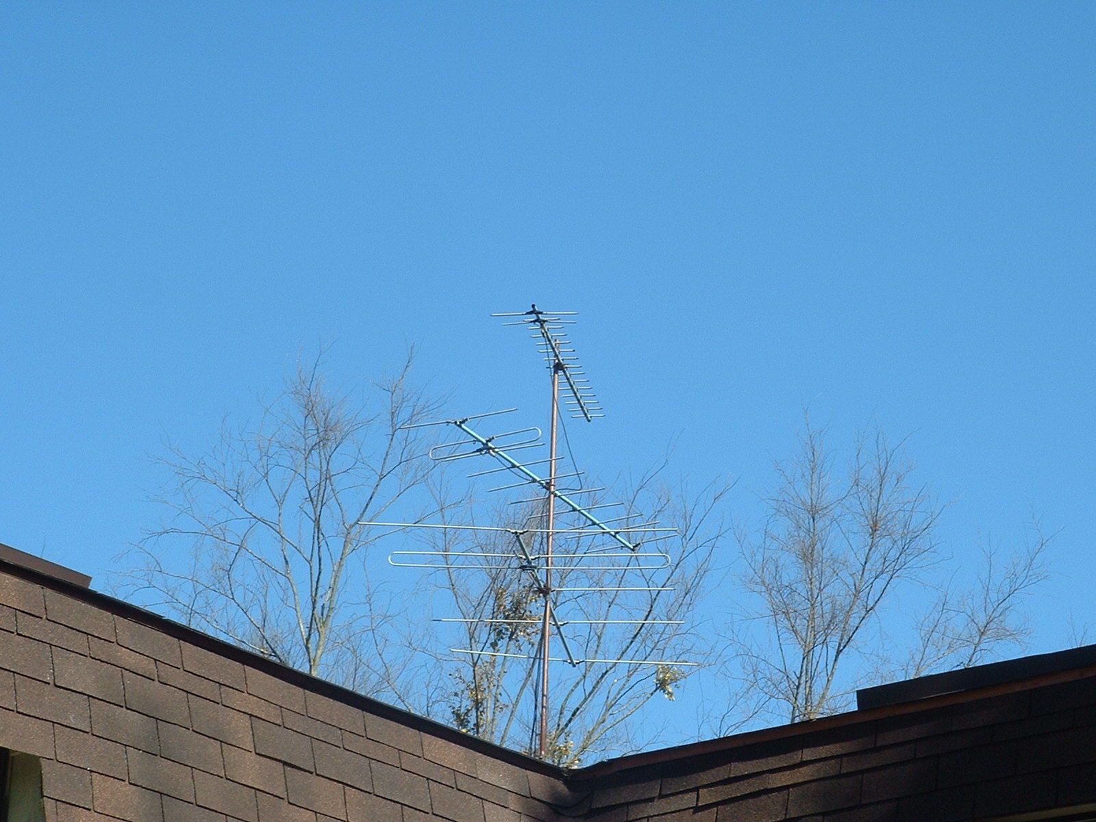

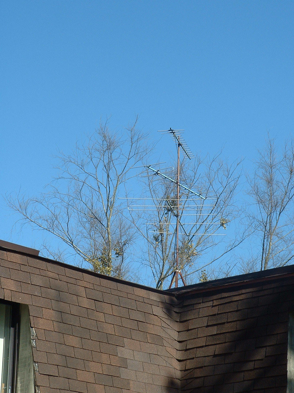

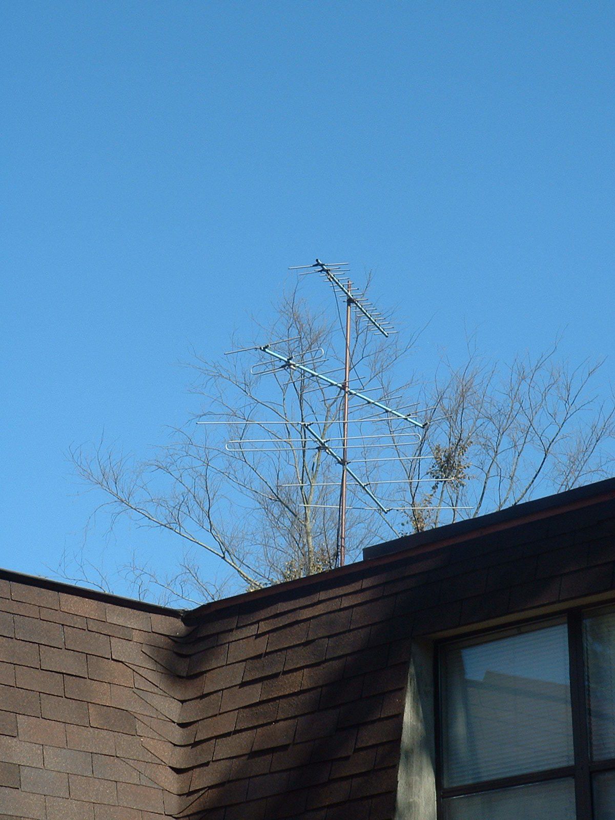

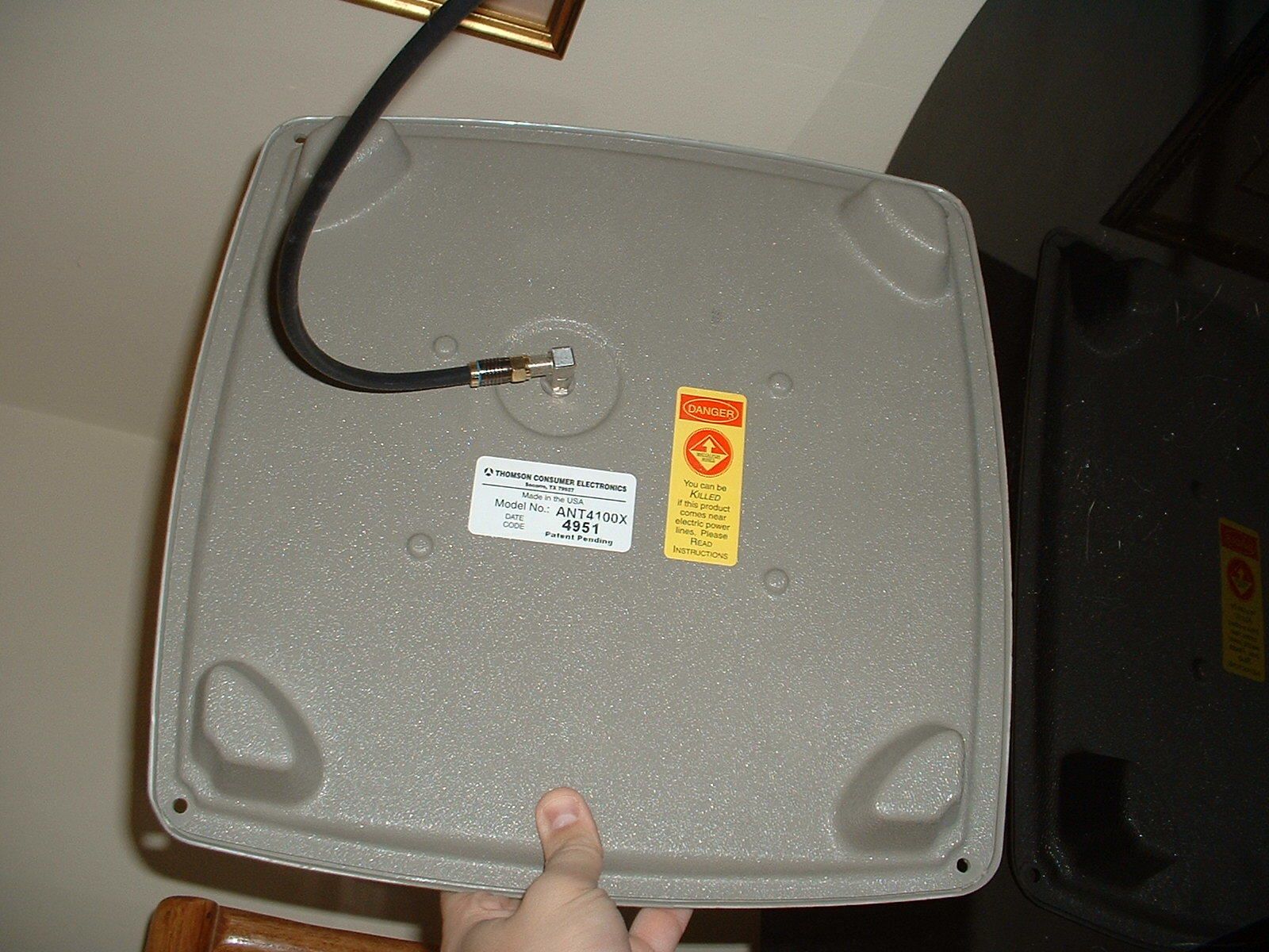

Ok, Here is the Arial on my roof and the Internal Arial I am using now. I ordered a Silver sensor, it is on the way.

Looks like you have three narrow band specific yagi's pointed within 20 degrees in the same direction.
If the current antennas are pointed correctly. you'd be better off with a Channel Master 4228 or, if you need VHF, a Winegard Ghostkiller 7210.
Having either of these outside on the roof would be much better than the Silver Sensor.

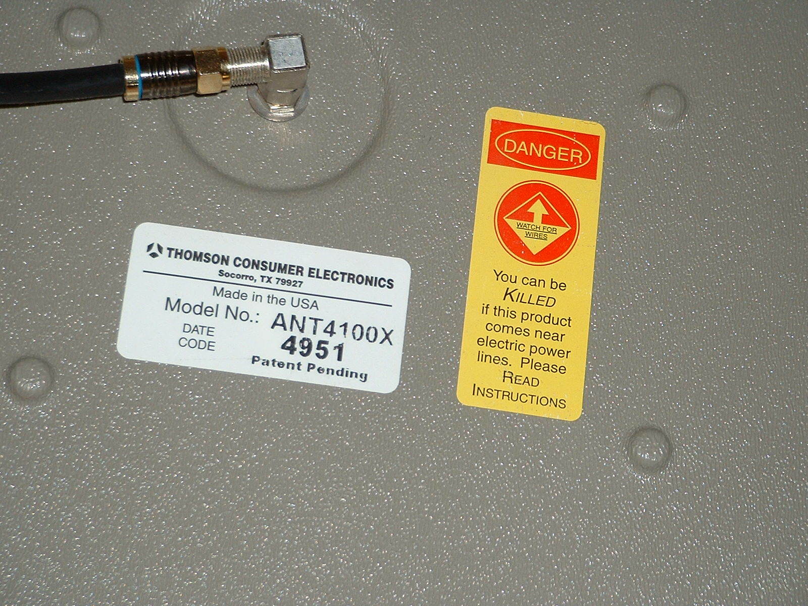

The RCA ia a real DOG. It is similar to the defunct Dishmate or the Walldo.
Man, I have to admit, that stupid RCA multidirectional antenna is getting better results than the silver sensor. It is actually a really good Multi Directional UHF/VHF antenna.
I know the silver Sensor is only UHF, but looking at my zip code (37923) Shows that does not matter.
Overall, the RCA is giving good strong consistant signal across all channels, while the Silver sensor will pick up WB Much better than the RCA ever could, i must have pointed it just right.

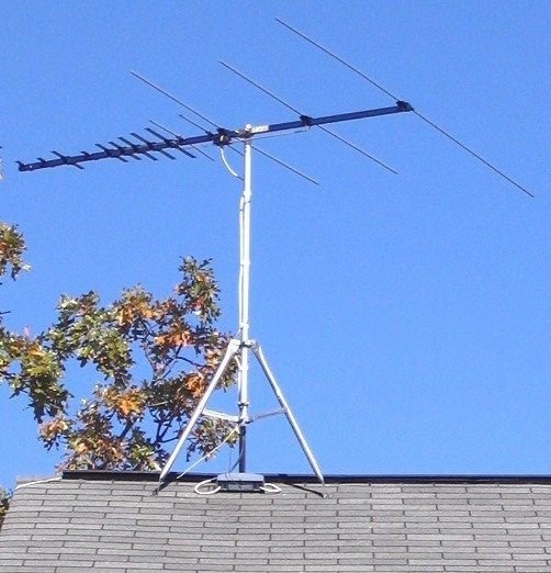

The antenna is mounted on a Tripod from menards. The tripod is bolted to a heavy , I mean heavy oak skid which sits a top 2 sawhorses made of pressure treated 2 by 6's. On top of the skid is five 75 lbs sandbags. The antenna is about 27 feet in the air. It has been there for over 2.5 years and hasnt gone anywhere. As you can see from my roof It has cedar shakes, and I cannot put a tripod on the roof. I am getting a new roof in the spring and It will then finnally go on the roof. It is shielded by the garage from the north so the wind doesnt really bother it all.
