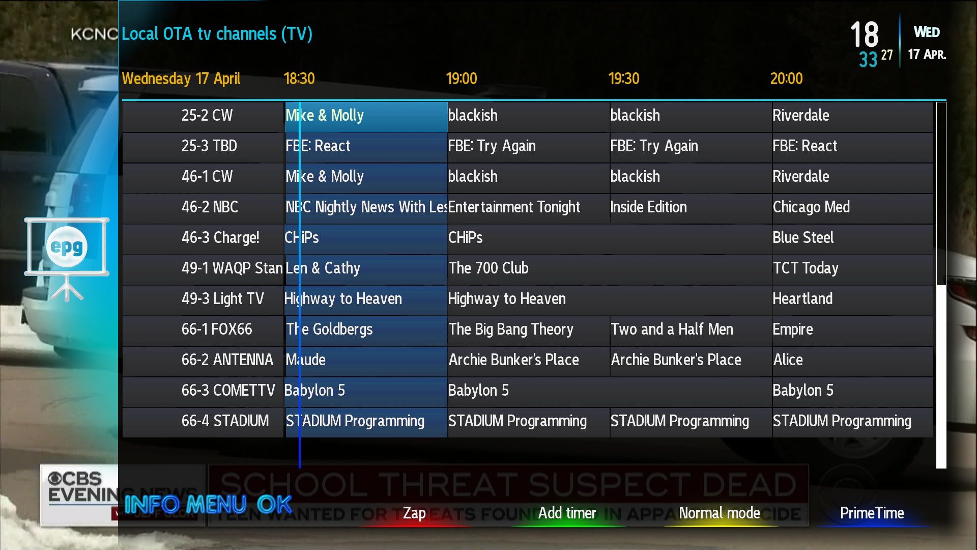

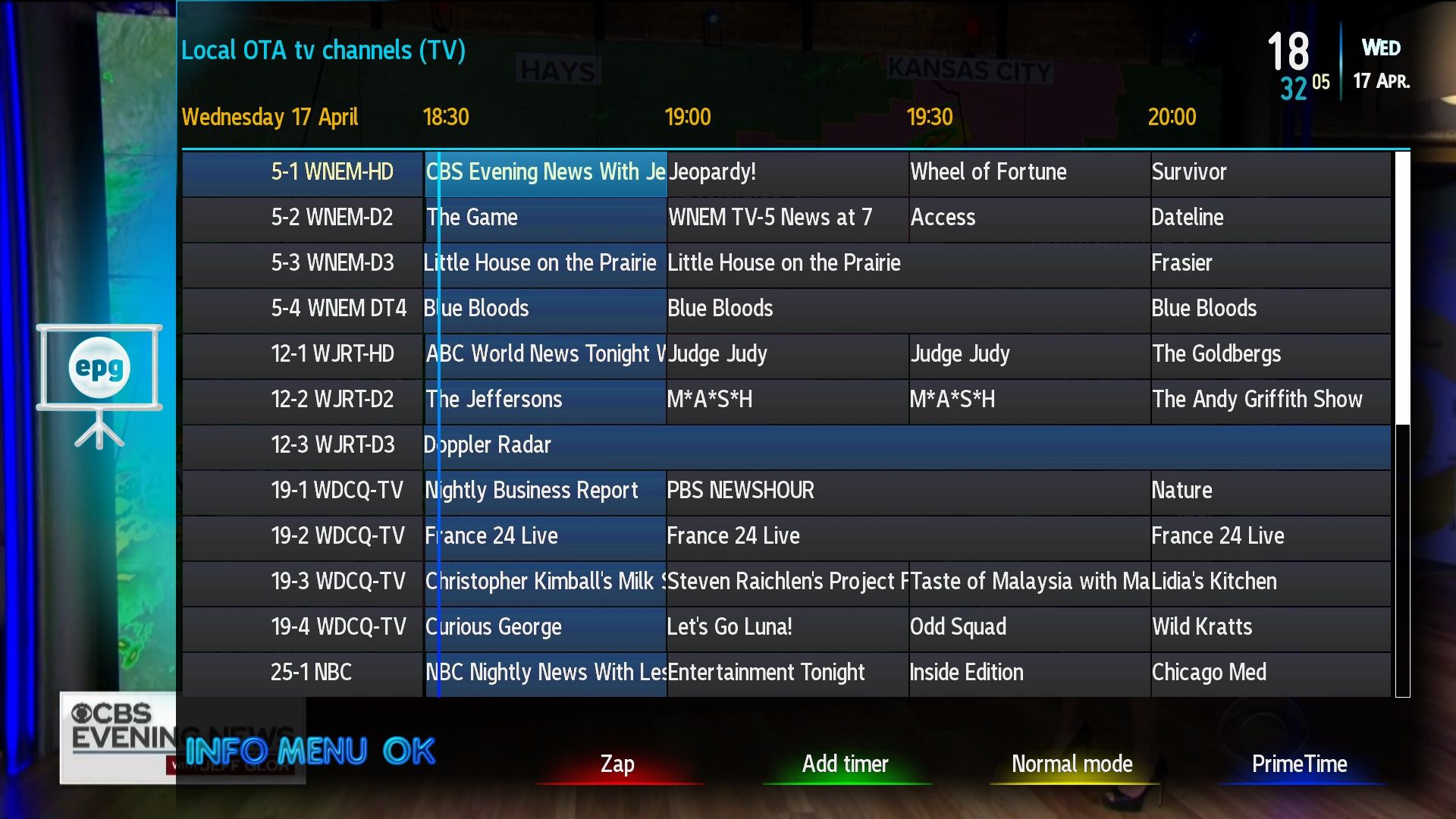

The data for my locals are 24 hours at the most. The 950Q is really sensitive even on my weakest stations here.
A nice bonus for a great receiver. My 950Q was only $10 shipped. Surprising how warm it gets after extended run time.
Reactions: primestar31
Dusted off my 950Q that was laying around for 5 years since I went to HDHomerun Connect tuners.
Plugged it in,rebooted and scanned in 52 channels from US and Canada...you're right Corrado it's very sensitive.
Really like the EPG...nice and easy to set recordings.
