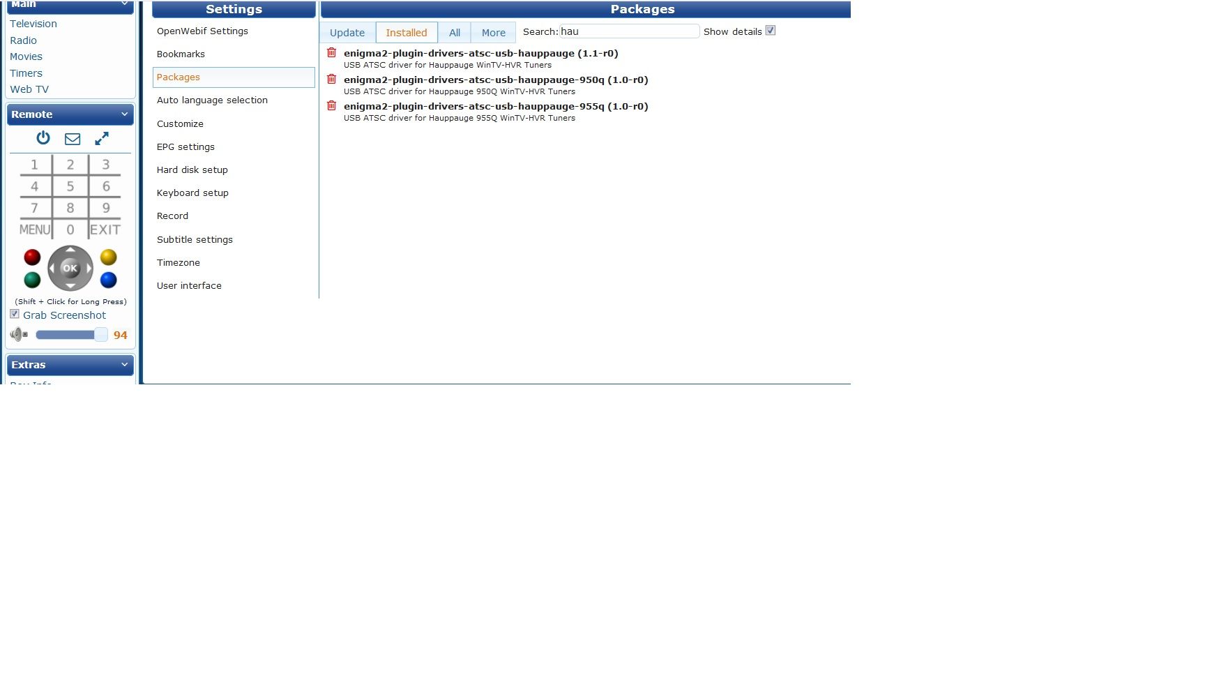

The 950q driver is in the built-in installed drivers list under packages. You can see them all in the WebIF:

To confirm, the Hauppauge 950Q driver plugin is not displayed in the plugin GUI and can only be downloaded or must it be activated via WebIF?
It's already built IN the installed image. I'm not using one at present, but simply plugging in the USB dongle should work. If it's not showing in your customers list, he's either not looking in the right place, or he accidentally removed it.
I don't see the driver listed IF I look directly on the receivers Packages list using my tv set. I can only "see it" in the "Installed" list if I look through the WebIF screen, as shown above in my screen print. I think it would show up in the "Tuners" list IF I had one plugged in.

If anybody wants to see "hidden things" such as these drivers, I very much recommend doing that through the WebIF screen. Just bring that up in your browser, and on the Lefthand side vertical menu, down towards the bottom under "Extras", click on "Settings". Then on the middle screen, you'll see the "Settings" vertical window bordering the larger "in the middle" screen called "OpenWebif Browser Settings".
Click on "Packages" hyperlink under that "Settings" window, and it'll open the "Packages" window in the middle area.
From there you can search on drivers or whatever. Let me WARN you though! IF you highlight an installed driver with a swipe and scroll across like you'd do to try a "copy/paste" it'll ask if you want to "Remove Package".
Conversely, IF you are in the "Update" screen it'll ask if you want to "Install Package". You can hit "Cancel" and cancel out.
So be very careful if you have somebody check in there for something, as you could possibly make a mess of things. I'm not sure if there's only the single confirmation before removing/installing, so let this be a warning.

Only Hauppauge ATSC tuners seem to be supported at present. If you look at the screenprint I posted on the first page below your post, those are the only drivers presently ported to this build. That's not to say others couldn't be added, but somebody would have to do that.
