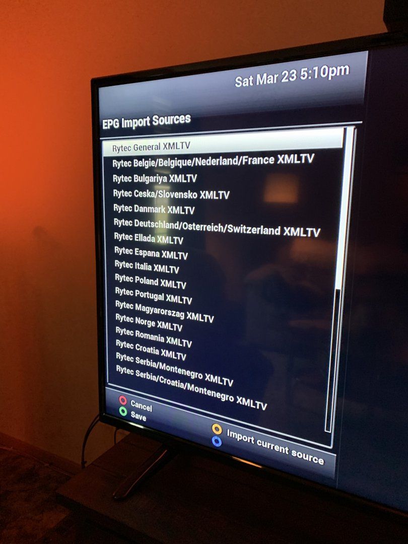

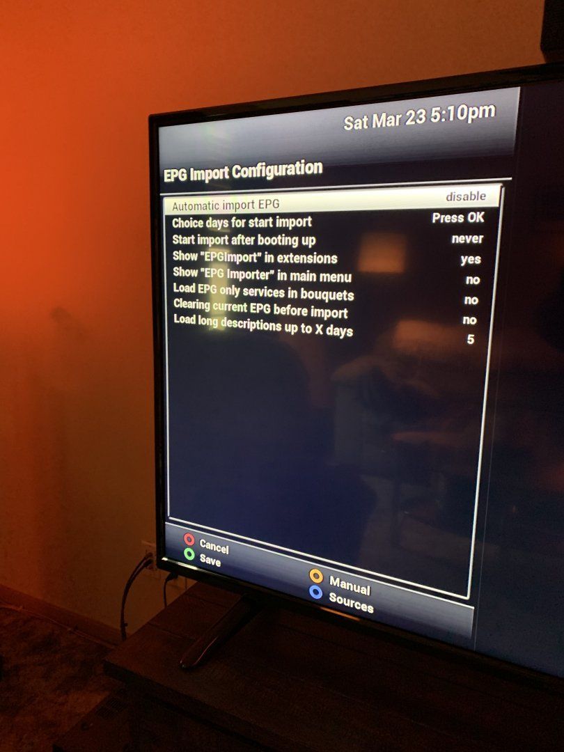

I wouldn't think it would be too difficult to do; there are already a bunch of XML sources built-in, but they're only for Europe. We just need to point to a source and add it to the list:
So it looks like it is possible to manually inport an XML file that our Enigma images can parse for guide data, it just needs to be done manually.
