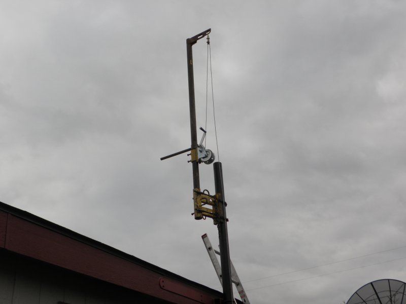

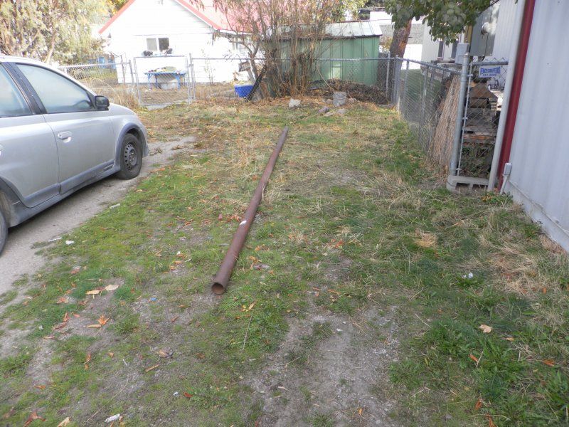

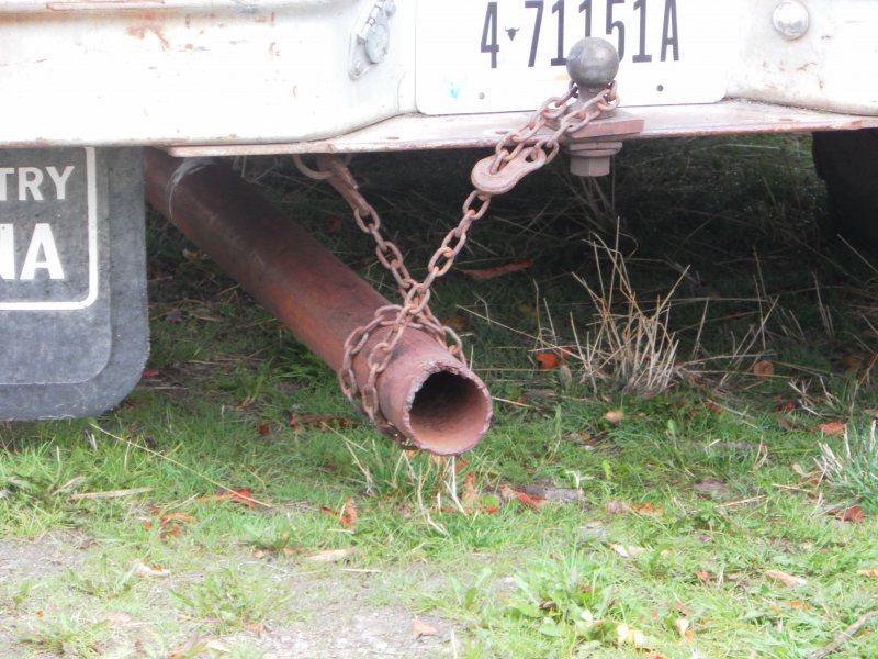

I have been able to get a few more things done on this project. The pole of course required the most work. Digging huge rocks out of the ground is not my idea of a fun time.The pole arrived tied to the bumpers under the truck. ;) It's what you do when it won't fit in the truck, on the truck, or on a trailer. Of course it was rusty and would not be presentable in that condition. First I rubbed it down with emery cloth to loosen the surface rust and rinsed it off. More work with a wire wheel and then a scrub down with CLR cleaner. It was now in a condition for some rustoleum :) I built a bracket to clamp it to the rafters and really hold it secure. Lag bolted into four rafters with 3" lag bolts.
View attachment 129031 View attachment 129032
Here's what I use for my poles, antenna mounts, and old antenna towers. You can also buy it by the case: Rust-Oleum Professional 20 oz. Flat Gray Cold Galvanizing Compound-7585838 - The Home Depot

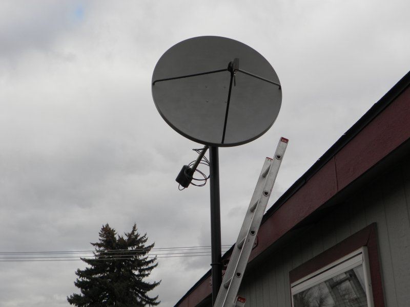

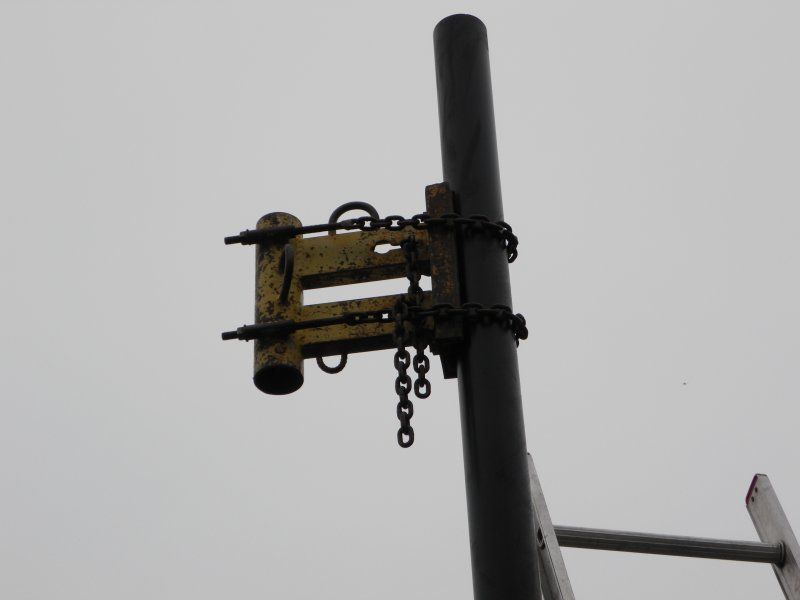

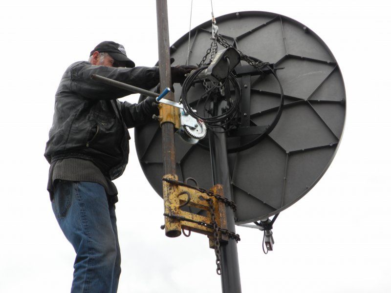

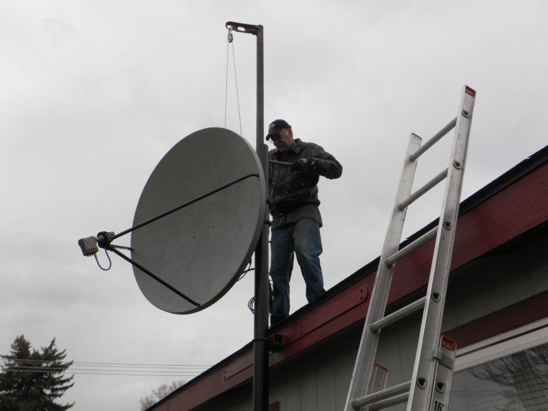

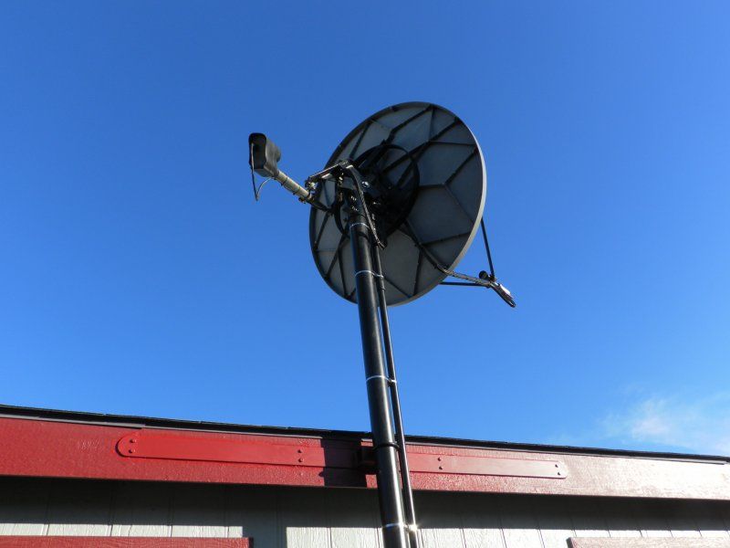

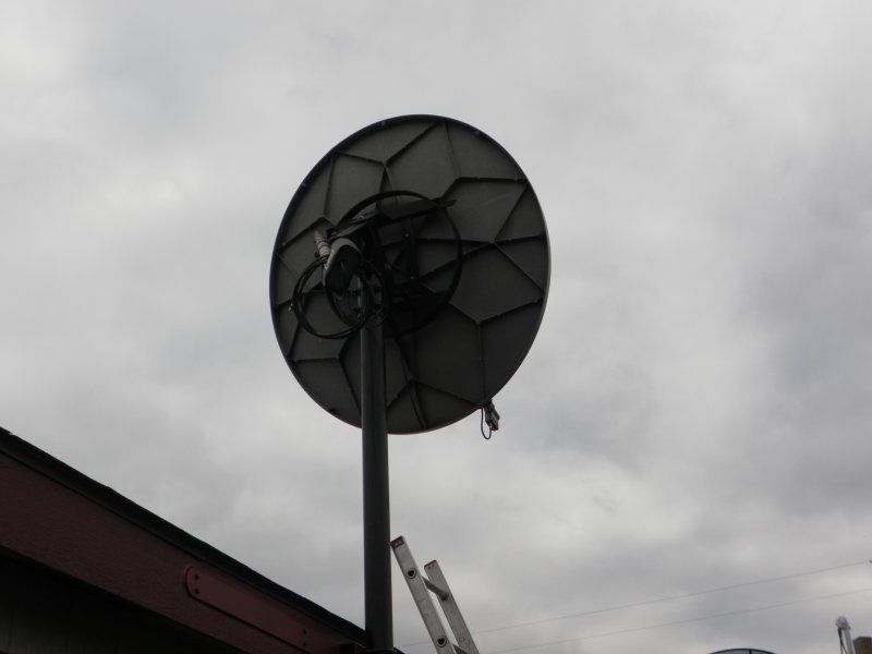

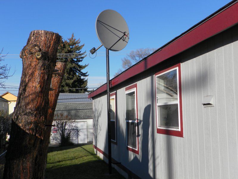

So it's halftime and not raining :) Time to hang the dish. Had my boys lend a quick hand and put it up.
PSinstall 002.JPG PSinstall 009.JPG PSinstall 010.JPG PSinstall 019.JPG PSinstall 023.JPG PSinstall 029.JPG PSinstall 030.JPG
So what was going though his head looking at the other brother. :D

I like your pole transportation technique. I have done similar things with HF yagi antenna material......:biggrin
