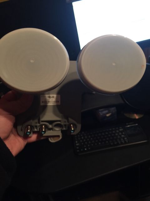

imageuploadedbysatelliteguys1449946407-905535-jpg.112015
The better to see you with.
