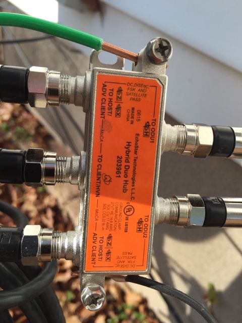

Okay, as I understand the new Hybrid LNB and Hybrid Solo Hub, I will end up with a spare downlink from the dish (I currently have two RG6, one to my 722k, one to my 211k). (I know I using Scott's image of the Hybrid Duo Hub, but pretend it's a Solo ;))
imageuploadedbysatelliteguys1449946605-313056-jpg.112021
The ground block would be replaced with the Hybrid Solo Hub, one downlink would be connected to the ODU port of the Hub, the new Hopper 3 (fingers-crossed) replaces the 722k and connects to the Host connection, and the 4K Joey replaces the 211k connected to one of the Client ports. The last Client port gets capped with a 75-ohm terminator. Does that sound right for my simple case?
Now, big question: what can I do with the now-unused downlink? From what has been said, when the Hopper 3 is connected to the Hybrid Hub, it switches everything to DPZ mode, so that makes me think the second downlink would be unusable.

My current Dish 1000.4 is up on the second floor roof, the twin RG6 w/ground cable comes down along side the downspout to the twin ground block near my electrical service entrance. From there it goes to two RG6 cables to my current ViP receivers. Pretty average installation.
I understand that the switch to the DP Hybrid means a new Dish 1000.2 with the new EA Hybrid LNB. I expected the old ground block would be removed and replaced with the Hybrid Solo Hub. I was curious how the Tech would terminate the unused cable to prevent possible damage to the connector or possible interference in the future.
If I were the tech I'd terminate both cables at the Hybrid LNB. Then I'd use the one connected to port one as the input to the new hub. I'd put a 75 ohm terminator on the other one. Everything is now weatherproofed....
