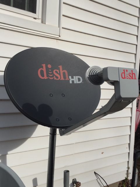

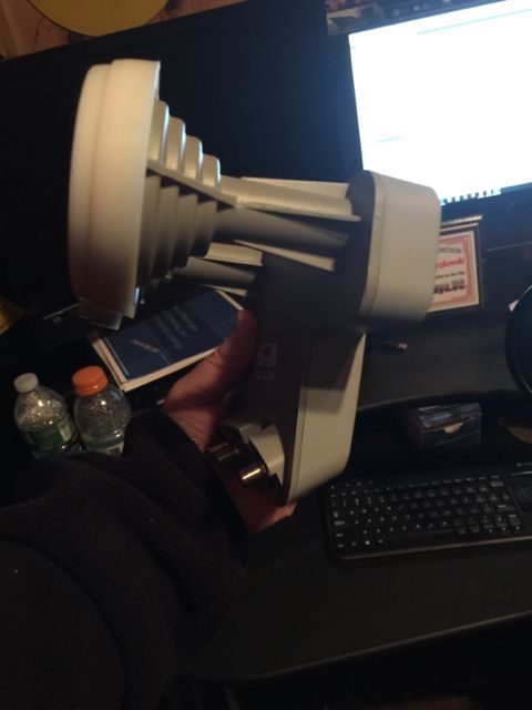

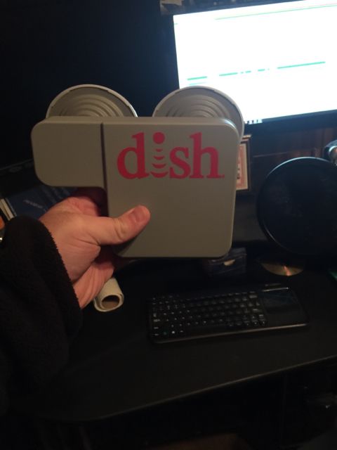

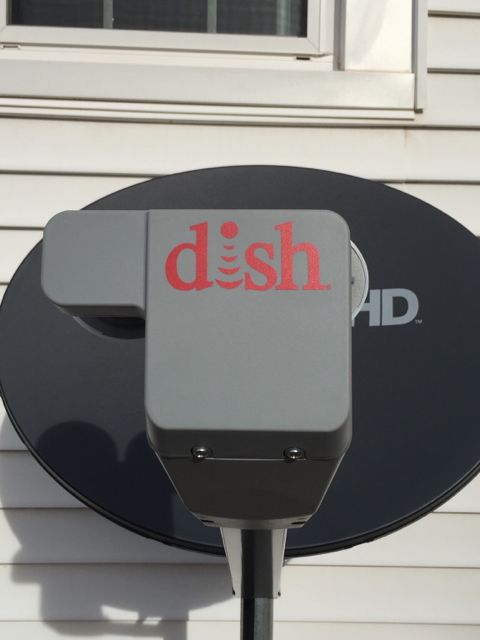

Here's what one looks like this is for the eastern arc.

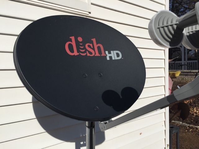

And installed on the Dish 1000.2

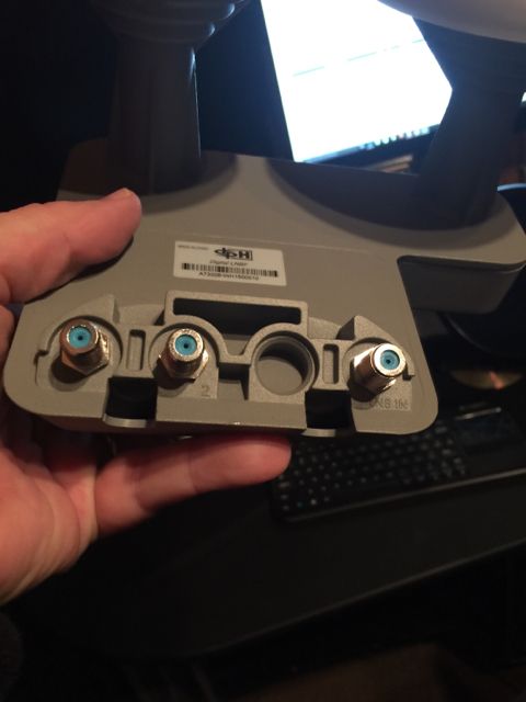

I see they only require 2 Wires, what's the 3rd connection for on the LNB, a wing dish, or Can you run a VIP off it?
