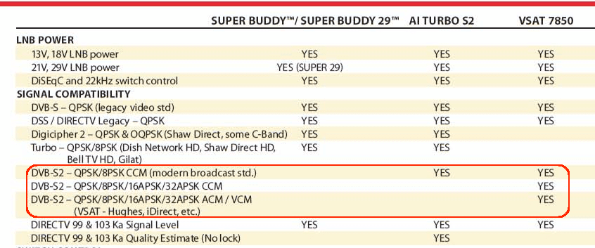

Yep. Lots of S2 now. And it's the trend. Until the next thing comes along. And I hope that's a loooooooong way off because I am into this meter for some serious $$$...
G19 is mostly foreign/religious stuff, very little if any S2 on there. I only find three channels of interest to me, RT, DMC and EBRU. YMMV of course.
All of the PBS is S2 now. Just not really anyway to get around it. Also, the Superbuddy 29 does not do S2. That's why I ended up going with the Turbo S2.
And their VSAT 7850 doesn't do Turbo 8PSK you can't do Dish/Direct with it. So it's pretty much down to the AITS2 if you need to "do it all"...
The Superbuddy meters are good if you're just doing commercial Dish/Direct only and not messing with FTA.
