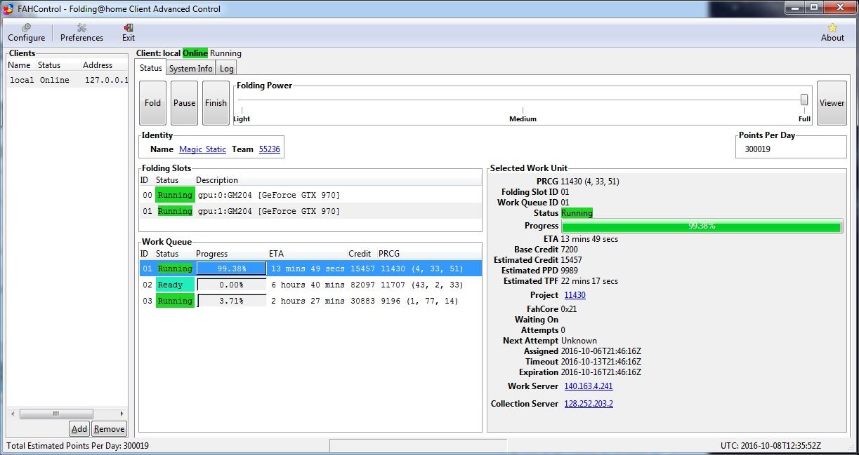

I'm doing a WU right now that is a real average killer. less than 16k points and 1.5 days to complete on a 970. PRCG 11430 over 22min TPF :eek

We need a retching emoticon for this post. What Project and Run, etc., is it so we can keep an eye out for it?

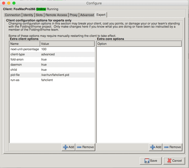

So, did your legally-challenged GTX 970 get a better WU to process? ;). I noticed that your FAH Client must be set to download the next WU at 99% and not 100%. Since your Bonus Clock starts when download the WU, and at 20+ minutes to process the last percent, you effectively turned off your Folding rig for that amount of time.
Go into your Configuration, Expert Options, and set/create an Extra Client Options named "next-unit-percentage" with the value of 100.
Chances are your Client will be Cleaning Up while the next WU downloads and won't have to wait for the download to complete to start processing. With modern download speeds setting this Option maximizes your Points awarded to the work your Folding Rig does.

I did do that. But this program has a mind of it's own.
