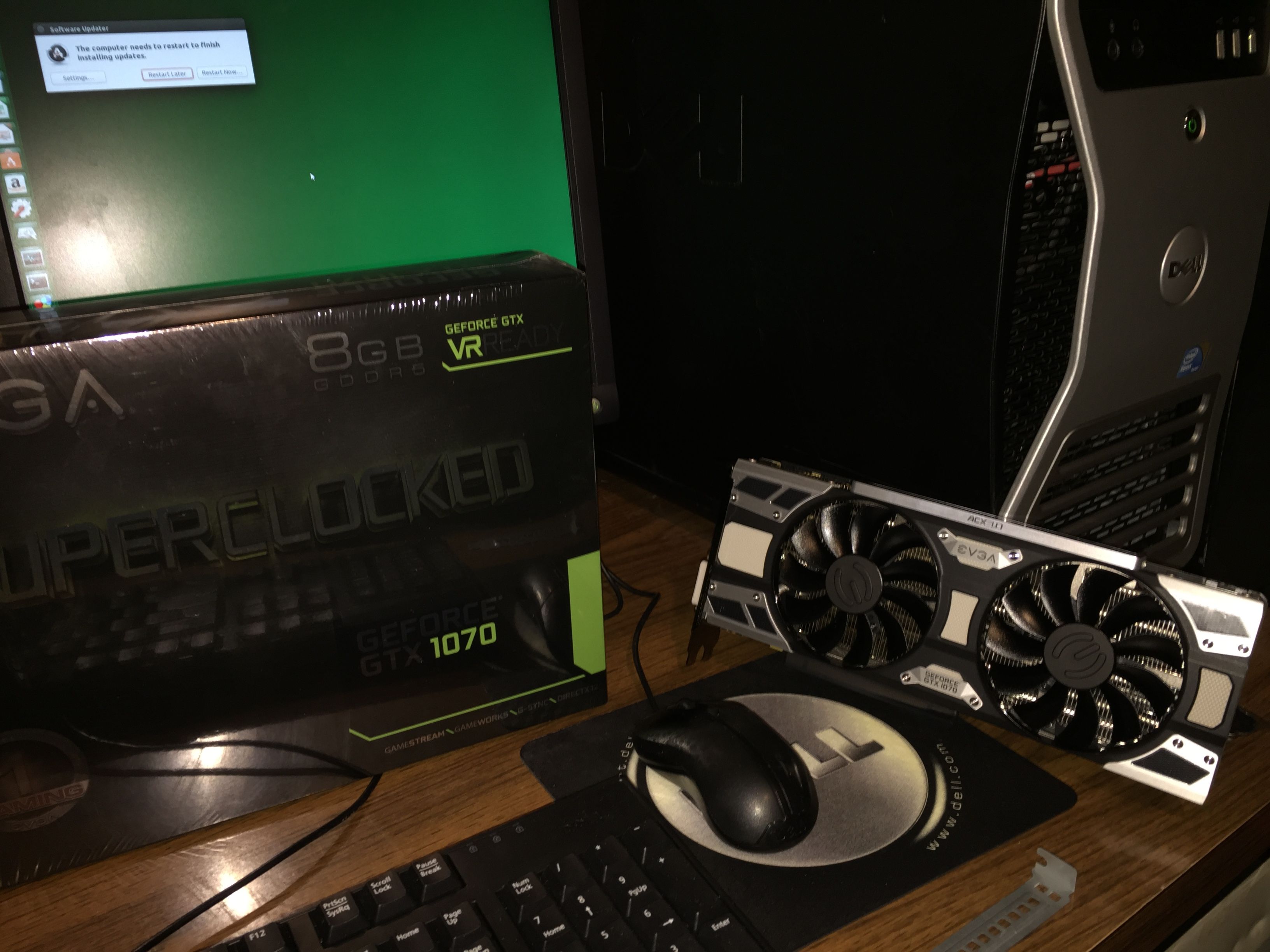

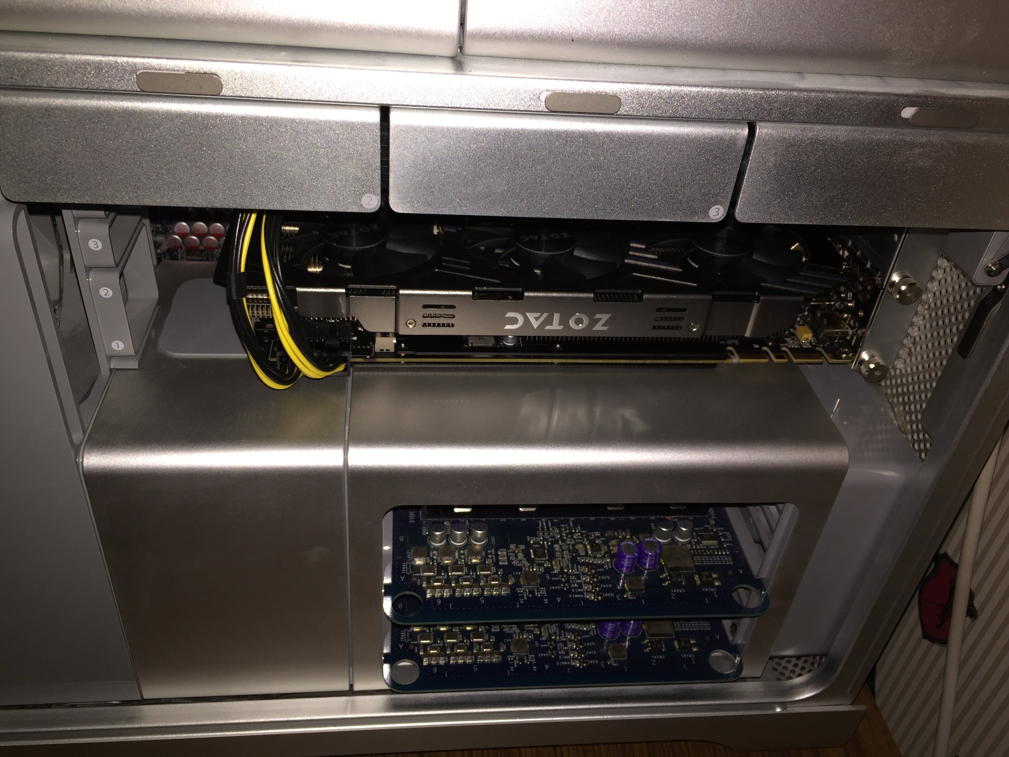

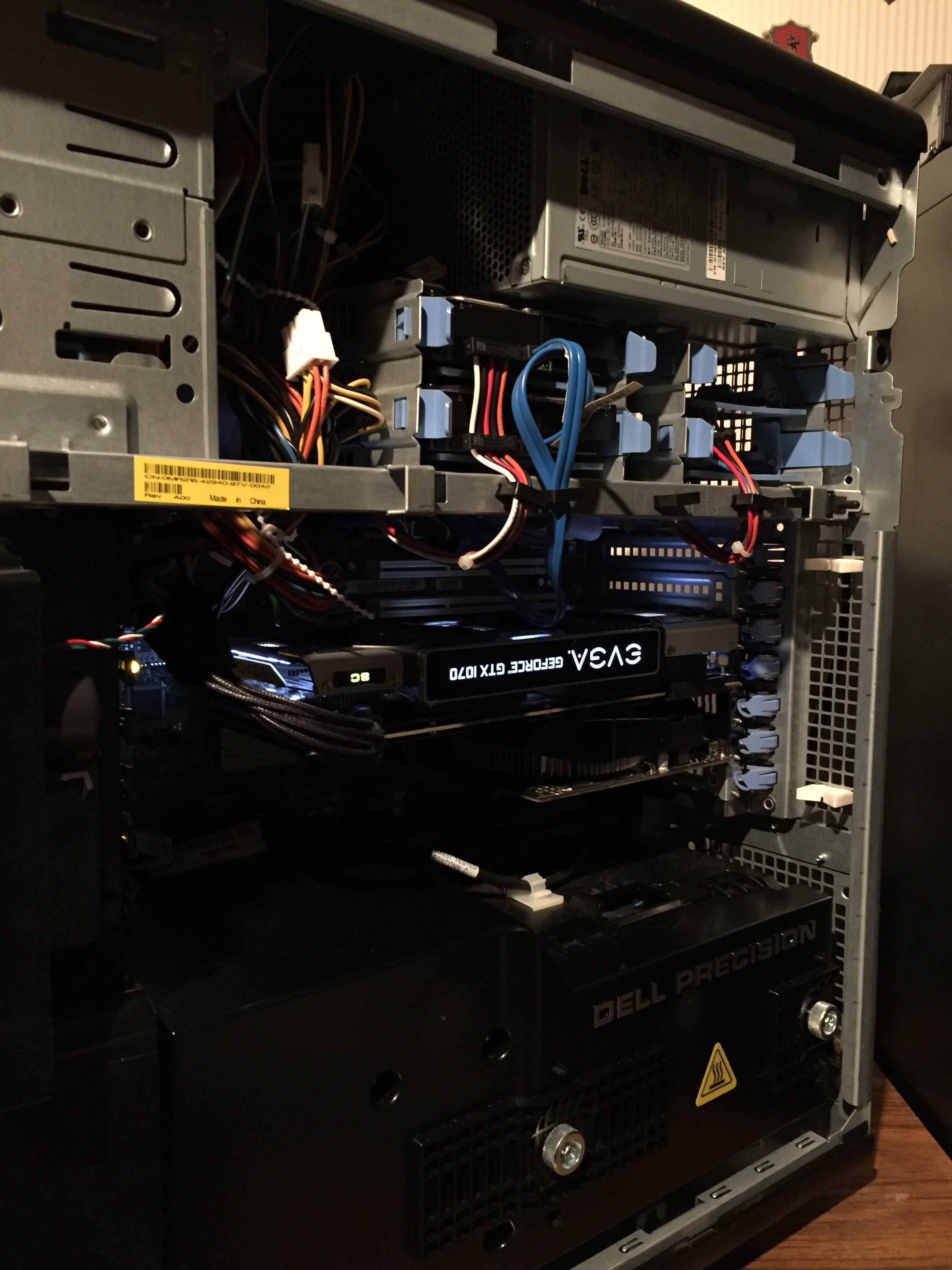

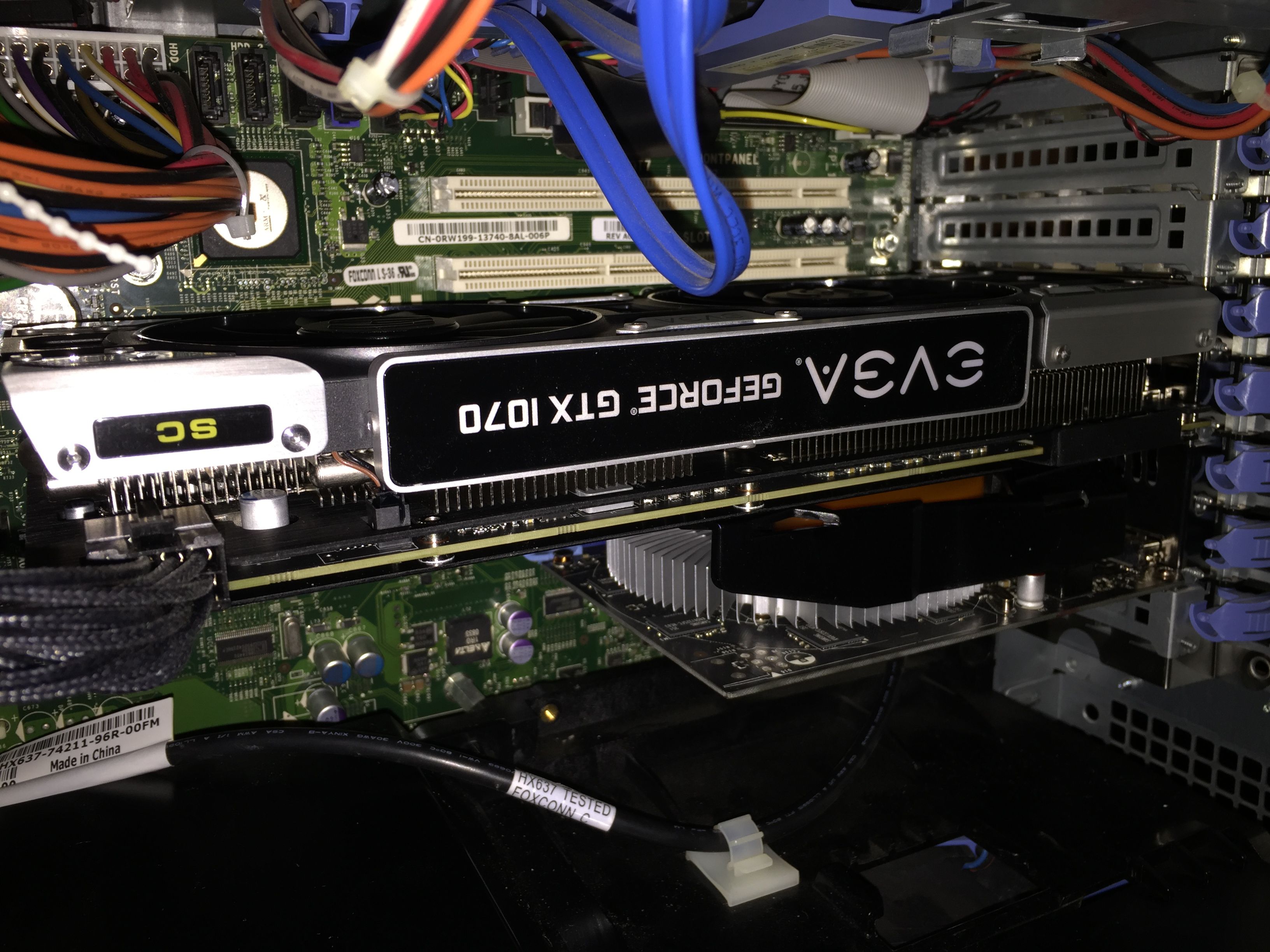

Cat's out of the bag! I ended up with the SuperClocked EVGA GTX 1070 since the FTW variant cost another $20 for maybe 10 MHz faster clocks. This arrived Friday and was up and running in my Dell T7400. The bummer was finding out that I couldn't run my GTX 970 in the same box because there is a lack of PCIe GPU 6-pin cables with the Dell. The GTX 970 from the Dell T7400 was relocated to my Mac Pro, and the GTX 960 that was in the Mac Pro is now sitting on the shelf. The GTX 750 Ti I had originally bought for the Mac Pro is keeping the GTX 1070 company until I can figure out the Power Supply capabilities.
I had used the Amazon link in the header, but since I did it through my iPhone, I wasn't sure if the Link setting transferred into the Amazon App. I asked Scott if he knew (he wasn't sure) so I guess we'll find out. I'm hoping it does!
Below are the pictures:
(last one is the GTX 970 in the Mac Pro)

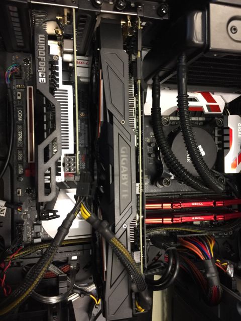

Nice! This is the exact model I have. The thing is a beast. Mine boosts all the way up to 2000MHz when gaming. It's only advertised to boost to 1784 but if your temperatures are low and the card is under it's power limit it keeps boosting itself higher. I didn't even bother manually overclocking this time because Nvidia's turbo boost 3.0 works so well on it's own with this card. Temperatures are about 10 C cooler than my old 970 SLI system too.
View attachment 119484 View attachment 119485 View attachment 119486 View attachment 119487

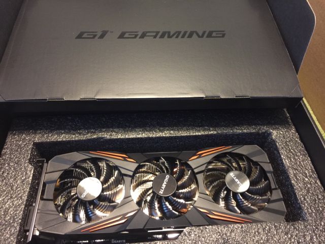

This was the other card that was in the running for me. I had no complaints with my EVGA SC 970s and I like that their headquarters are in the US. The main reason I went with the Gigabyte G1 is because it was the first 1070 I saw in stock and I have no patience. It's also one of the cheapest, higher end overclocking models at $430.
Reactions: Foxbat

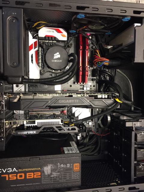

Ok have mine installed now.
I had to switch out power supplies as I wanted to keep the 750 TI card in the machine as well and the VGA power cords wouldn't reach from the 1070 to the 750.
So went from a 500 watt power supply to a 750 watt power supply in this machine.
Which is ok as the other machine (Which also has a 750 ti card in it) is ONLY used for folding.
Here is what it looks like now with the new power supply installed with both video cards installed and hooked up as well.

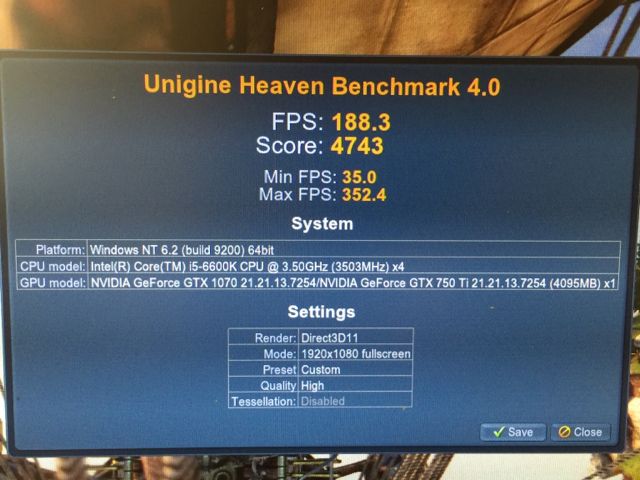

I have one monitor hooked to each video card. For some reason the resolution of the 1070 was only 800x600 and the nvidia program was. It seeing the 1070 but was seeing the 750. So what I did was uninstalled all my nvidia stuff and reinstalled it and after the install now it showed both cards.
Next thing up was did a heaven benchmark test. Not sure if these numbers are good or not but here they are.
Nothing is overclocked here.

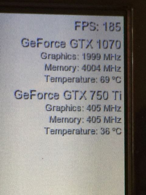

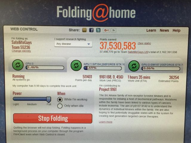

Went into Folding@home and it could only see one GPU which was the 1070. So uninstalled F@H and reinstalled it. I have it all configured up and both GPU'a are running at full speed.
Here is what it looked like after a few minutes folding.
Reactions: Foxbat and KE4EST
You are getting about the same turbo boost clocks as I am (2000MHz). That's really impressive for a card that already has a really high base clock at over 1500MHz. Nvidia's turbo boost 3.0 on these new 1000 series cards works very well. It just about matches the best manual overclocks without you having to do it yourself. On the 900 series and older cards turbo boost 2.0 worked but there was always more headroom for those who wanted to manually overclock.

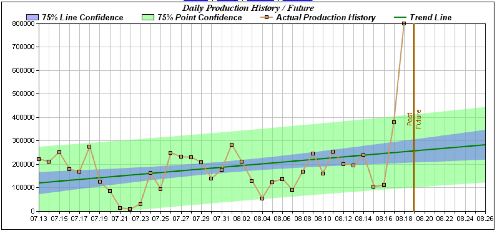

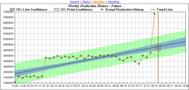

I see Scott's Daily Average is starting to creep upward. He may end up in third place if Scorpy and johninbricknj stay throttled back.
Who's Next? :devilish
Yup just added up todays numbers so far, almost 600,000 today already. :D
