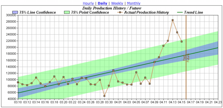

Looks like you got things moving again:

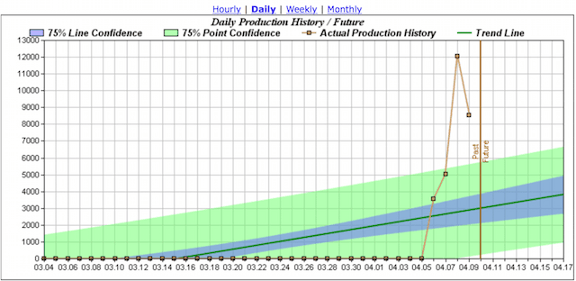

Well I got the new video card in yesterday as well as added a second machine over the weekend.
Now if I could just figure out how to see my graphs so I see how performance has increased. :D

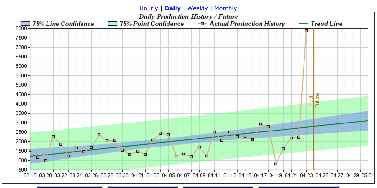

Scott, have you verified that your Folding rig is configured correctly? Your SatelliteGuys user for our Team has not shown any extra production this week. Stanford shows only two clients have been active for the last week and 50 days (no change).
Yup I am sure....

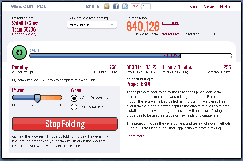

I added a second computer last week (Its not a fast machine) and then I upgraded my video card from the one that was built into the motherboard to a GEFORCE GTX 750TI card, my windows experience shot up from a 2.8 to a 7.9 with that swap.
Maybe I need to reinstall FAH on this computer to take advantage of the change?
Scott - Try these changes.
Bring up the advanced control screen.
Drag the power bar to full.
Click on configure and go to slots.
Click on gpu and in the extra slot options add "client-type" under Name and "advanced" under Value.
Then add "max-packet-size" under Name and "big" under Value and then save.
Click on cpu and in the extra slot options add "client-type" under Name and "advanced" under Value and then save.
These should kick your CPU and GPU into high gear.

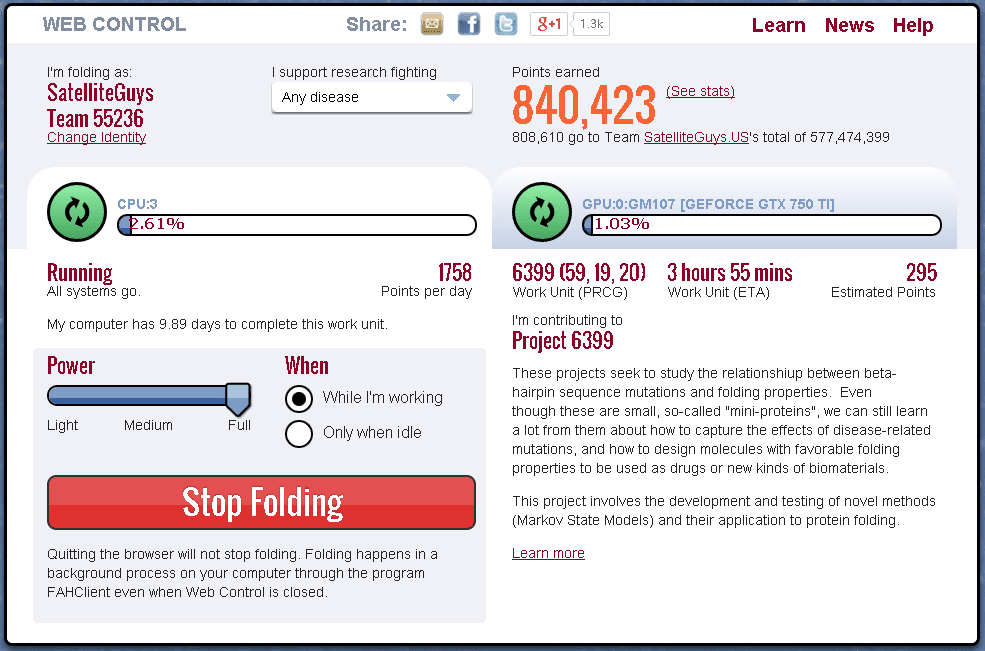

I would say your F@H Client didn't add the GPU slot to your configuration. Voyager6 is pointing you in the right direction. You should be seeing 50K-70K PPD from the GTX 750i card alone. If you don't see a GPU slot, you will need to add it manually.
Yup there was no GPU listed in the configuration. I uninstalled it and reinstalled it and see it there now. I also made the changes that Voyager suggested above and this is what I see now.
Reactions: Foxbat
We'll know before you go home from work today!
Oops, that 3h55m completion estimate is for the CPU slot. You'd need to click on the GPU:0 tab to show its estimated time of completion.
It also looks like your CPU is getting higher Points WUs by making the changes Voyager6 recommended. Every little bit helps!
