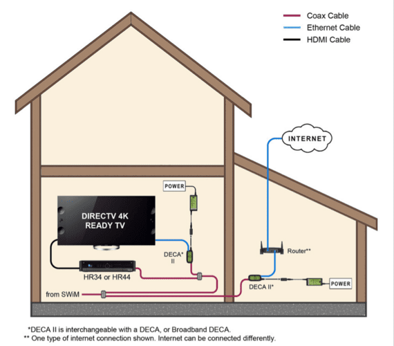

This answers the question...
Single TV installation, where the only TV is a DIRECTV 4K Ready TV
  1. You will need two (2) RC7x remote (use the highest level remote you have on your truck)
  2. The Genie should be installed and connected to the TV as normal (i.e. HDMI, Component/Composite with audio). This is needed because most DIRECTV Ready troubleshooting must occur at the Genie Server and not through the DIRECTV Ready connection.
  3. Program the first remote to operate the Genie STB (Recommended to be programmed in RF mode),
  4. On the Genie STB, disable HDMI CEC so when the Genie is turned ON, it won't force the STB to the HDMI input. (To access the HDMI CEC setting on the Genie, go to Menu -> Settings & Help -> Settings -> Display -> Video -> HDMI Control.)
  5. In addition to the normal installation steps for the Genie STB, the TV must be connected to the coax network using a DECA, Power Supply and Ethernet cable, then added to the genie as a client.
  6. Once the DIRECTV Ready TV is added, program the second remote (DIRECTV Genie remote) to operate the TV in DIRECTV Ready mode.
  7. Since the DIRECTV 4K Ready TV must be activated as a DIRECTV Ready Client, the customer must pay the Additional TV fee.
  8. If the customer would like the audio to play through their surround sound system, it is recommended that the Genie be connected to the TV via HDMI and the TV's audio output be connected to the surround sound receiver. By connecting the TV's audio output directly to the surround sound system the surround sound audio will work no matter which input/source the TV is set to.
