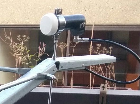

The pictured unit is an Inverto Black Pro, voltage switched polarity (13vdc=vertical / 18Vdc=hortizontal), Universal type (10.7-12.75GHz) Ku-band.

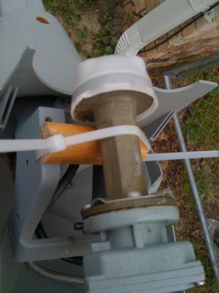

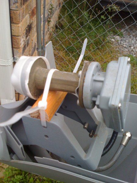

Ok I see what you're saying now, so how would you suggest I mate that lnb up to the feed horn? Last time I did a rig job like that it came out like this... LOL

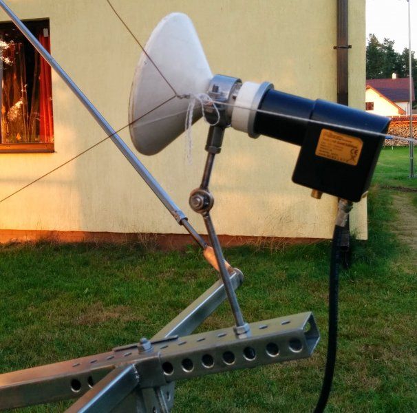

Most proper way to mount new LNB to existing feedarm is to make something like this IMG_20140730_210043.jpg IMG_20150828_185603.jpg then it is possible to adjust its position very precisely so LNB's Phase center is co-located with antenna's Focal point. And, IMHO, Inverto Black Ultra will outperform any other LNB even if it is mated to original Prodelin feedhorn.

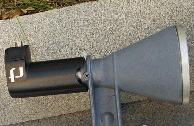

No, I do not have a link, as there are no IBU LNBFs ready to be married with C120 flange. But, it is always possible to cut-off integrated feedhorn and adopt the rest to flange connection. That was done to Twin LNB (first photo in my previous post). There is another way how to adopt IBU IMG_20150726_200753.jpg
But, for Prodelin 1,8m it is better to use not modified IBU without any C120 flanges, that will give same results (difference is non-noticeable).

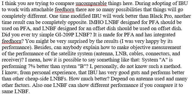

Thanks for the reply. I haven't tried a GI-290P, but I will be trying a few different feeds and LNBs. Sounds like it isn't worth modifying my one IBU for the PF dish, if the results aren't predictable. Thanks again.
Well, the IBU is a little pricey, so I'd rather not cut off the feed unless there is a good chance of better results then the Pro. I'll just keep it as is for my offset dish.
