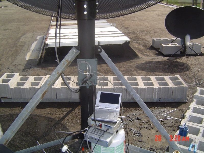

What I find amazing is that with the right setup etc, a 1/8" thick wall on a 6" pipe has held this dish up for at least 15 years.
We are going to find a piece of at least schedule 40 with a 5.5" - 6" steel OD pipe to weld the brackets to for the mount to hold the dish.
Got a 5-1/2 OD schedule 40 pipe, going to be picked up by the welder and the flanges welded on to be used with my mount.
The welder brought by my modified 5-5/8" schedule 40 mast. It cost $20.00 for the pipe. I already have it on the roof and the mount semi put together.

Hey George,
did the welder just weld an adaptor to the mount that you bought ??
As you might have seen in the original pictures of the mounts, the center mast has steel flanges welded onto the mast at the bottom, and then again about 2.5 feet up. Those bolt to the angle steel which connects to the out-riggers.
Here is another pic of the final mast and how it connects.
It doesn't matter how big the diameter of the mast is. You just make a new set of flanges, and weld them to the new post. :D Then bolt to the angle steel.
