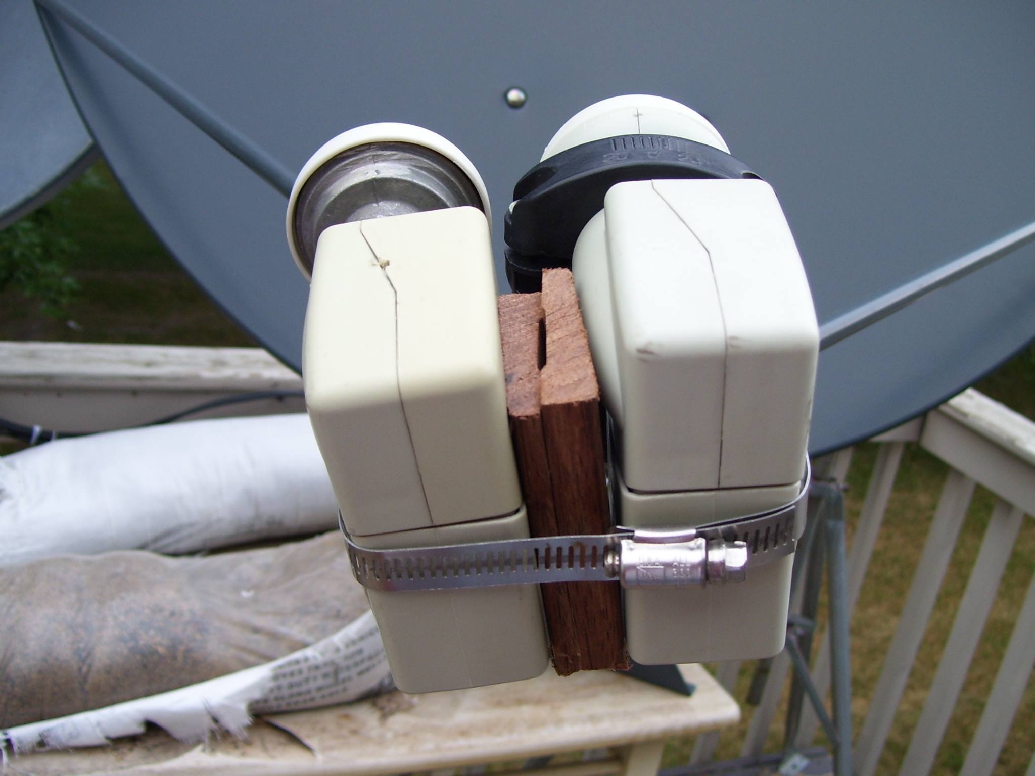

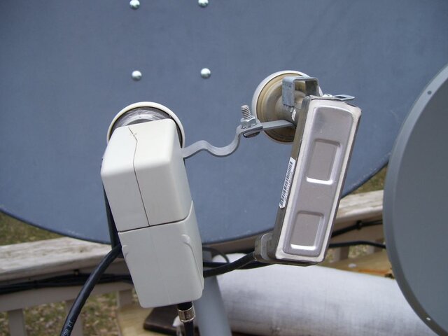

It can be done and has been done very easily. You dont need to skew the dish. You just manually place the LNB where it needs ot be in terms to the 6 foot dish
A twin LNB WILL NOT work due to the spacing on the 6 footer. The separate LNB's will need to be at least 6-7 inches apart. The bigger the dish the farther apart the LNB's will be due to the focal distance.
I hate to say it, but its trial and error unless a local dealer in the Caribbean has an adapter that will work.
Here are two examples of setups I did using non traditional setups
1st is a Primestar dish that is for 107.3 & 119....dish cannot skew so just put a bracket that raised the 119 LNB up
2nd is a 4 foot dish for Shaw Direct. They use 107.3 & 111.1 and the LNB on a "stock" (37x27") setup the LNB's look squished. The 4 footer they are spaced apart about 1 1/2"

thanks boba and iceburg. . .this is my first time playin with 'dish' and from readin it seemed all i needed was the sw-21 switches but i needed to confirm all this before buyin. . .
i know it trail and error but i like the fun in tryin to make it work, i just needed to know i had the correct switches.
