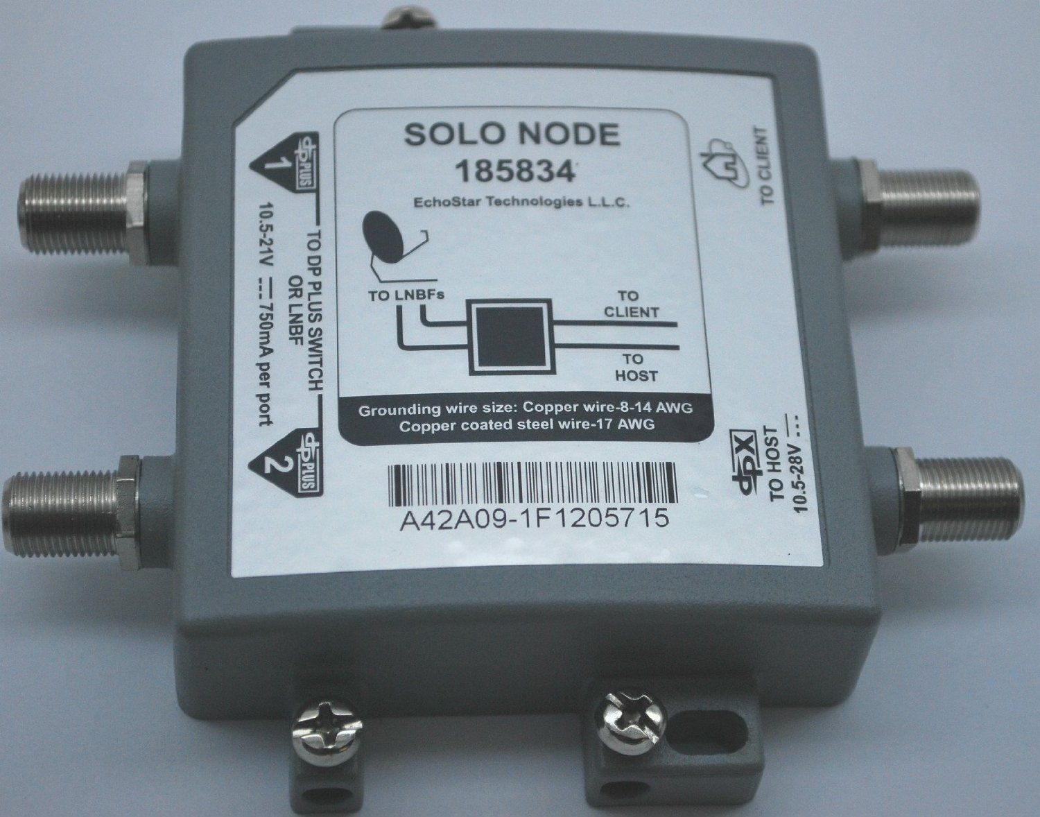

my bad - it was actually called a "solo hub" OOPS!
Now I know where my confusion originated - I had found online a picture of Dish's "Solo Node" (they actually have such a thing) but we are using the "Solo Hub" for sure. I learn so much here :) 81t36HVIFjL._SL1500_.jpg

It is important, very important, not to mix the terminology up on these. People might think they have what is needed and it is the wrong product. Nodes work with H1 and H2, Hubs work with H3.
absolutely - listen up everyone (especially those who are still "shopping" for the Hopper 3) - you will need a solo hub and NOT a node!

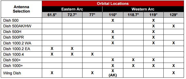

There is a lot of confusion on low beam zip codes. I'm going to attempt to explain it.
129° Low Beam ZIP Codes refers to certain ZIP codes for which HD or SD Eligible Local Networks broadcast from the 129° orbital location have low signal strength and require the installation of 2 DISH 500 antennas for proper reception.
Part of the problem is, there are many Alaska (probably all) zip codes that are considered low beam in addition to the many mainland dma's. However there is 1 big difference in Alaska. They use a Dish 500AK for 119 and 129, it's a larger dish than a regular 500. It cannot use a twin lnb because of its larger size and requires an external switch. Depending on their package and location they may require a wing for 110. All customers in Alaska get a Dish 500AK, which begs the question. Why consider them a low beam to begin with?
At this time the Hopper 3 can only work with a dph lnb designed for the 1000.2 dish on either western or eastern arc. The dph lnb has 1 input, this puts a lot of configuration options for low beam customers, international and those with locals on 77.
Options are definitely there. The big question is, will dish allow it? Some are reporting yes and others no.

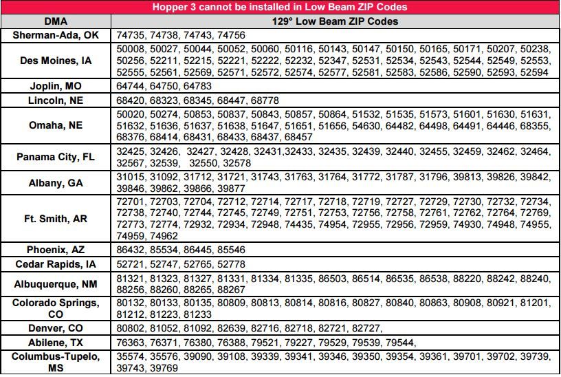

But what about those that are flagged low beam, but only have one dish? I have a 1000.2 and they're not letting me upgrade.
It appears Dish isn't budging on these low beam zip codes even though it is possible. They go on to say not all addresses within these zip codes will be ineligible. Saying their system will determine availability for a specific address. They also say the hopper 3 will not be a solution if programming requires 77 or 118.
Looks like the dph42 is gonna be the only solution for these folks and the waiting has already begun.

Re: this statement
129° Low Beam ZIP Codes refers to certain ZIP codes for which HD or SD Eligible Local Networks broadcast from the 129° orbital location have low signal strength and require the installation of 2 DISH 500 antennas for proper reception.​
the chart you presented doesn't show the 500 dishes covering 129 (except for the one marked Alaska/Hawaii and I live in Washington state), are you guessing I have a 500 dish and a 500AK/HW dish?
Is that chart supposed to be a complete list? WA state isn't even in the list.
