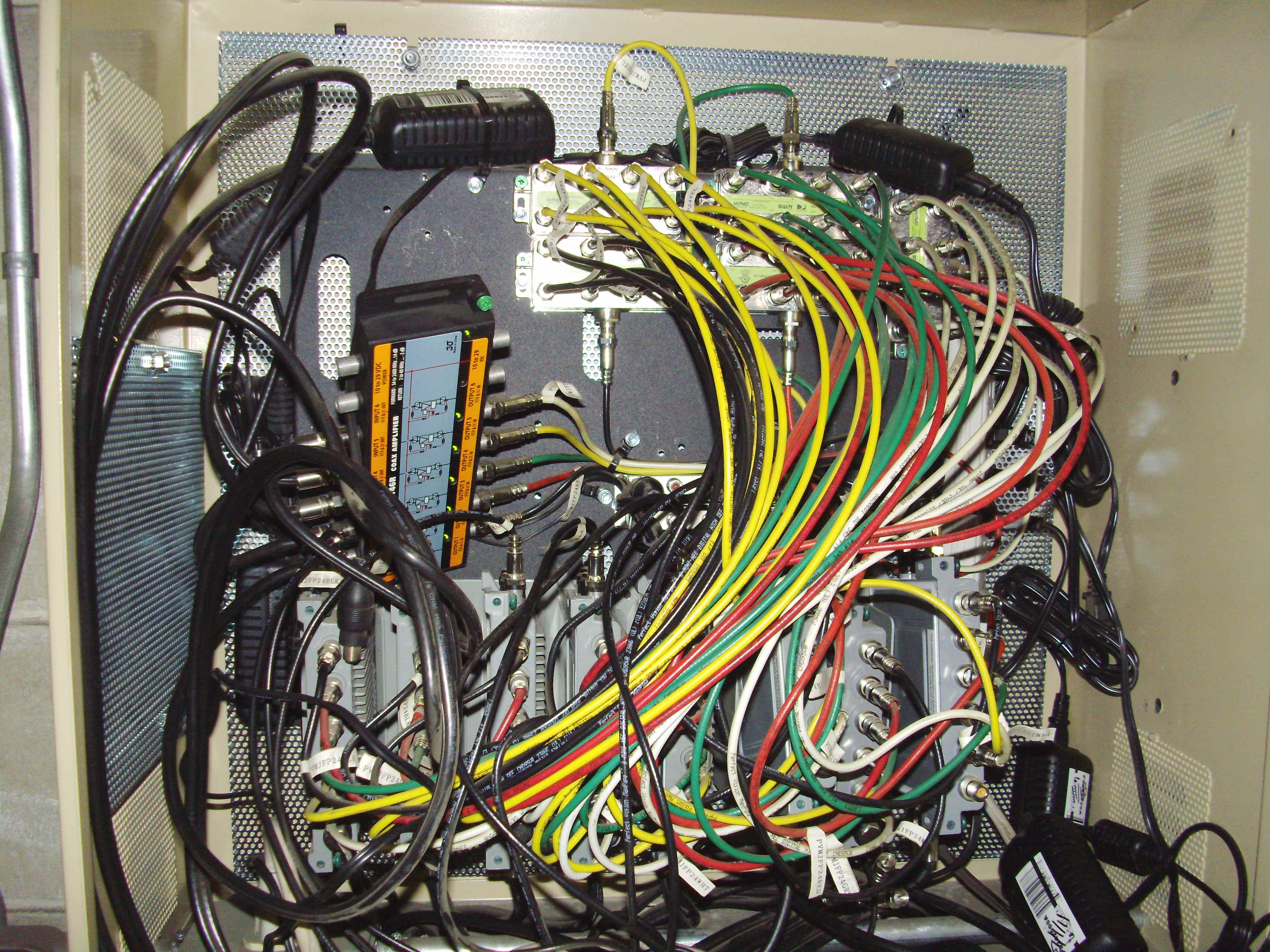

Here is what I know (in bold)....the other is speculation

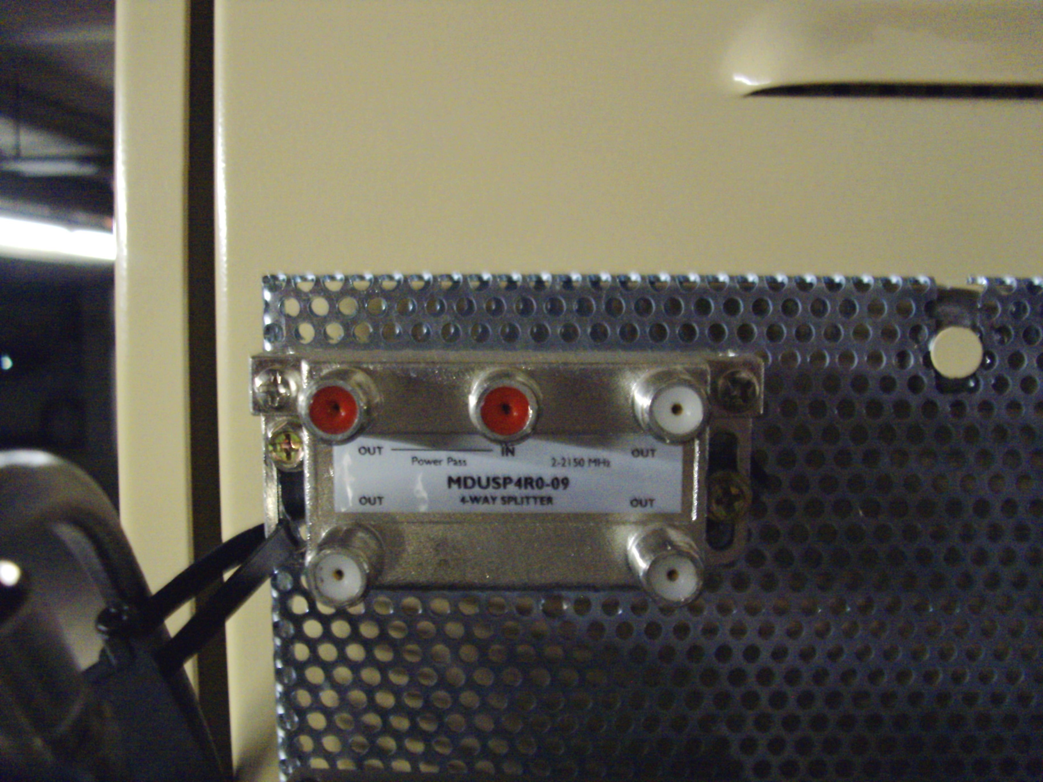

5 lines come from the roof down into the basement...4 from a slimline 5 and one from 95W.....this goes into a locked box
assuming there is a splitter and amp in there....not a SWM splitter but like below in the 1st pic....because there are TEN cables that come out from another spot in that box

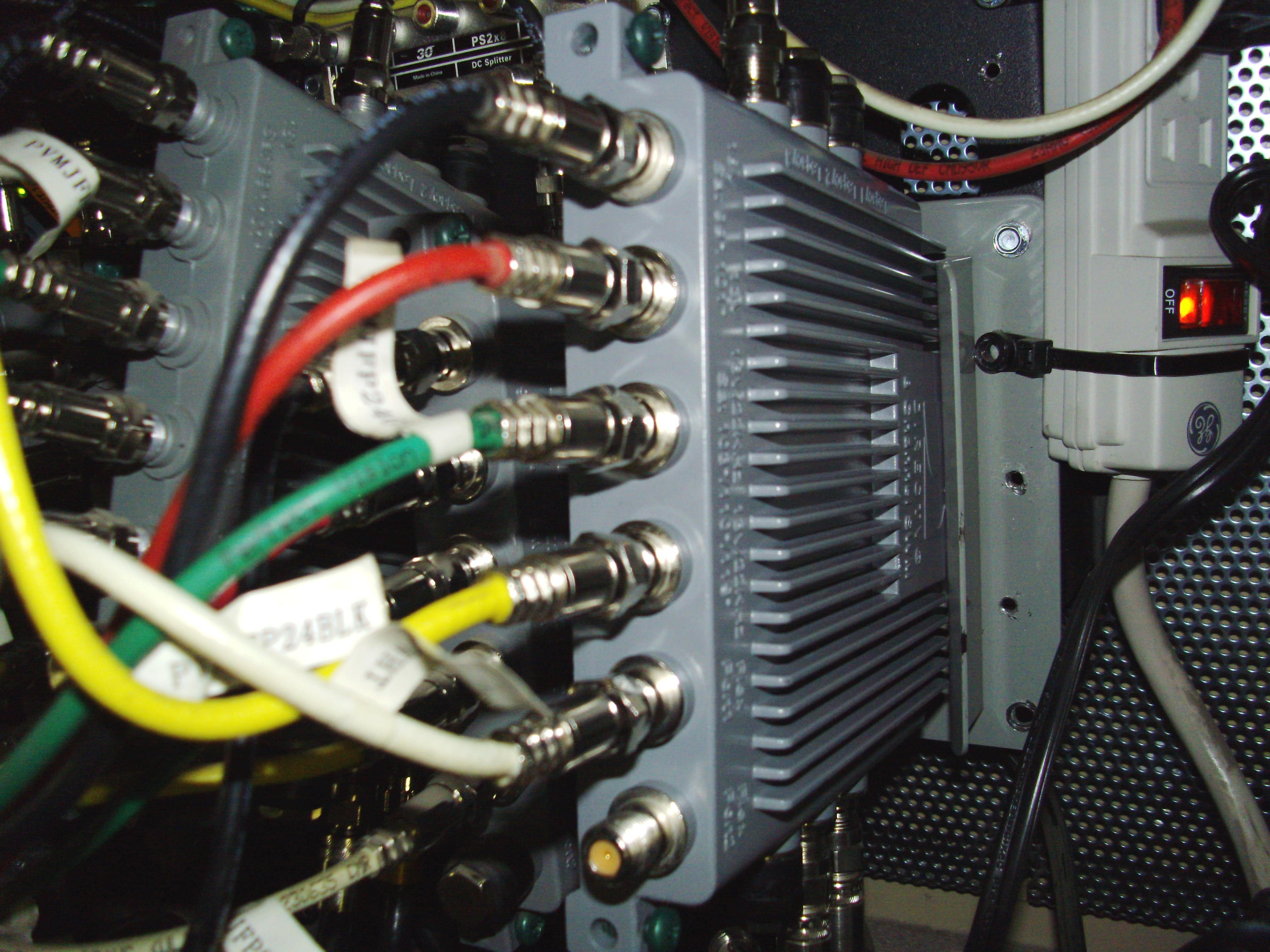

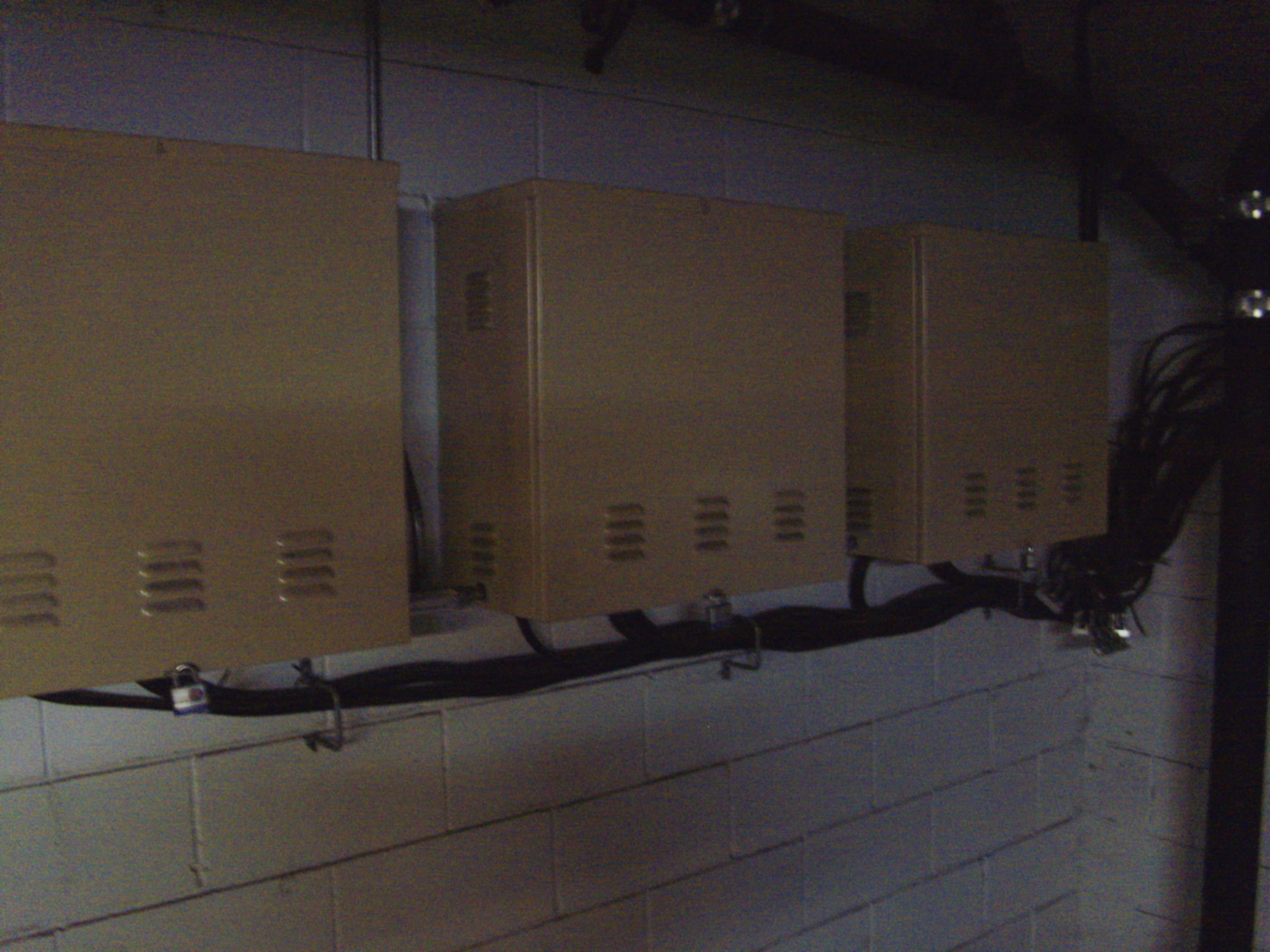

5 cables run right by the 3 locked boxes....where there are three MORE splitters there (see 2nd pic...bottom right corner)....the other 5 wires run down the garage and around the corner where the other cable drop box is....there are 3 locked boxes there too

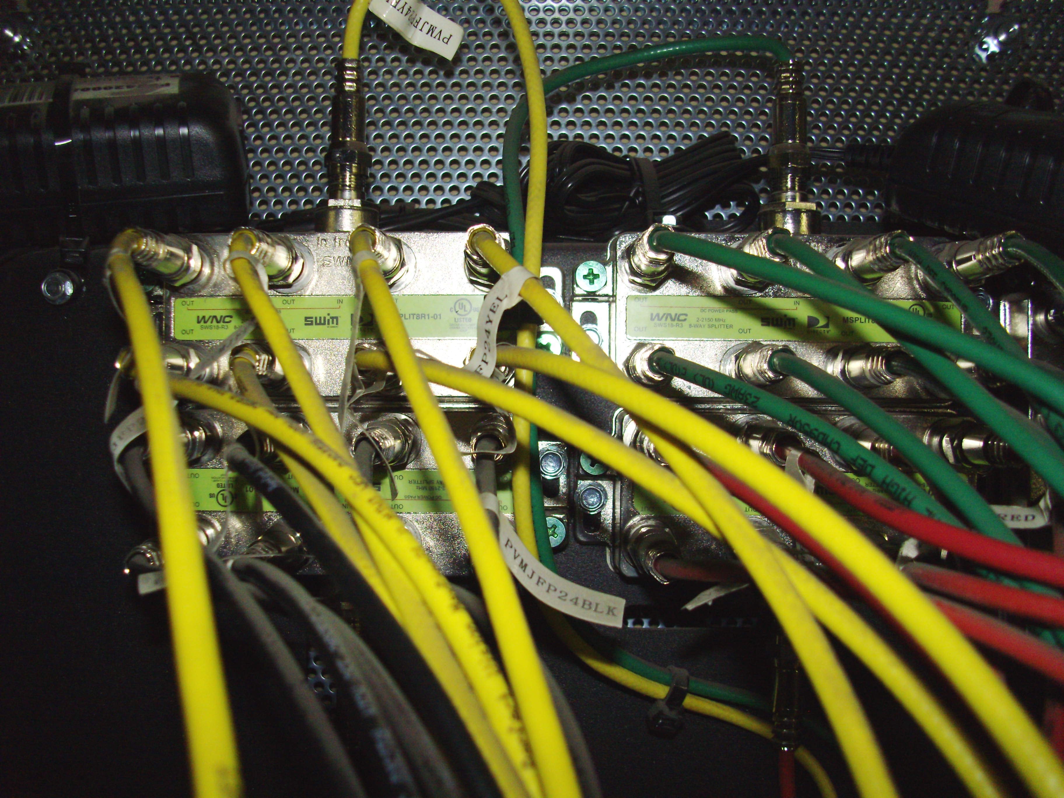

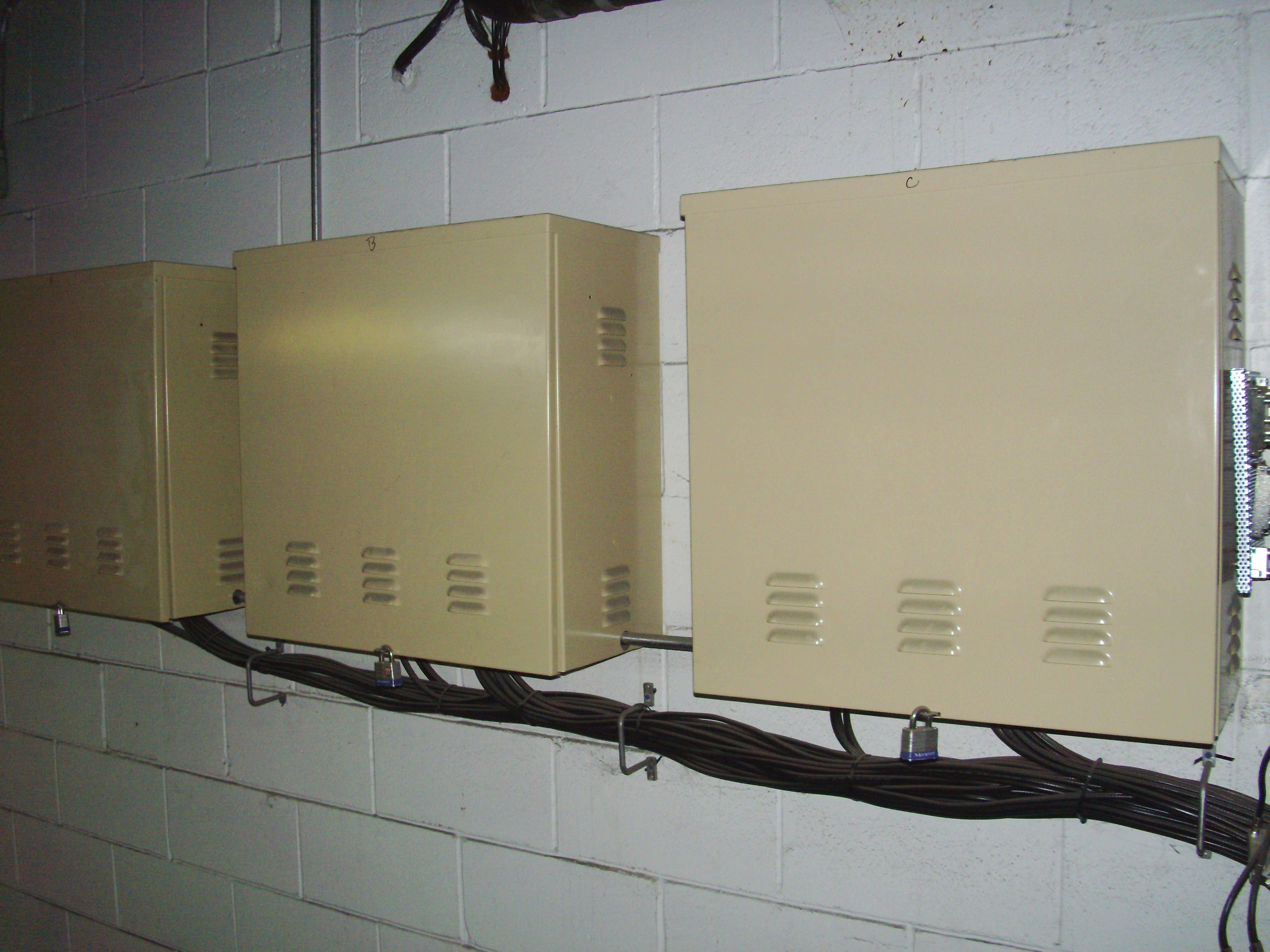

each splitter has 3 cables coming from that into each of the lock boxes (as seen in pic 3)

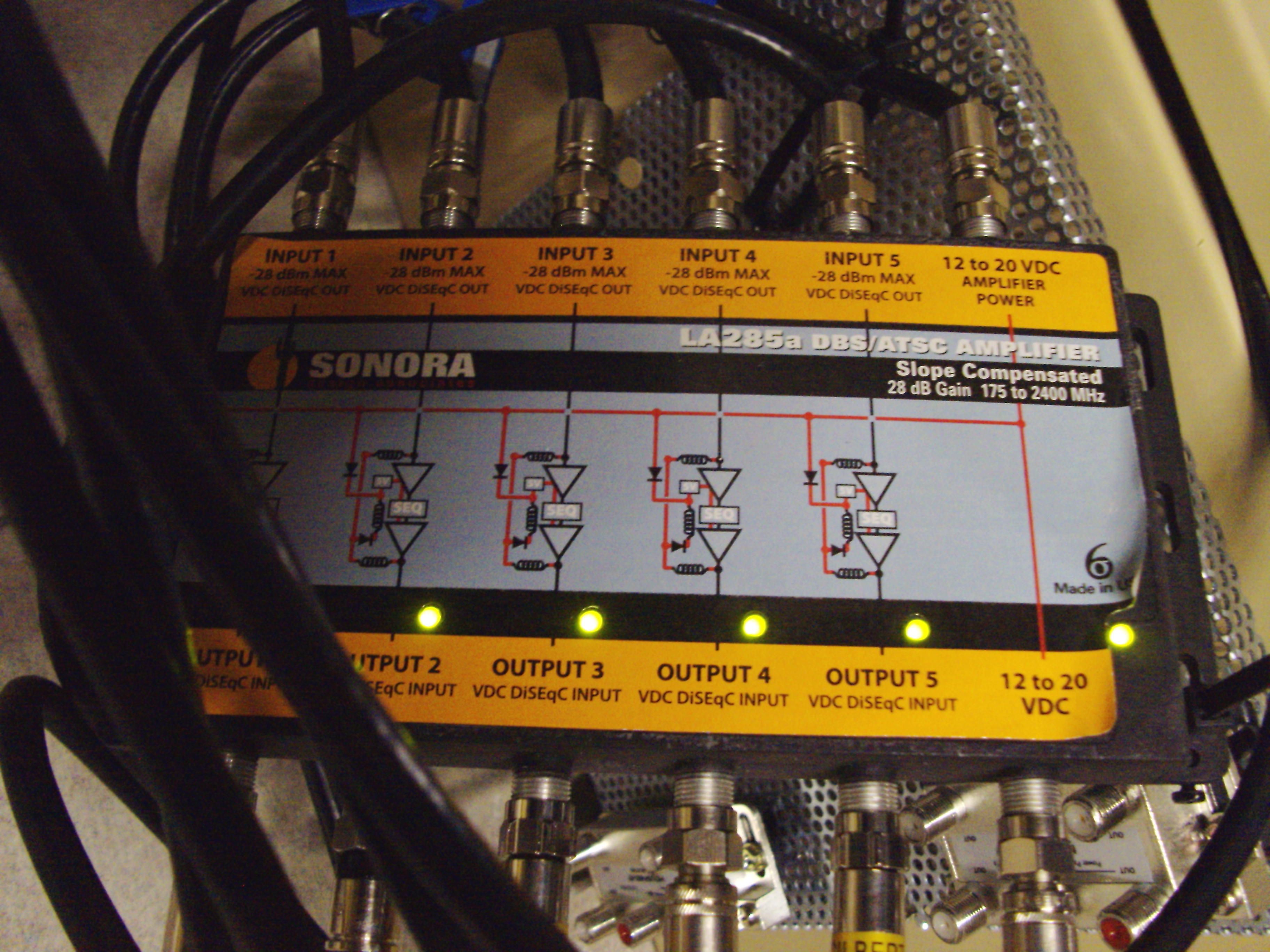

5 lines into the amplifier as posted above (post 57) and the cables then go into that little color box thingy

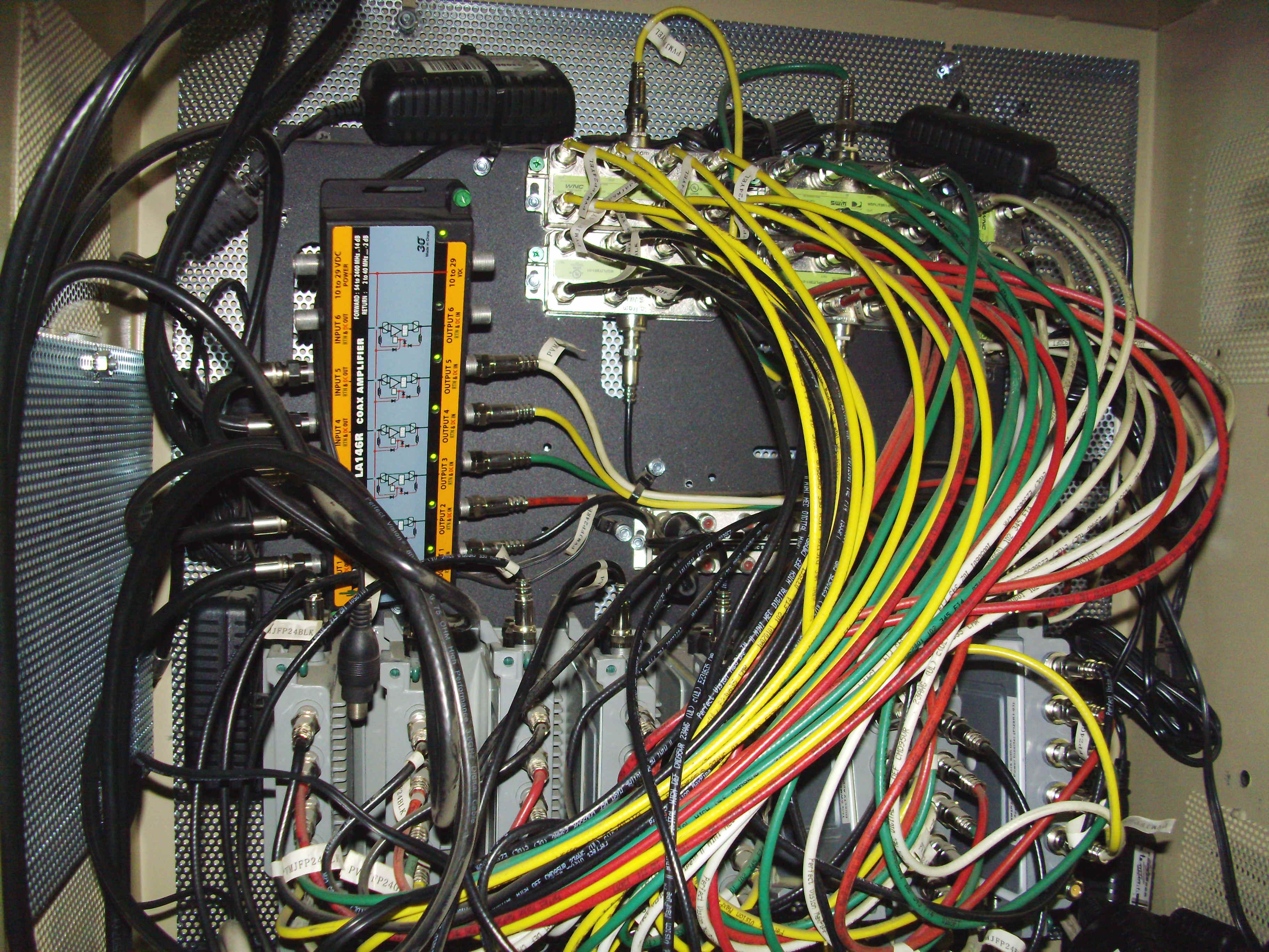

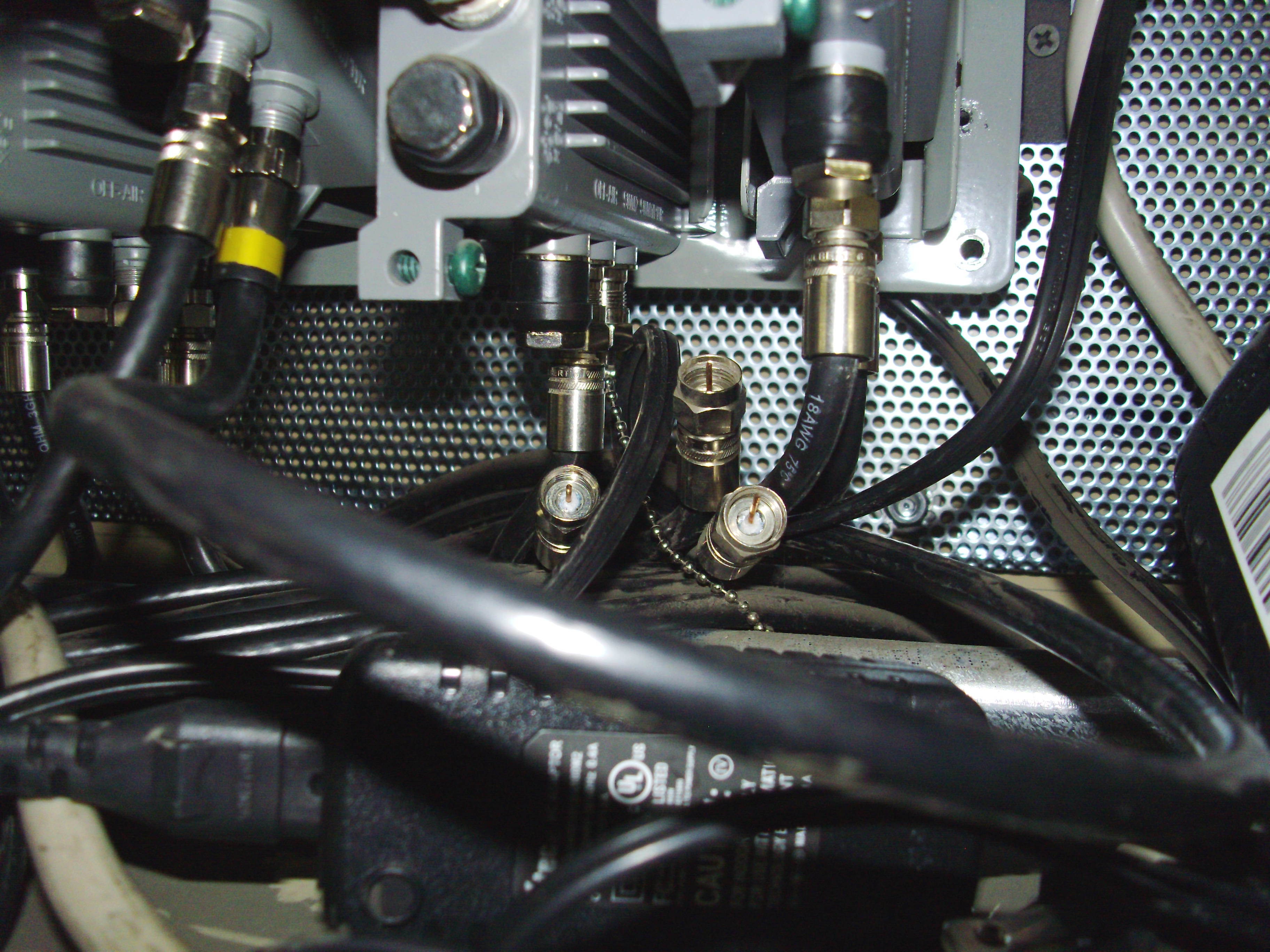

Those cables run to a cabinet right by those that was/is used for Comcast. Cable was free until last year when they switched. Each apartment has one outlet. It looks like a cluster (see 4th pic). There are 2 of these....the one here is mine which has (written on the front) 115-131, 215-231 and 315-331. The other box has 1-14 obviously.
They tap into that to go to the apartment
If you have more than one receiver they put a SWM splitter in the apartment
If you want cable internet and satellite they put a diplexer there (see bottom right corner of the picture....). I assume that is for HD. They use Holland STVC diplexers for folks with SD

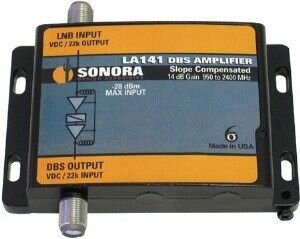

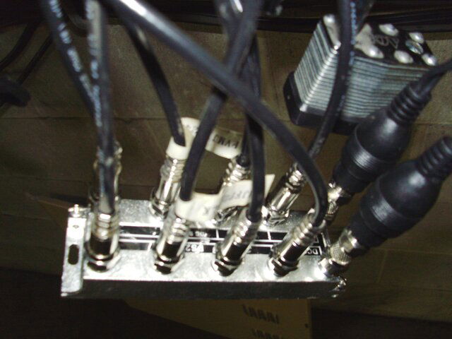

The guy put an amp on my line like in the last picture

I do know that amp on your line is passive, and the powered one works alot better.

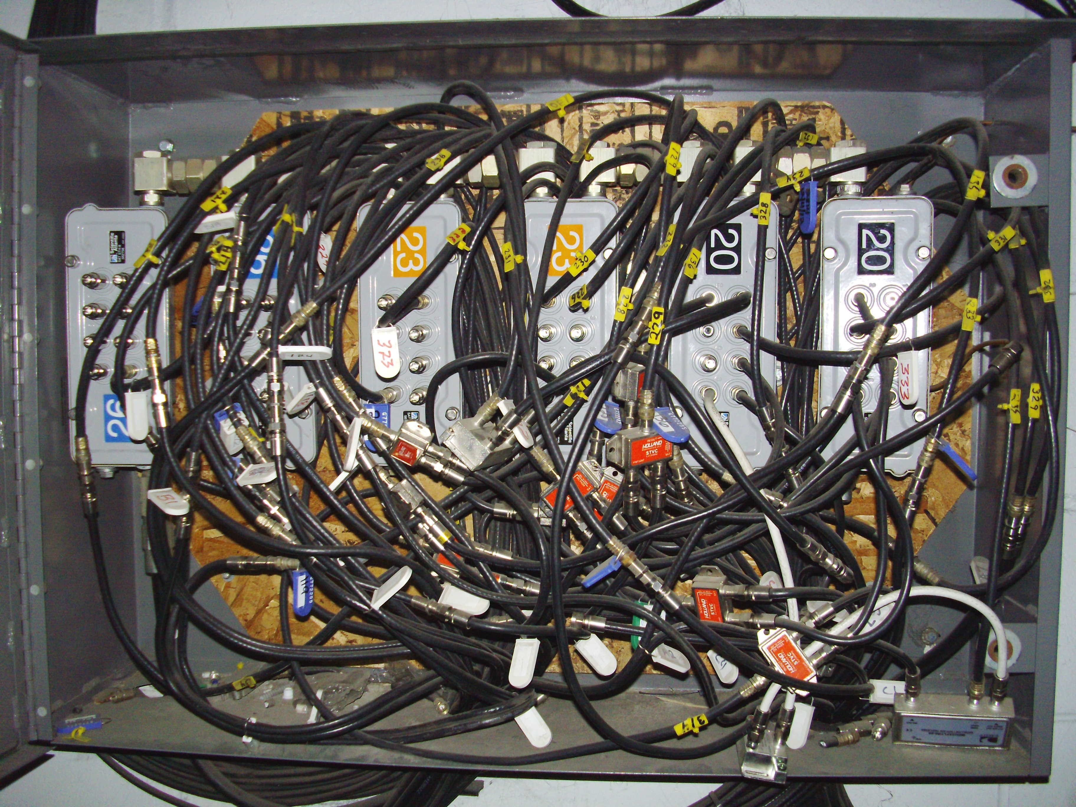

they switched from a 5 port amp (switch in 5th pic) to FIVE of the ones in the 6th pic.....seriously?
Then yesterday they put a new amp in but they dont have the power hooked up to it??

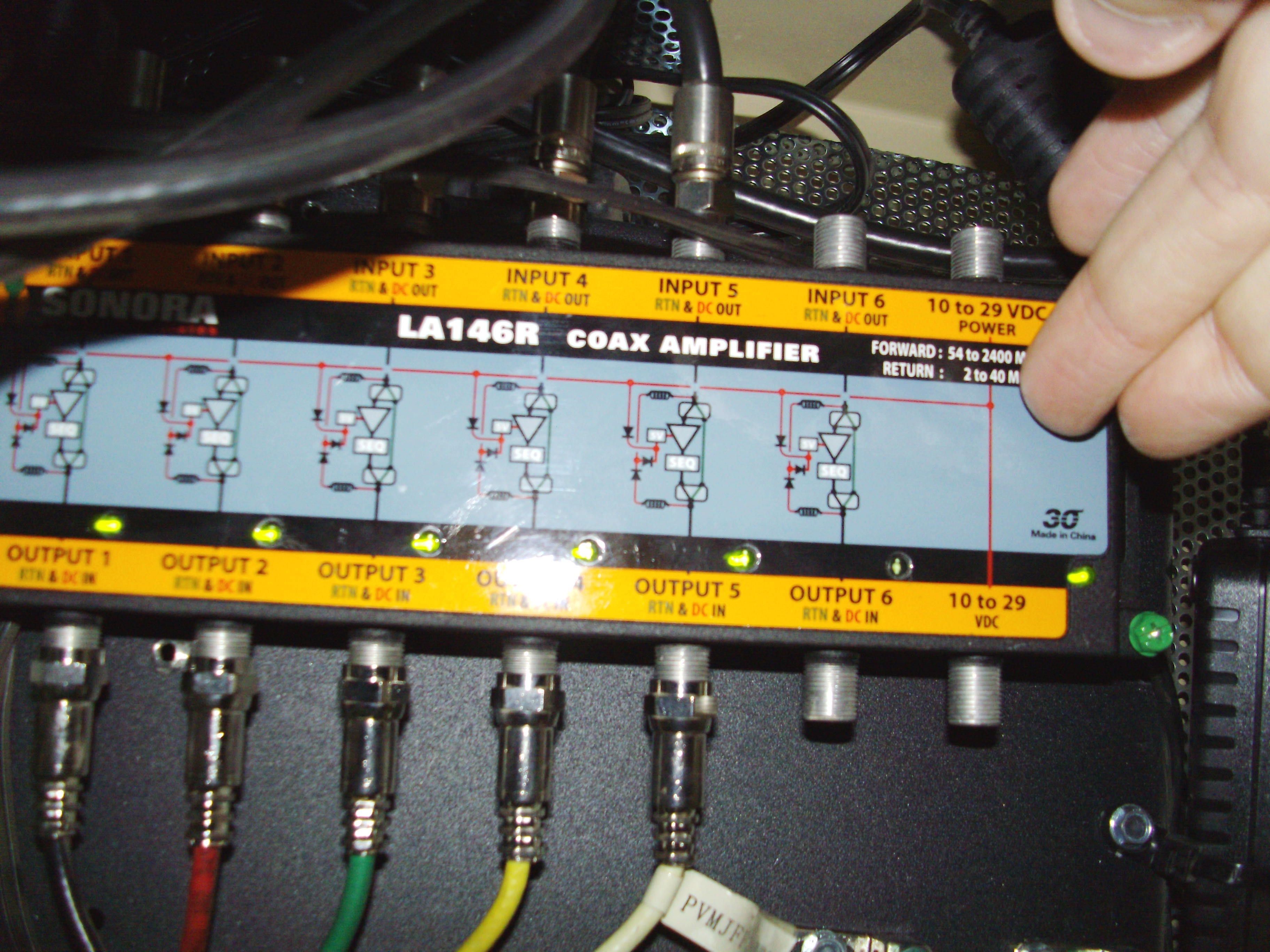

Well just an update...and more pics
So last week I'm watching TV and BOOM...searching for signal 771...dammit
0's on all evens on 99/101/103 so I'm pissed
storm downstairs into the garage and see the guy working on the main box....I say "oh so thats why I lost 1/2 my channels including all locals" (my locals are on 99s 16 and 101 TP20). Yup he noticed one of the legs on the amp is dropping signal power all the time.....goes from 95 to 60 back to 95 and so on. SO he's gonna switch the amp. Previously (post 64) I never saw what was in there....but now I did. There is a amp on the 5 lines from the roof...then ANOTHER amp right after it. (which was bad) then it goes to 5 splitters and then goes on to the other boxes as posted again in post 64
http://www.satelliteguys.us/threads...ing-back-quot-home-quot?p=3164865#post3164865
So he fixes that and then has to go to the other box to check it out there. Ok no biggie go upstairs and everything is fine. But next morning I get home and see one of the 3 locked boxes unlocked and the panel laying below it. So I HAD to go get my camera and take pics ;)
There are 6 of these cabinets and I assume these are all the same.
1st pic is a wide shot
2nd is the splitter used to power each of the SWM8's
3rd is a SWM8...there are 8 in the box
4th are the SWM splitters that go to the SWM8's...at least they have it color coordinated
5th is the amp....I dont get how its powered if there is nothing hooked to the power port
6th is a cleaner "wide angle view"
7th is below the SWM8...2 cables out...one to each apartment except for mine....the other cable has the end off and in the main box it says "GENIE"
so they are running a max of 96 apartments on this setup (48 SWM8's times 2 outputs per)
And you wonder why I have issues here with my setup??? ;)

If you look at the amp,the output is also DC in,so wherever the output is going the power is coming back from that.At least that's my story and I'm sticken to it! :D
