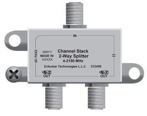

What exactly is the channel stack splitter 19 years I've done this and have never heard of that particular part
The Channel Stack Splitter is used for "mixed receiver" installations or even MDU type Wally installations using a DPH42. For example, with one DPH42 multi-switch using both outputs and the necessary number of Channel Stack Splitters, one can install up to 32 Wally's in an institution of some sort, for example, like a college dorm or hospital or motel, etc.
I am running two Wallys on an eastern arc hybrid dish using a channel stack splitter.
make sure to unplug both when you hook the splitter up and run the check installation on the one on port one then plug in the one on port 2 and run the check installation. Both have been working for about a month! Note the description says it is for a dp44 switch, it works without the switch. One line from port 1 to the dish port, 1 wally to each of the other 2 ports.

I know this thread is getting old but wanted to pass on that I have now tested a Western Arc Hybrid with a channel stack splitter and am able to put 2 Wallys on it. I know that on my portable antenna the Wally only shows 1 tuner but when attached to a regular dish they show 2 tuners.
