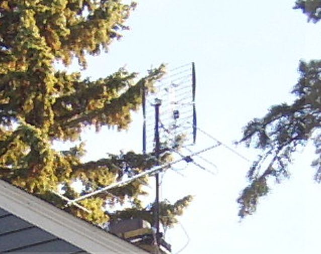

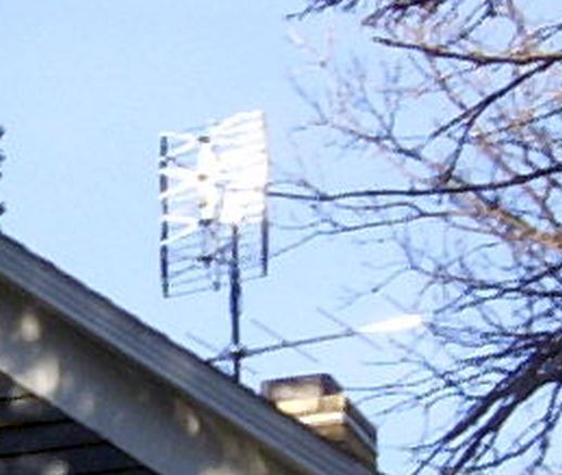

INSTALLED this past weekend. Balmy 35 degrees, and light winds, so did it!
10 is coming in at the mid to upper 70's (Slightly south of where antenna is aimed) and 8 (off the back slightly to the south) is also upper 70.
DB4 also replaces the yagi w/ corner reflector. The yagi must have some problem(s) as 4(RF38), normally only a few points weaker than 11, would totally disappear now and then while 11(RF44) would only drop to the mid 70's from a high of near 80. Both are within 1 degree at 55 miles.
The DB4 has both of these in the low 80's. Aimed due south, PBS 16.1-4 (16) & 2.1(15) is 30+ degrees to the east.
It is also receiving 15.1 (Rf 19), S.E. of Fargo, continuously since installation at a signal level in the lower 70"s, at a whopping 115 miles. Occasionally dropping down to the 40's and breaking up. No sign of 6 (Rf 21) N.E.of Fargo at a distance of 82 miles.
Both antennas individually run to a RCA TVPRAMP1R that's mounted to the electrical conduit at rear of house. Talk about grounded. YIKES.
