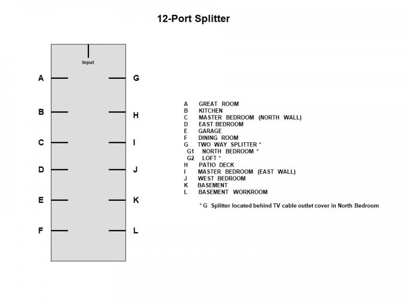

stardust3, my 12 port splitter goes to 13 TV locations. However, at the present time I only have 10 active TVs. With my RF modulators, each TV can watch either of my two Hopper 3s.
