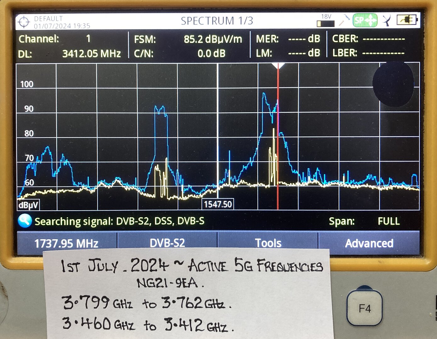

I'll try and keep this as short as possible - Here in the UK, 18 miles North of the City of Nottingham, we are also suffering from Cband reception problems from destructive 5G interference. I have at least three cell towers near to me that are 5G active, the nearest one is only 300 yds away and has a panel pointing directly at my 2.2mtr PF dish. There are two 5G segments in use now at the moment - the most troublesome one that impacts on my DX reception from 70° West PAL & Digital signals is the one operating between 3.762 to 3.799GHz. To combat this i was using an ALGA RED 3.82~4.2GHz filter into a Norsat 5150F lnb which helped some what but reception results were not as good as pre-5G days. The other day, after seeing some good reports coming in from other UK & EU hobbyists using the Titanium C138 5G lnbf i decided to give one a shot on my 2.2m PF looking at my performance reference go to sat at 70°West. I removed all my previous set-up ie: motorised Prodelin ribbed poloriser / AZ~EL / ALGA RED filter / Norsat 5150F and replaced with a tempory test lash up using a Tit C138 lnbf, no detailed fine tuning applied but the result was really really pleasing - reception performance from 70°W was just about equal from pre 5G days here at my UK qth. Well done Titanium.
