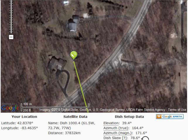

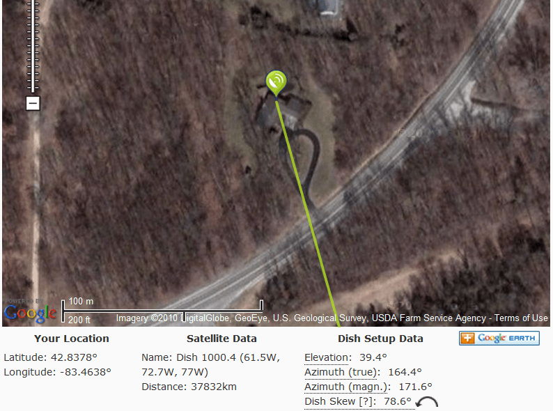

Okay, got the pics figured out. The first is the azimuth for the EA 1000.4 where it currently exists on the pole. The second is the azimuth for an EA 1000.4 where the existing 61.5 dish existed. I probably just muddied up the waters.

I'm starting to think it's maybe LOS. I've got some screen captures from Dishpointer I'd like to show here but I don't know how to do that at these forums. They're a birdseye view of course and it may not be the best way to get the full point across. I felt it needed to be on the roof and he didn't want to go up there. The post is nestled in trees and it's hard for me to tell whether it's blocked by them with the skew on the dish and all. I'm watching programming on 61.5 with no issues right now and it seems to me that if 61.5 is coming in well, 72.7 should also. The trees would block 61.5 far more than 72.7.
