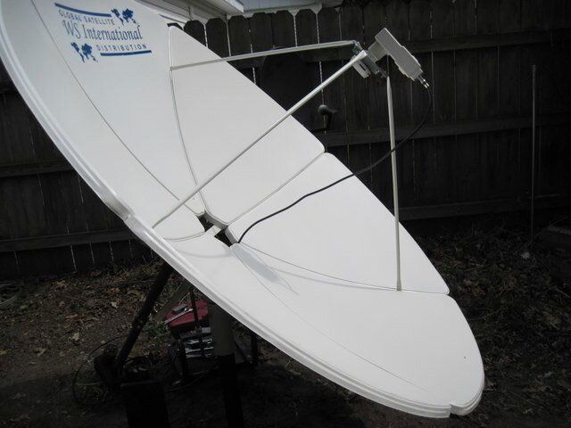

I'm thinking you probably have the support arms in the wrong place, which would screw up your focus.
But it could well be something else.
For instance, the LNBF needs to be IN the center of the dish, and pointed AT the center of the dish.
Dee posted some great pictures in her thread showing that she hadn't quite gotten to that point.
Of course, focus and skew need to be fine tuned, as well.
So, if you're not getting a good signal with the WSI/Galaxy 6' dish, and the SatelliteAV prime focus LNBF, someone... is doing something wrong. ;)
This is how/where the Supports are to be mounted.
The Blow-up Parts sheet that comes with the Bargain Dish is deceiving.

I remember Dee Ann from the Voom days here and @ AV Science. Read the “Finally” thread and appreciate the patience required for the 6’ dish. From the post above yes I did have the support arms in the correct place and I did  try both of the mounting hole options with the arms on the star ring. My experience was some of the signals came in fine and strong but the transponders I was interested in would not come in at all with any signal strength on the 6’ dish. The Primestar dish could lock on the transponders in question. Tried adjusting the focal length and skew but came up with the same results.
