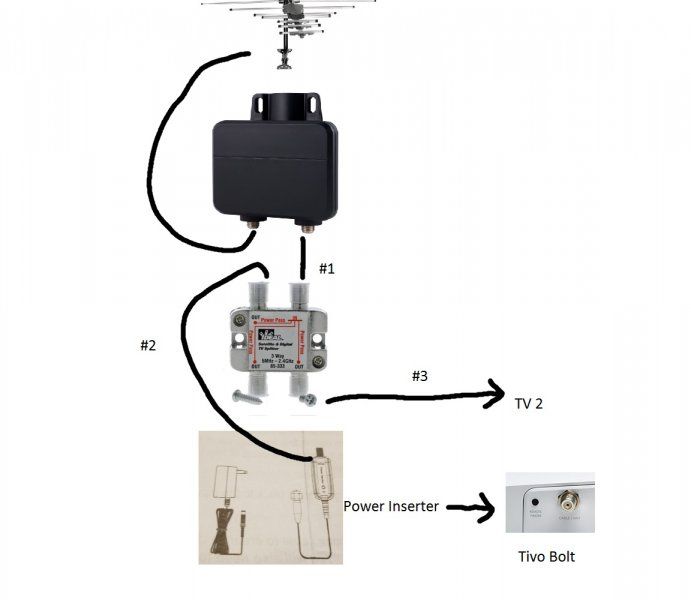

So not trying to flog a dead horse. And I know the graphic here is very simple:
Can I install a Power Pass Splitter? Coaxial #1 from Mast Amplifier to Power Pass IN on splitter. Coaxial #2 from OUT /Power Pass to Power Inserter. Power Inserter to Tivo Bolt/TV 1. Coaxial #3 from Power Pass OUT to TV 2.
Thanks again
Mark
The problem is probably either signal strength or a bad splitter.
Please post a TVFool.com report so we can assess the signal strengths you receive at your location.
A splitter is a simple device and most work about the same, expensive ones are not that much better than cheap ones.
The difference would only be noticed if your signal is near the digital cliff.
OTA now tops out at 692MHz and will soon collapse to 608MHz so chasing after a 2GHz splitter is not likely to bear any fruit.
I'd go with a splitter that only passes power through one leg rather than all legs.
