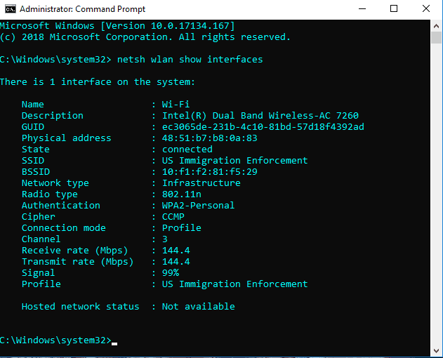

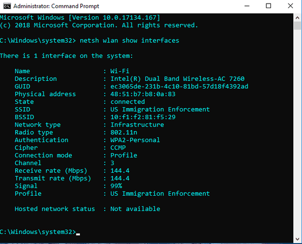

How far are you away from the router? The higher the frequency, the shorter the distance. 5 GHz will give you faster speeds, but will not penetrate as far as 2.4 GHz. What do you get when you run the cmd below?
