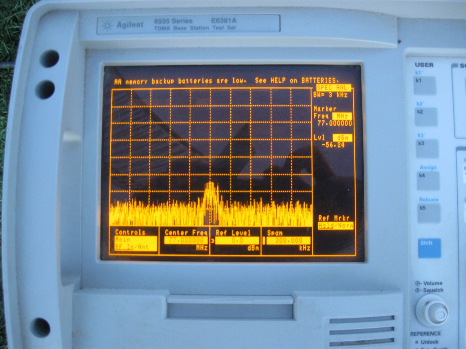

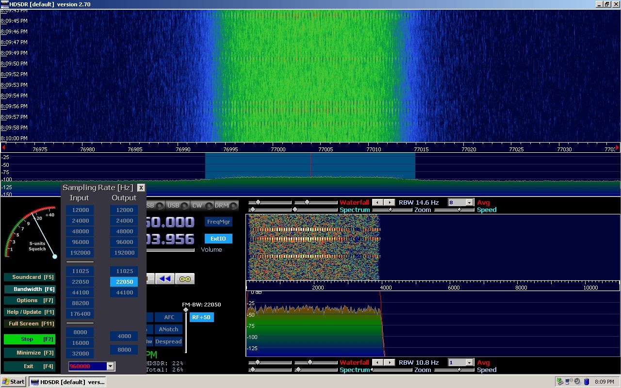

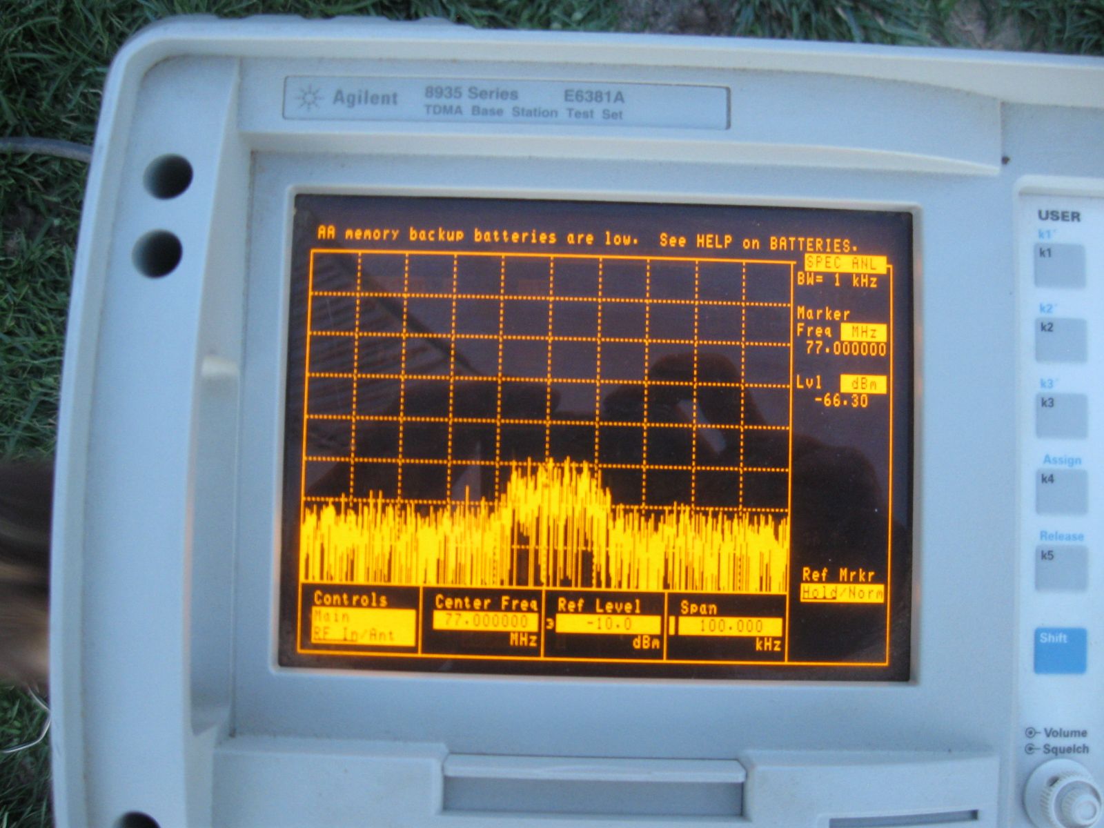

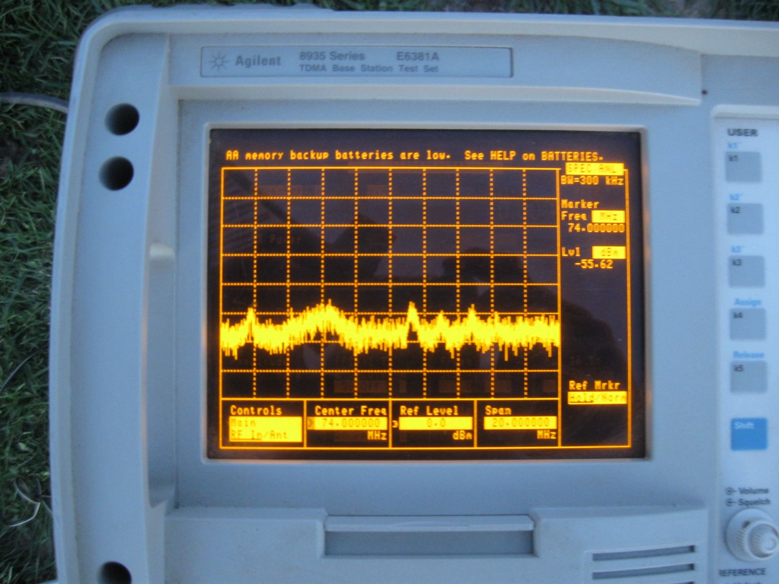

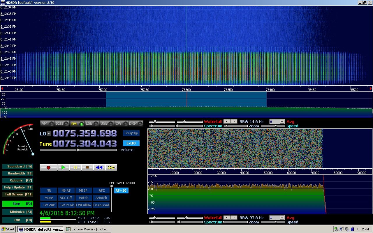

Just finished testing this and here are some pictures and results. Compare these to the 1.2M offset dish. The results are better then I expected. I will get info up on how I made this antenna in a couple of days. It cost (less the electronics) about $115. This antenna can be made by anybody that has some creative skills and patience.
I call it the IMProveD Grid antenna.
Spectrum analyzer views and HDSDR screen shots.
IPMD Grid Scope view.JPG IMPD Grid scope view 1.JPG IMPD Grid Scope GOES E.JPG HDSDR EMWIN Grid Ant.jpg HDSDR LRIT Grid Ant.jpg

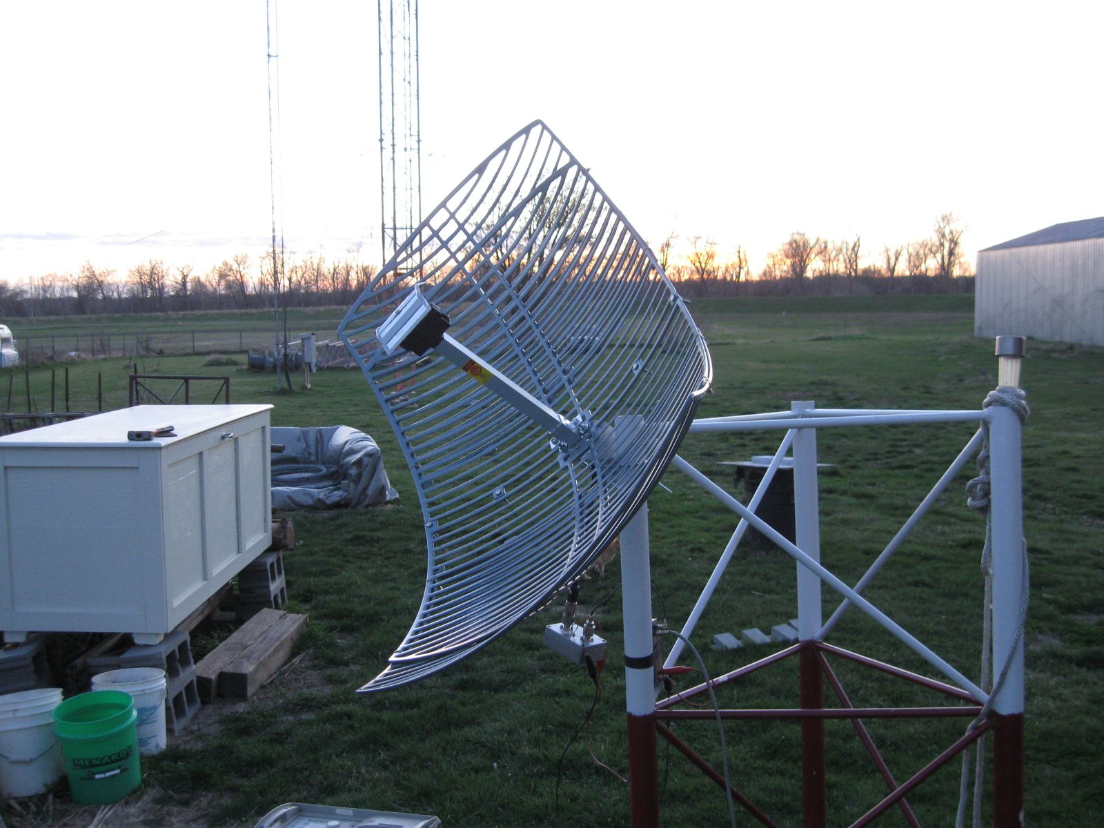

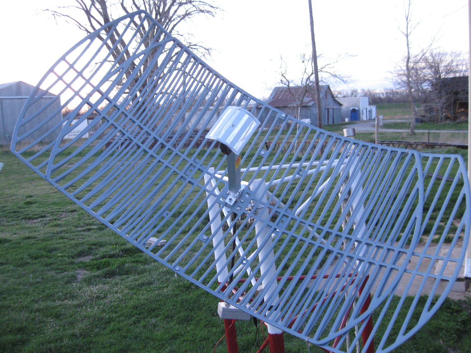

Some antenna views. Aimed at GOES East

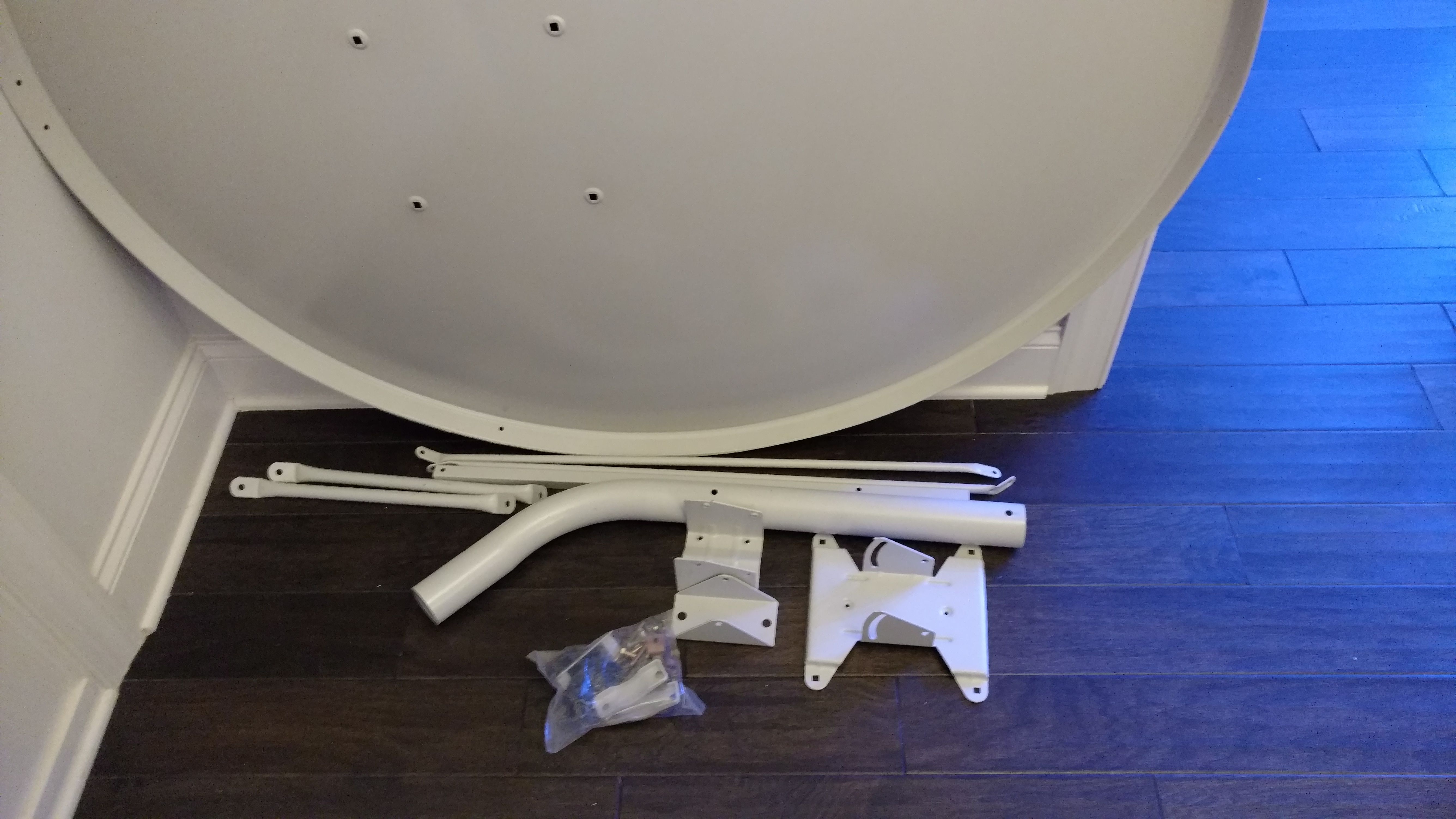

Unfortunately I got screwed on the dish via eBay. Attached is a photo of what I received. Definitely does not match the listing: www.ebay.com/itm/331627606646?_trksid=p2057872.m2749.l2649

Yep that's how I got mine Ti. A fellow ham saw it and asked if I wanted it, so after him hawing around I decided to get it. Some company several miles east of me was getting rid of it.
Got for free just had to haul away. The guy that saw it was so nice that he brought it to me.
doubleohwhatever did you contact the seller and tell him? is my first question.
It's not bad it will work but the focal lengths may be different then what I posted on here you will have the experiment with that depending what you do with it.
Ebay has a money back guarantee on that item if it isn't as described in the listing.
Reactions: Titanium
So, what's the difference about the dish? Is it just the mount? They sent you a j-pole mount and the pics show a ground mount. Contact the seller and tell them to send you a ground mount. Maybe they were out of stock on the ground mount? Otherwise file complaint as Goes 12 mentioned.
Yep. I haven't heard back yet.
Completely different dish.
Not that simple. The mounting holes in the dish that I received won't accommodate the ground mount shown in the auction photos. They sent a completely different kit.
I can most likely make this dish work if they're willing to issue a partial refund or something. Otherwise this dish needs to go back.

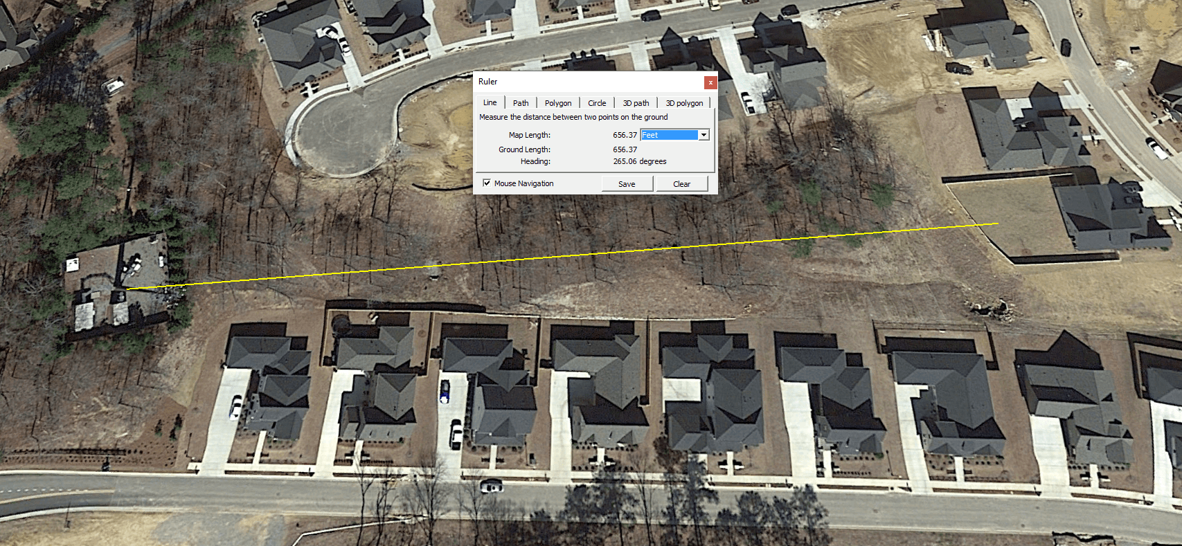

By the way, I've discovered the source of my noise. I followed the instructions in the post above and found the direction the noise was coming from and then was dumbfounded when I looked at google earth. There's a well camouflaged cell site directly to my west. I've honestly never noticed it before. It looks very obvious in the photo I attached. However, from the ground it's really hard to see.
Jeez, if that things starts transmitting on 1695, I won't be able to receive antyhing.

doubleohwhatever,
Well you found the noise source. With a transmitter that close I can understand where you would be getting a higher noise floor and some of the harmonics. Ok doubleohwhatever now this is where you have to get creative.
When you were walking through and around by any chance did you find a quieter place in your yard that would work better for a receive location?
Is your siding on your house metal, or anything metallic?

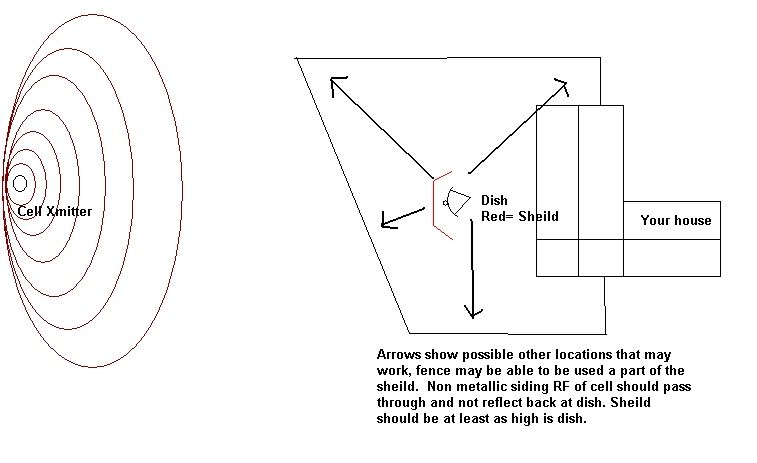

Since you know where the noise is coming from you will have to try to shield the antenna from it. See the diagram.
You can use screen, a metal shed, anything that blocks the RF from that cell tower affecting your dish. This unfortunately makes it look more unpleasent, though I notice you have a fence around your yard so the only ones seeing it will be who lives there.
