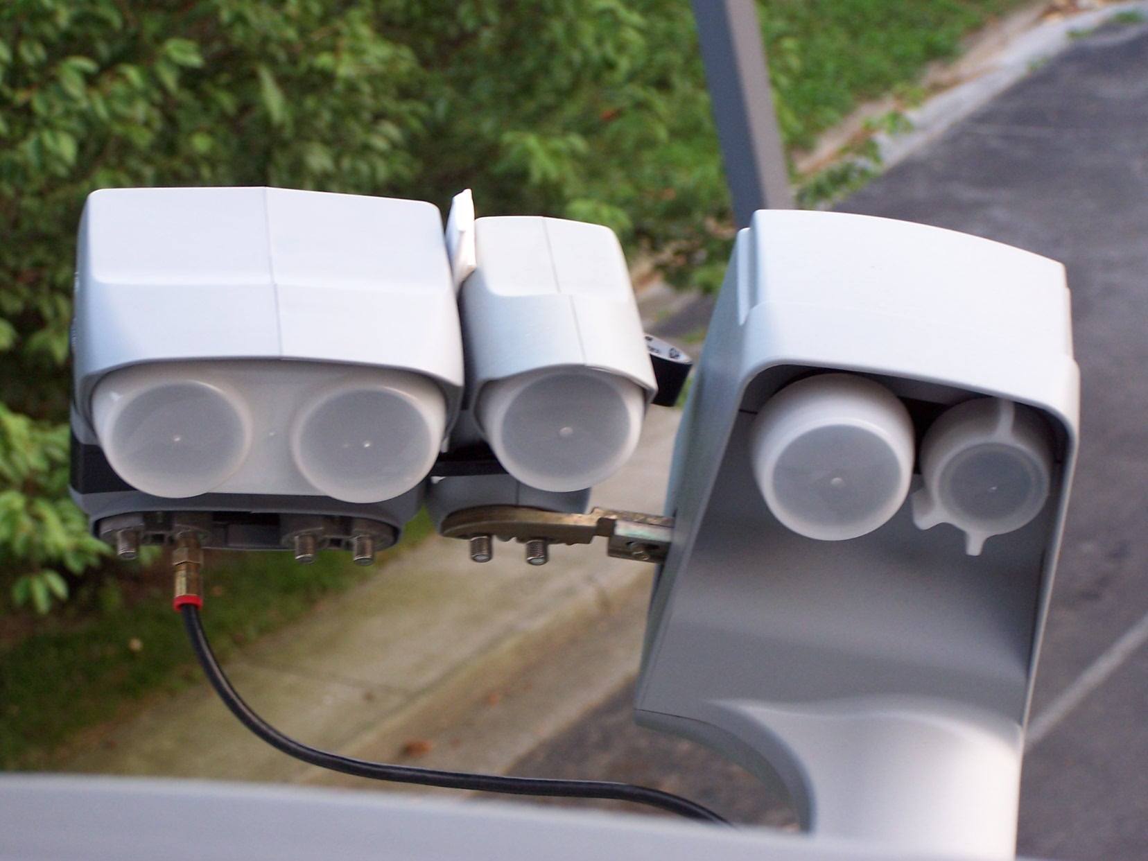

I decided to leave 121 off as I really have no need for the international channels. Signal levels are a little low and I do!!!!!!! need to slightly adjust my dish. No New channels as of yet. Here are the pictures. They are self explanitory. Allthough 129 Bounces off the center of the super dish.. A little more left than expected. I am going to peak with a sat buddy later on tonight and I will post those findings here as i suspect that i need to point my super a little higher by a inch or two. I lifed up on the super and the signal went up. I couldnt part with 61.5 yet. VOOM! I had to put a pice of candy stick (way to improvise on me) to bring the lnbf poing closer to the center to peak it out at its focal point. so here you all go And enjoy this Satellite guys Exclusive!! This was taken with a 942!

Edit 704pm and I have repointed the super... 100+ on all dbs slots including 129!!!!!
I sure hope that lollipop stick doesnt get loose and cause all kind of alignment havoc ;)
That's probably not as bad as my Dual LNB I have attached to a D* ARM with electrical tape. I'm surprised it's still hanging on there... lol
I guess this shows that a Superdish could be used to get 110, 119, 129 and 118.7 and/or 121. That's a lot of bandwidth with a single dish. I don't think a Superdish could get these 3 DBS slots and 105 since I believe the Ku-FSS slot needs to be near the middle of the Superdish but maybe its worth a try. Perhaps that will be another Mad Scientist experiment. Thanks goaliebob99.

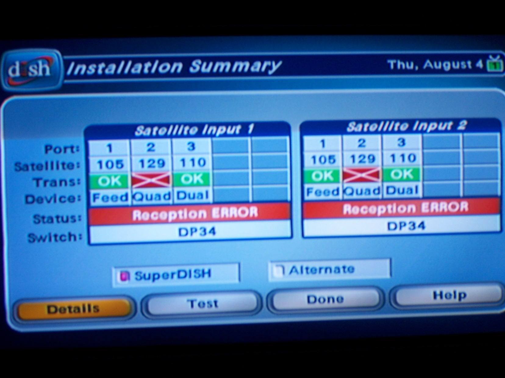

I've got 105 and 129 both coming in on a 105 sup dish......only 129 not quiet good enough yet but at least it recognizes 129 in the switch matrix. But I believe it can be done. Only lnb i had laying around was a quad so i straped it to the side of 119. I thought that the spacing was right for the 119 side of the quad, but the only side i'm having any luck with is the 110. I'll try again with a dual later plus i'm out of electrical tape :no

Scott, you should be able to get it on the 942.
that's what goaliebob used...
