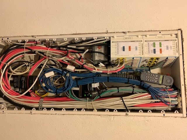

1. Take a look at my distribution node: I cringe ever time I have to go in it. Its responsible for all Satellite, Video distribution, Networking, phone, voip, security system and more. Every time anything is touched something else breaks.
2. The security camera system signal is piggybacked into the video distribution allowing all TV's to be able to view the security camera. On the RF output of the 922 into the amplifier the security camera's are available by simply switching to channel 3, the Satellite is channel 60.
3. Bypassing the Amp/Distribution in order to hook the Hopper to the Joey would cause loss of the security system in the other rooms.
4. TV's are flat screen in those rooms and mounted directly to the wall using low profile mounts, there is no space for the Joey and I won't have a Joey dangling below the TV.
5. Why should I pay close to $30. a month more to get nothing more then I already have (minus the added record slots of the Hopper), not only that I no longer own the equipment and are tied into a contract and rental agreement. Again, Why?
Hopefully this explains why I don't wish to re-invent the wheel that was working just fine. As far as Dish supporting equipment forever I understand that they can't however as long as the equipment is in working condition and costs them nothing why not, its in their best interest and better for their bottom line as well as the customer. Sending out a tech to upgrade me to a Hopper and Joey's would cost them at least hundreds of dollars. Again Why?

Yea, that's definitely a mess. But someone that knows what they are doing can still get your security system and Joey's working over the same coax. Is it approved, definitely not. But will it work without issues, most likely yes. And Joey3s are maybe 1/4" thick and will fit behind just about any mounted TV.
Technically the Joey's will run off of ethernet too. Again not approved and if you are going to do it should be the only thing on the network switch but I've seen people run it over the same network as their internet without issue.
