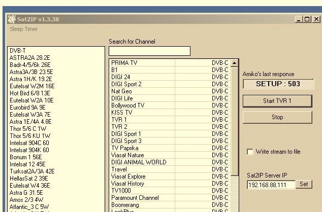

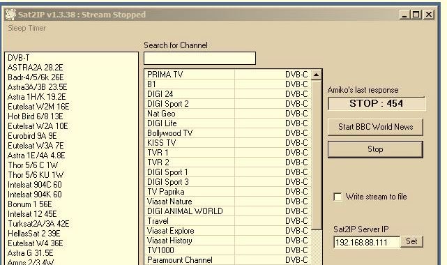

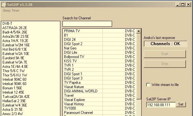

1-When i start Sat2IP.JPG 2-When i start the channel.JPG 3-When i STOP the channel.JPG
What could be the problem?
I have an Amiko Mini Combo Extra and i don't know what happens . I started the server "Big2small" and it says the server started ok. When i start Sat2IP and insert the ip of Amiko, it's saying "Channels : OK" and it is showing the DVB-C channels i have on it (i use it as a cable receiver). When i select a channel and hit "Start", SMPlayer isn't starting and Sat2IP it's giving me error "SETUP: 503" at section "Amiko's last response". After I hit Stop, Sat2IP says on title bar "Stream Stopped" and at the section "Amiko's last response" it says "STOP: 454". How can i solve this situation? As OS I installed "AMIKO_Mini_Combo_Extra_RCA_1.3.63_emu". I tryed also "AMIKO_Mini_Combo_Extra_RCA_1.3.15_emu" and "AMIKO_Mini_Combo_Extra_RCA_1.1.67_emu". Older firmwares do not have the "Big2small server" option.
Thanks in advance for your answer.
Hey there, i got your PM too, but ill respond here. As for the SMplayer not starting, make sure you let it install in the default location. Also, i would suggest installing the version of SMplayer that was specified at the beginning of this thread. Make sure you you get the SMplayer stuff working first. As for the errors returned, it might have to do with that its not detecting any software trying to initiate the stream.. Thats why i suggest getting SMPlayer working.
Also, even though i wrote the program, i have not used it in well over a year. I no longer use my Amiko STB. I wouldn't think amiko would change anything on the Big2small server, but then again, their might be subtle differences that might make it no longer work. There might be other users here that can chime in.
I can tell you when i originally programmed it, i ran a TCP sniffer program that i installed on the android so that i could watch exactly what the Android program was sending to the Amiko and what response were getting returned. I was then able to replicate that to make it work in this windows program. If the Big2Small android app still works and it hasn't been updated in years, then this program should work too.
Thanks for your answer. It's frustrating now that I'm trying to solve this since 5 days, now. The Android up is having the same issue. It's showing the chanels but it's not playing them saying that there is a server problem. Regarding SMPlayer, when i click the link you suggested, it is pointing me to the newest version of the program. So, what was the version of SMPlayer you were reffering when you started this thread? I already have it installed the wewest version of SMPlayer and it's not working. After, i uninstalled it and installed an older version, and still no result.
Thanks again for your patience.
Well, if its doing the same thing on the android app, that doesn't encourage me at all. You might be out of luck, there might be some issue with that Amiko firmware. As for the smplayer, you should be able to do a google search for VERSION listed on the first few posts.. The smplayer usually has a site where you can download older versions.
I believe I remember KE4EST saying at one point that Amiko was phasing out Big2Small and that they were no longer supporting it, but I could be mistaken on that.

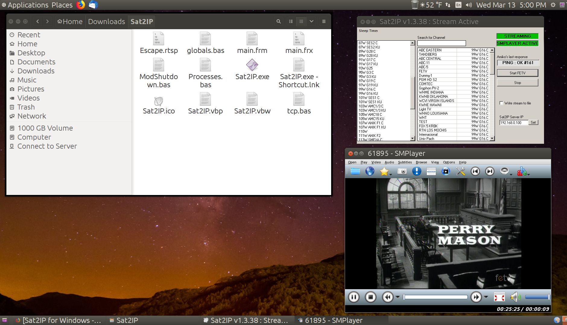

Just FYI, I just tried and have this working on Ubuntu 16.04 LTS using WINE v4.0. I did not do anything special - just downloaded SAT2IP v1.3.38 and extracted it. Downloaded current SMPlayer (Version: 19.1.0 (revision 9191) (32-bit)), installed it using WINE and added the parameters (-demuxer +lavf -nocorrect-pts -mc 1) mentioned in the first post in this thread. Ran SAT2IP with WINE and entered the IP of my Amiko Mini HD SE. Receiver was found and the satellite/channel list populated. Selected a channel and it worked right off the bat. Pretty sure I recall this not working directly under Linux before unless I ran Windows in a Virtualbox. Attached is a screen capture (thumbnailed). :)

P.S. I found that if I resize SMPlayer or switch it to full screen during playback the window will resize but the video stays at the previous size. Stopping the stream playback (using SMPlayer stop button) and restarting it then sizes the video correctly. If you set your window size before starting a stream the video displays correctly. Not a big deal but wanted to mention it. :)
