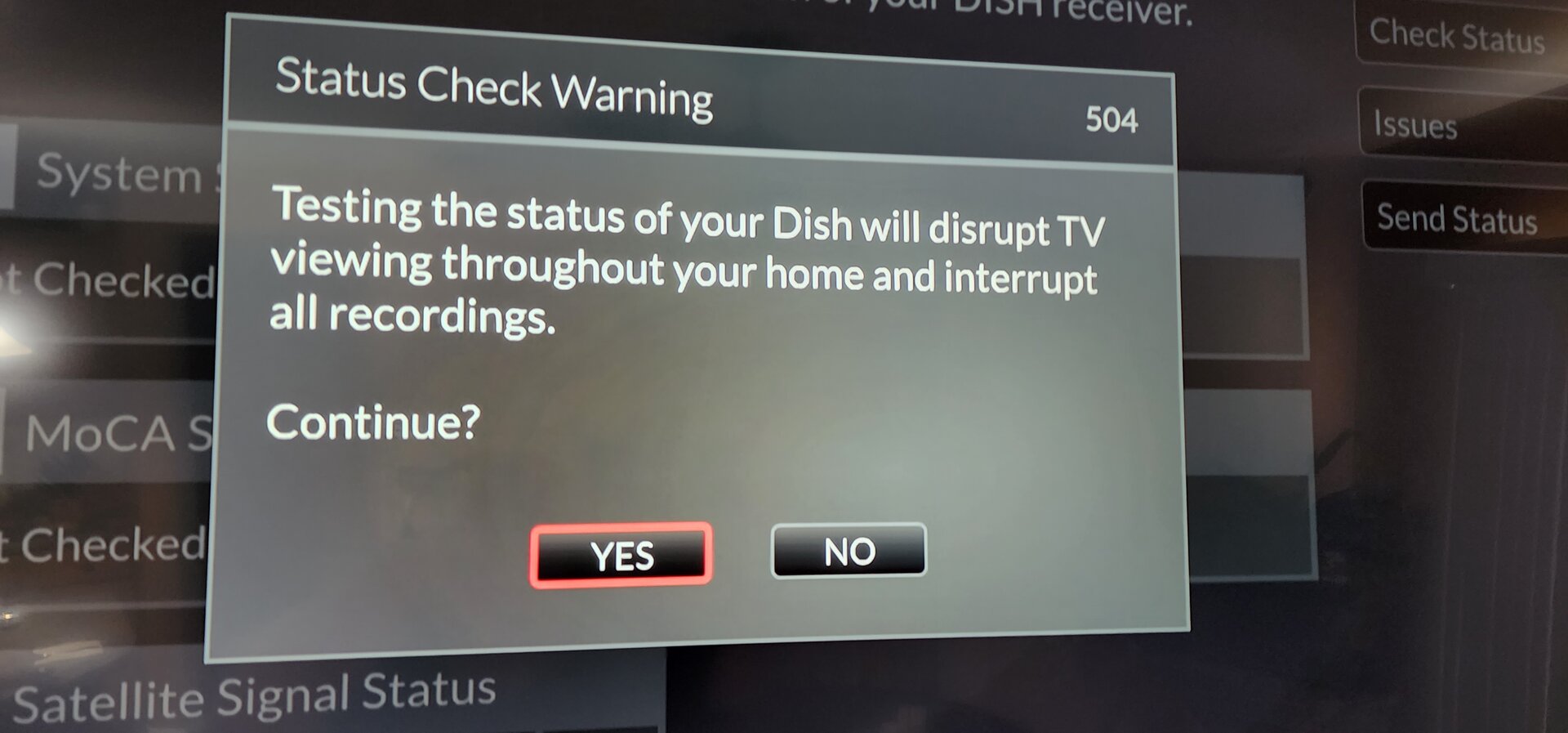

HipKat yep for sure. Even though selecting yes in the Status Check Warning pop-up window, PTAT recordings will not stop recording and the Check Status will stall out at 60%. Also if you change PTAT setting to off during PTAT hours it does not take effect until after PTAT time zone is complete.
