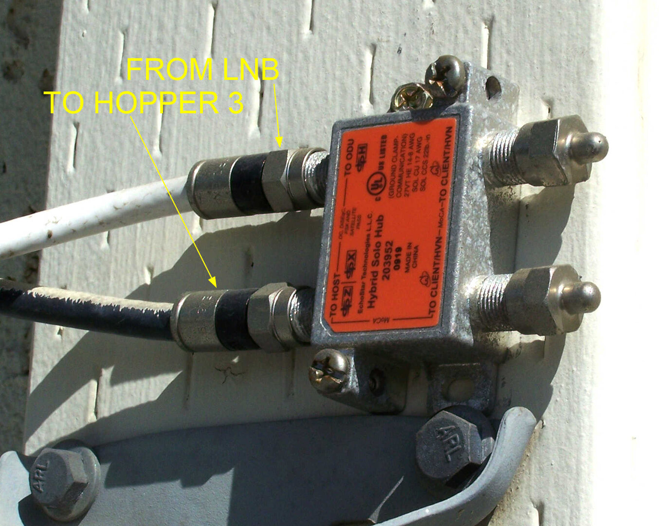

Here's a question: What is this thing? We didn't have it with our old receiver, but evidently it was installed when the Hopper 3 was installed. Is it connected properly? I haven't undone the F connectors yet to check for corrosion, thought I'd ask about this first. Our old installation had the LNB hooked directly to the receiver... a VIP-something.
That is a component used in a Hopper system. The way yours is used, it doesn't really need to be there although Dish says it will prevent moca from traveling back to the Dish. Which BTW, region has no bearing on dish size. Other than international dishes and special circumstances, everybody's using the same dish. The "eye" on the dish, or the LNBF may vary depending on region, determined by pointing to the southwest or the southeast. And that depends on which market you're in and where you're high definition locals are.

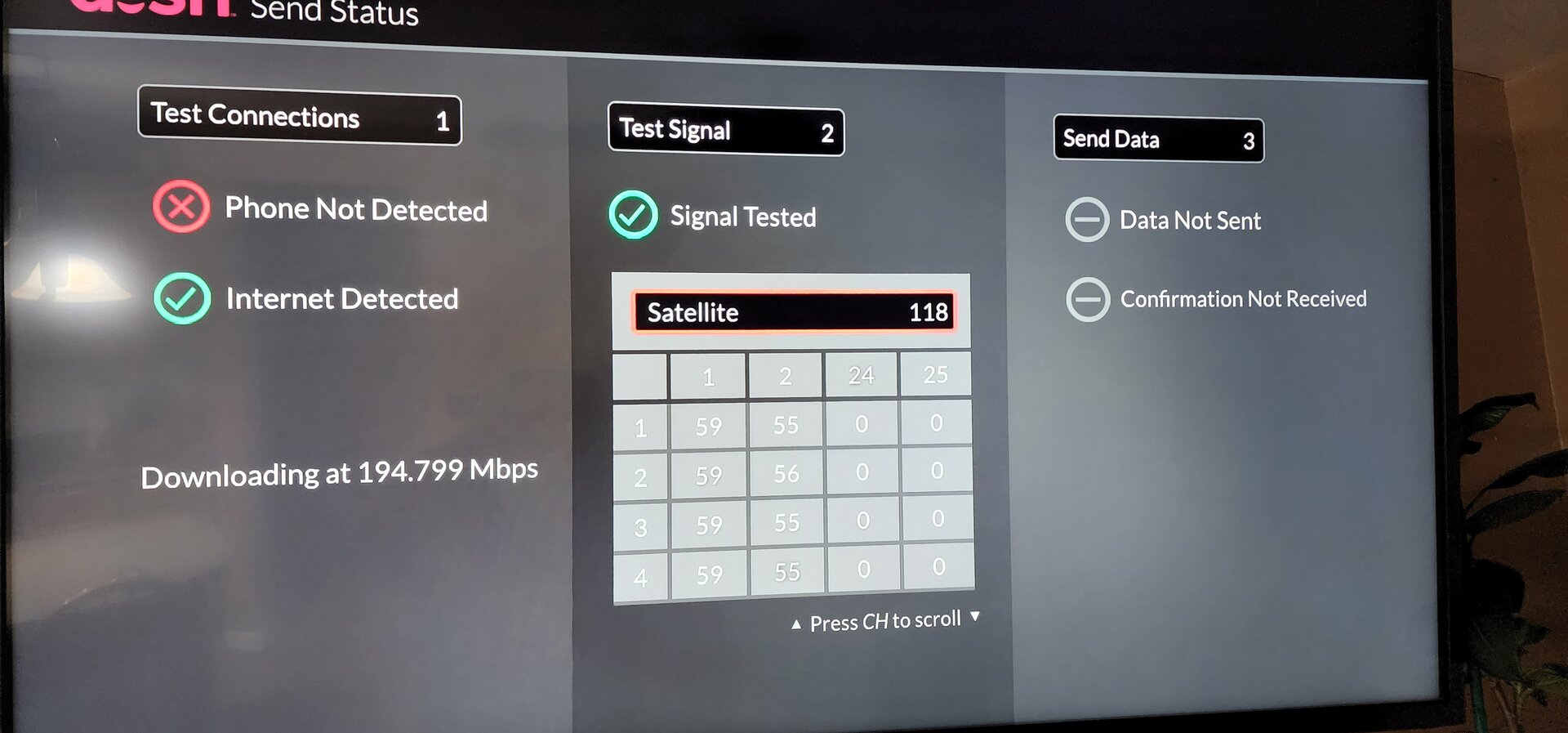

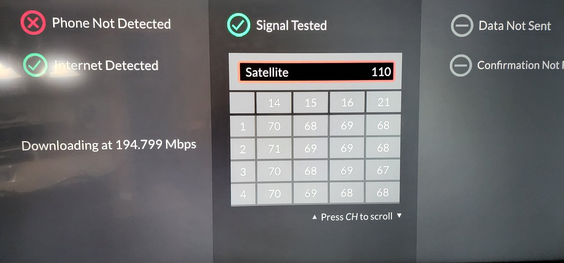

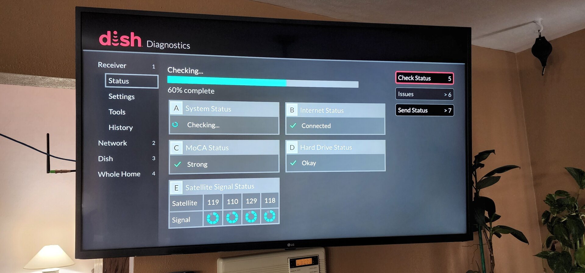

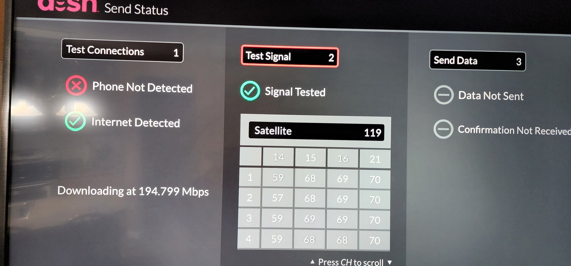

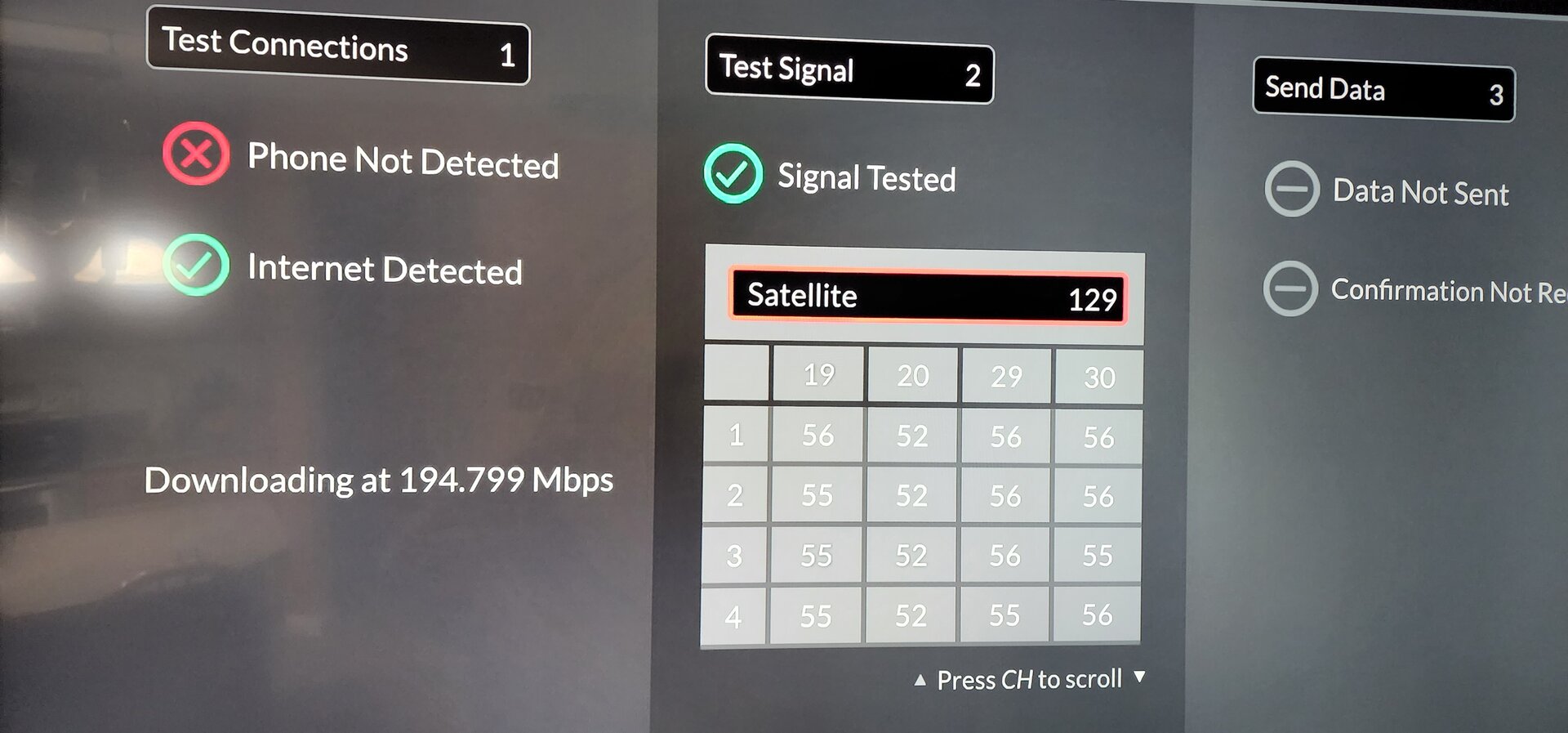

HipKat, finally got the Check Status to work. How does these signal strength readings look to you for my Hopper 3? I didn't see xponder 23 for 129. My other Hopper 3 is busy recording. Will check it tomorrow. Thanks.
They look good, actually. 119 is a bit low, but these Hybrid Slimline LNB's just do read lower than the older DPP and DPP Style Hybrids did for some reason. I'm sure the other installers on here would agree.
On a DPP Western Arc, I'd see readings closer to the high 70's for 119, closer to 80 for the 110 and close to 60 for the 129. It's refreshing the rare times I get to (re)point a DPP LNBF. The fact it took so long to run the Check Status is concerning though. That LNB may have some issues or a component, connector, etc in the cabling could be failing.
